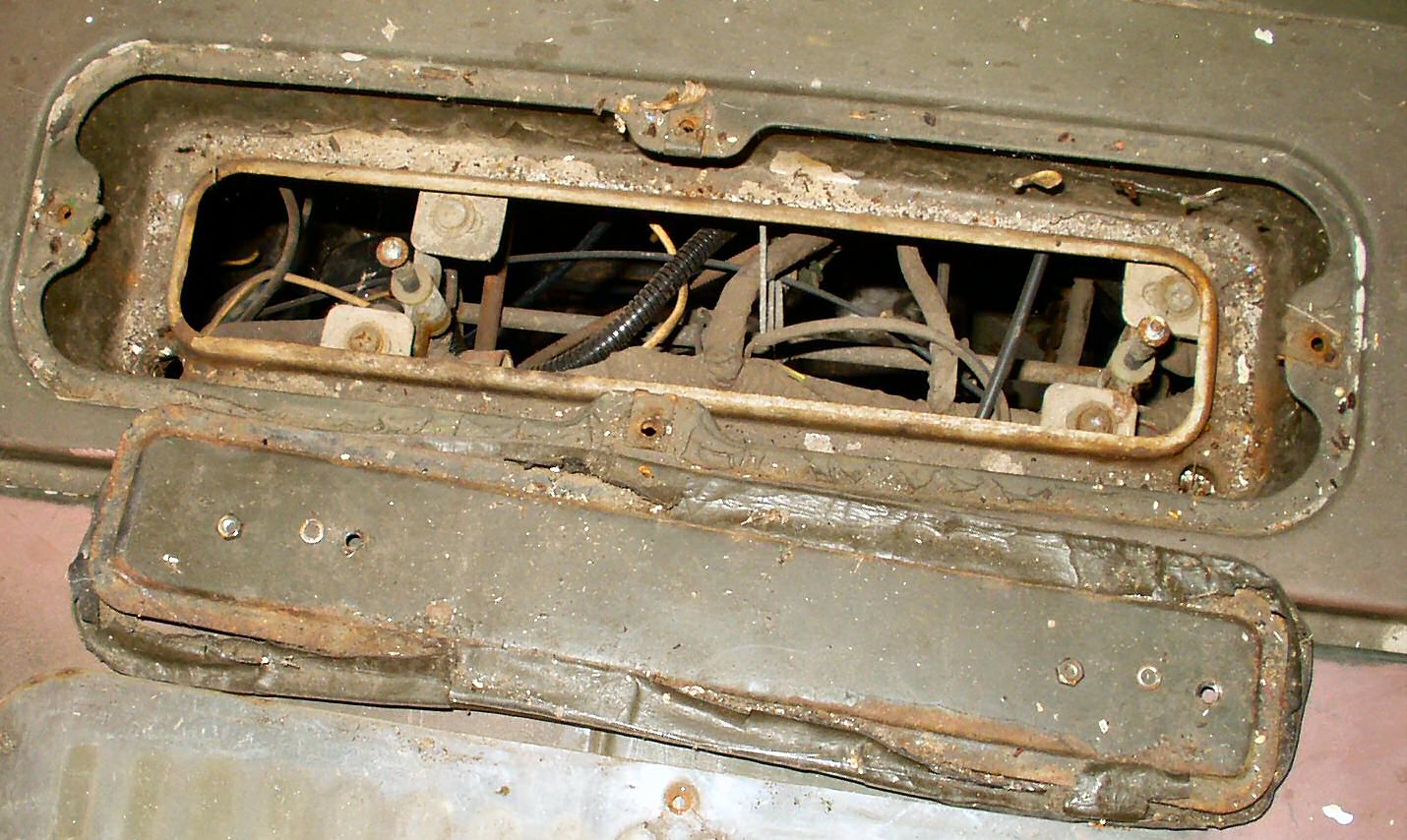

The blue side is top (facing upward) and the black side is facing down. Gasket on the top side is even with the blue surface, so it won't trap water. Gasket on the bottom side protrudes downward so that it can seal against the rectangular opening beneath it. Here's what that opening looks like (courtesy of Coolerman):
Seems like to me even though the middle section is raised, there will always be a little gap between the gasket and the beveled section of the raised middle. If the full side of rubber was facing up, any water on top would spill to the sides and there is no little gap. Maybe I'm just not understanding this thing. Good thing mine is not operable lol:
oh wait now that i'm seeing it on a computer vs. my phone i get it now. disregard (although i still think a little water would be caught in that tiny gap)
In practice I doubt it'll be an issue. If you look throughout your car, you can find plenty of little gaps where water can potentially hide after a rain shower or car wash (e.g. door gaps, hood gap). It'll evaporate pretty quickly. I think Mr. Toyoda must have thought about that when he originally designed it.
