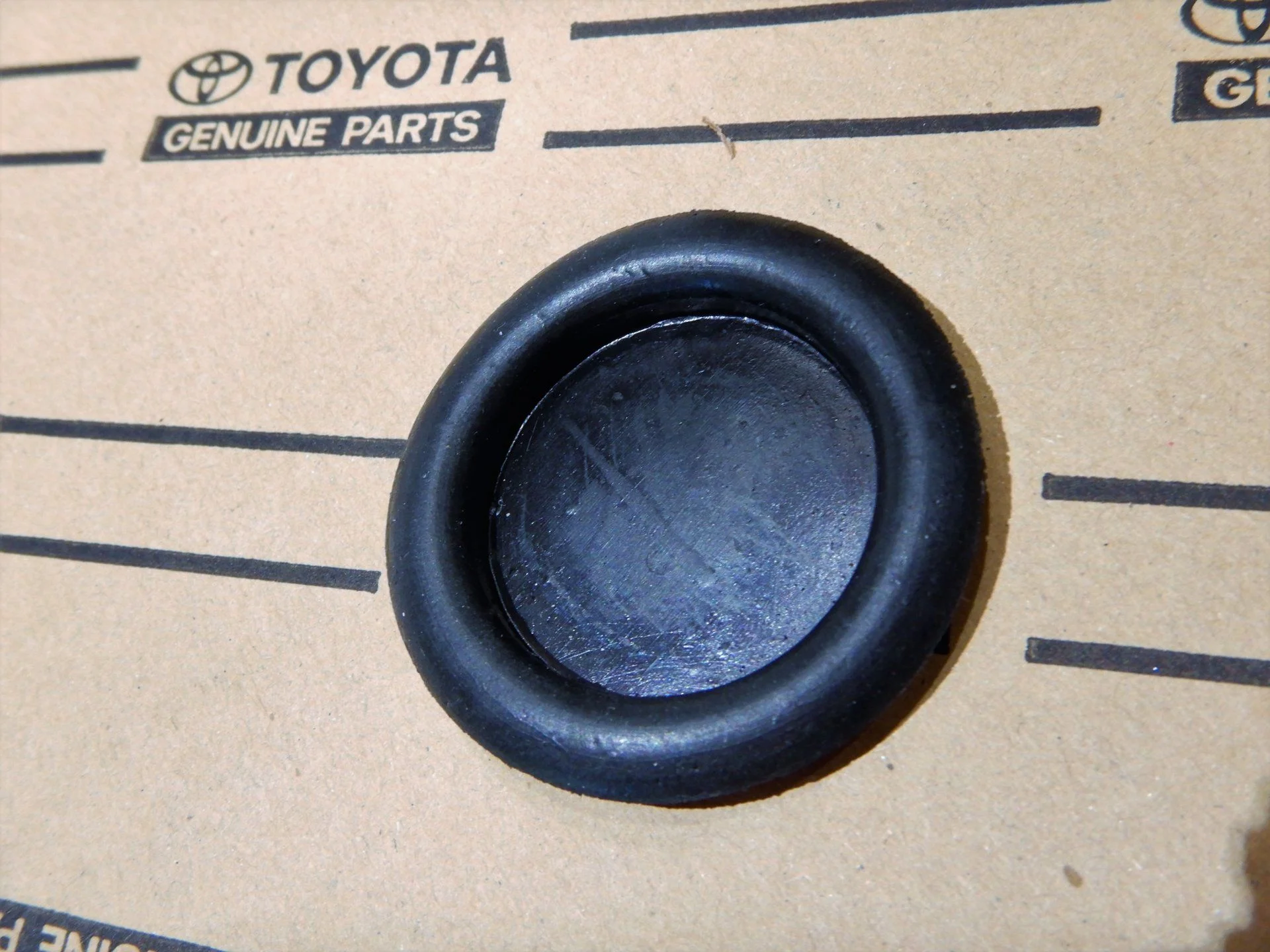

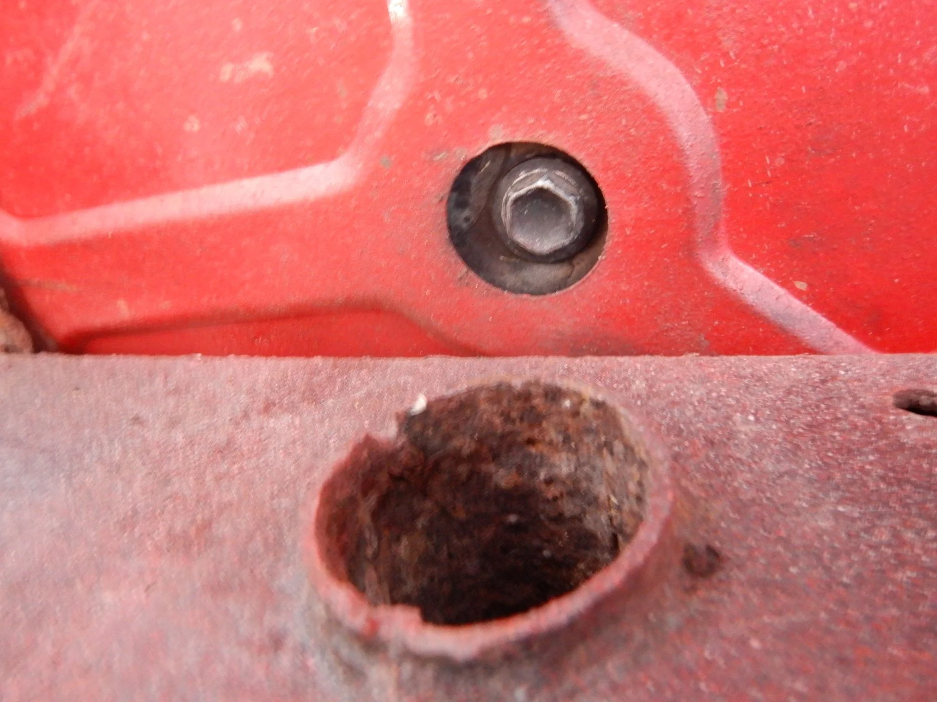

Sometime around this past New Years or there a bouts , I was Grazing for knowledge here in the Unobtainium
Thread & i ran across a Curious post from my Friend and fellow member @Helipilot . He was describing a missing part
he needed and where it was located were i always thought there was No part there .
So, ................

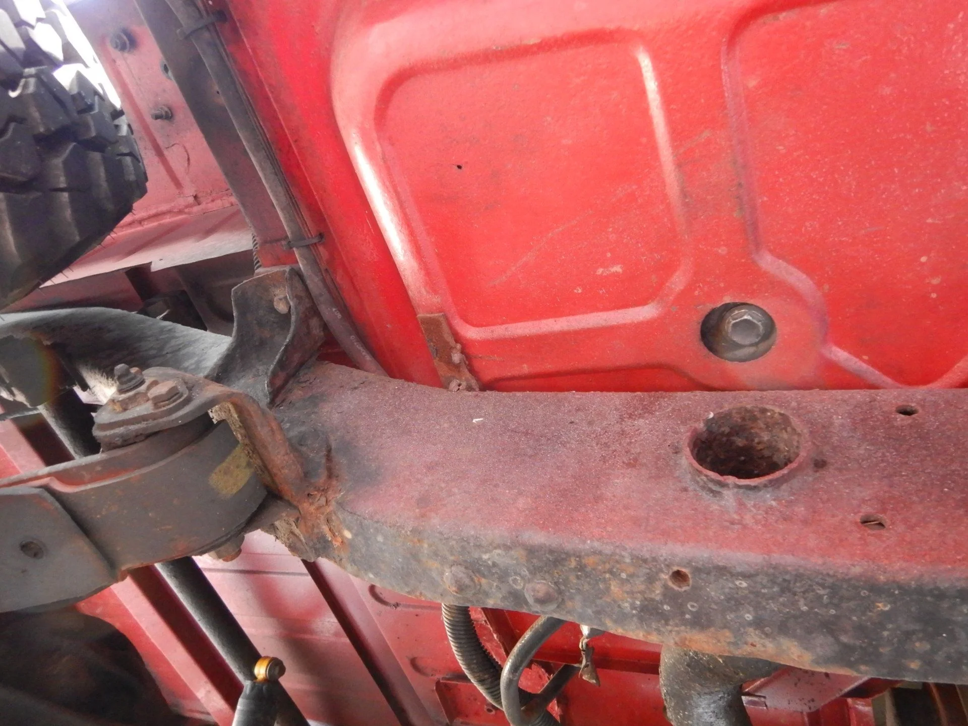

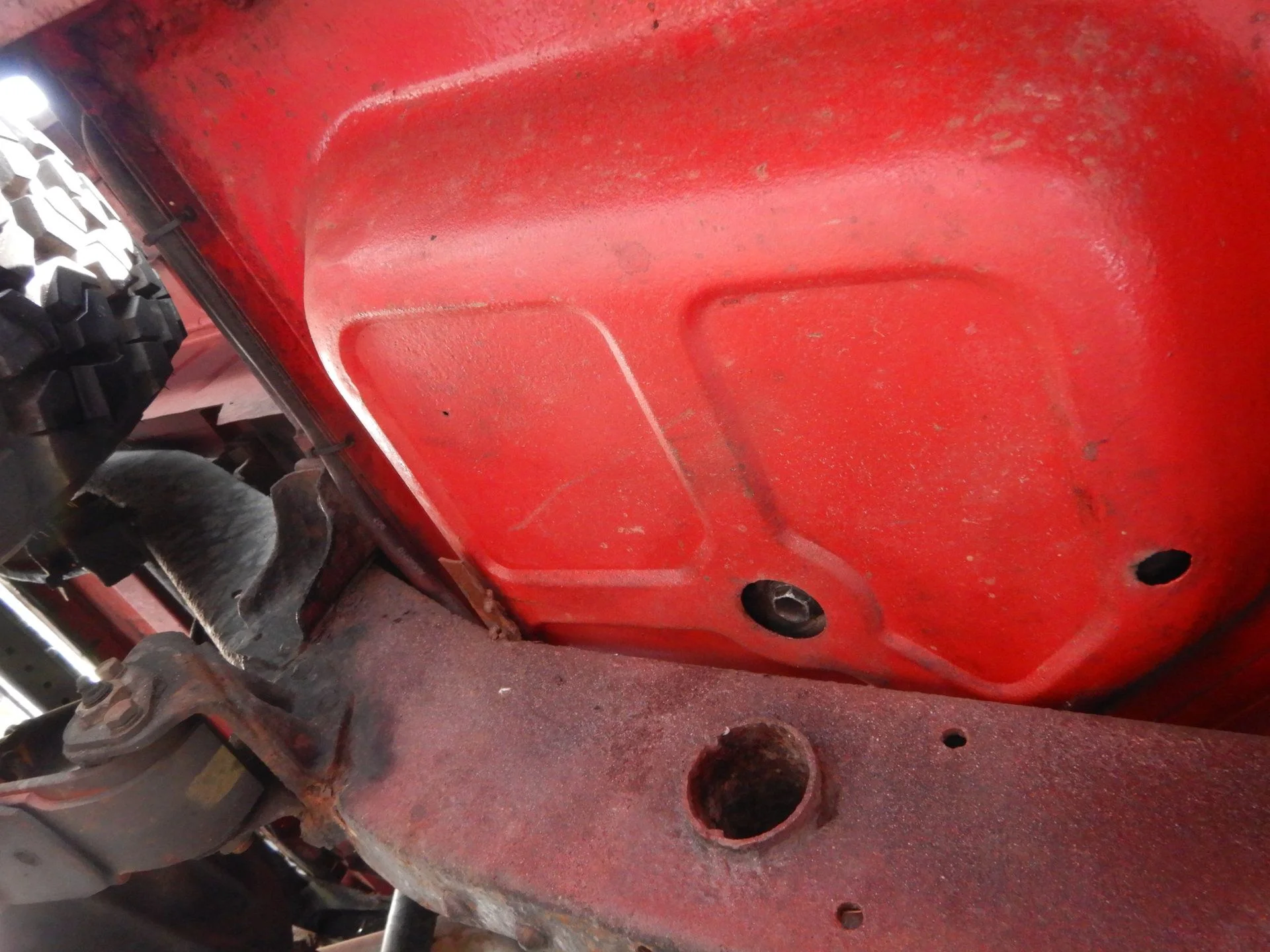

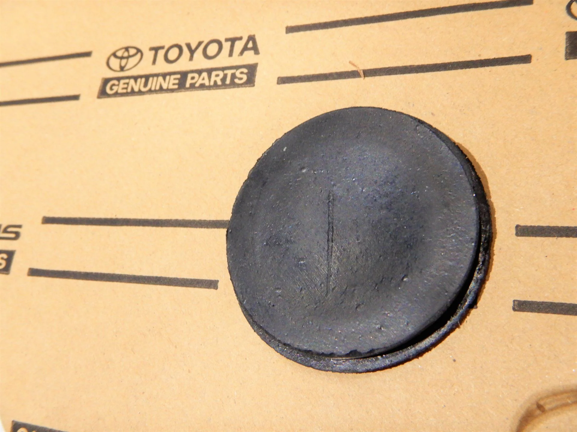

The Fuel Tank has a Drain Plug Much like the Oil Pan does , its a 17mm Hex tool , and there is a unusually large round hole
in the TUB around where the drain plug is located . Originally TOYOTA installed a Plastic or Nylon type Plug Or grommet
to cover and seal the large hole . part # 90950-01102
well i had never seen one growing up with various Land cruisers all my life , and started to wonder why ?
i stared looking at any 40 series i came across witch aren't many here in DC , but i did survey a few enough to conclude
the plastic plugs were Coming out by them selves over time and Not by PO meddling .................
i quickly concluded that the fluctuation between cold and hot , winter deep freeze and summer sizzle was likley
a contributor . Almost instantly i was Dreaming up Solutions with a Factory Focus Point Approach end goal result .
i decided to go with a Double Lip design and a Cold Climate spec. EPDM rubber type material .
after 2 long months , my samples finally arrived 🤔
they fit perfect and how i had envisioned when spec,d the design , Most of all they Look both Period Correct
and have a Factory Fit & Finish level .
Below is : Part # 90950-01102-R

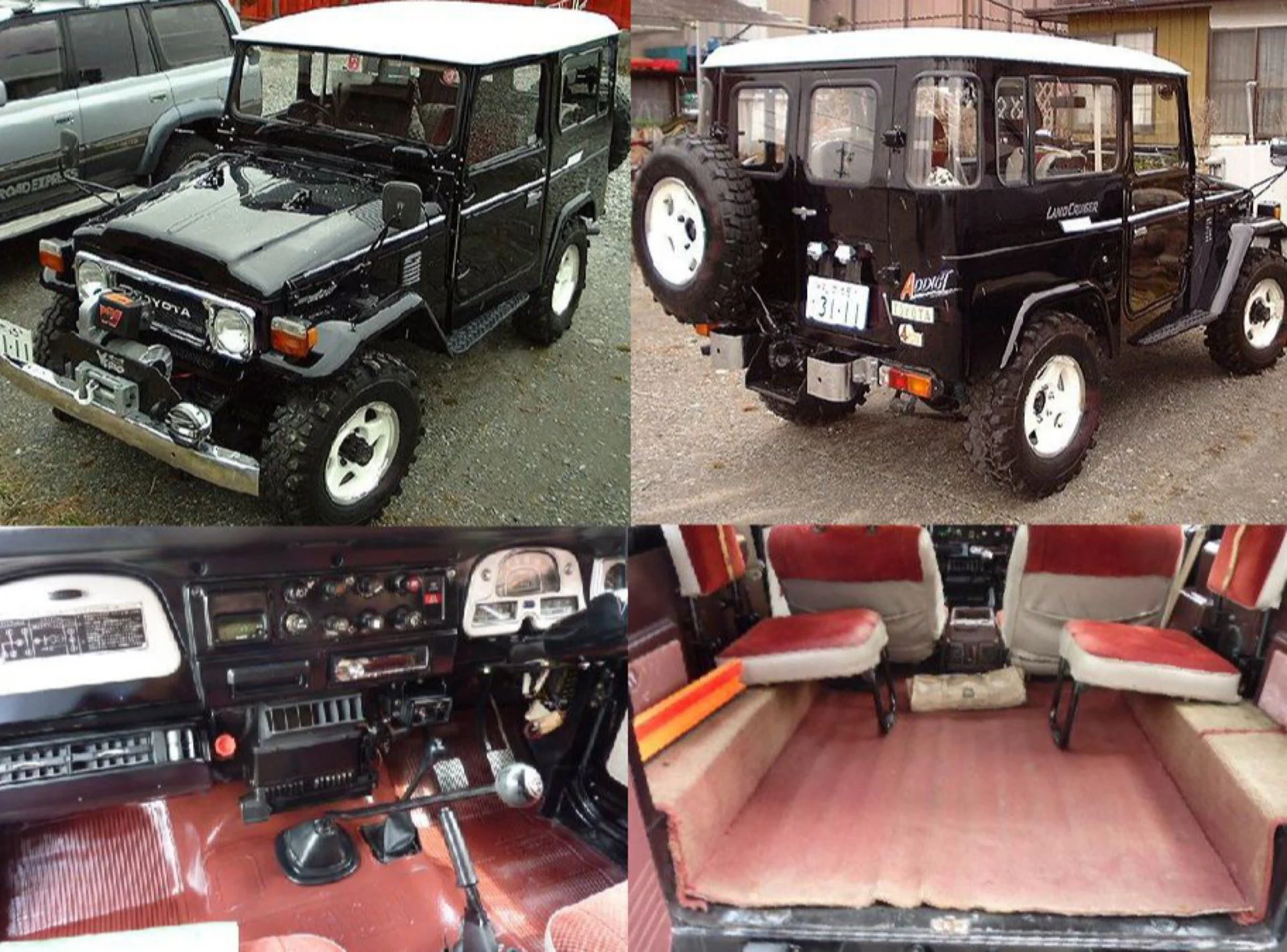

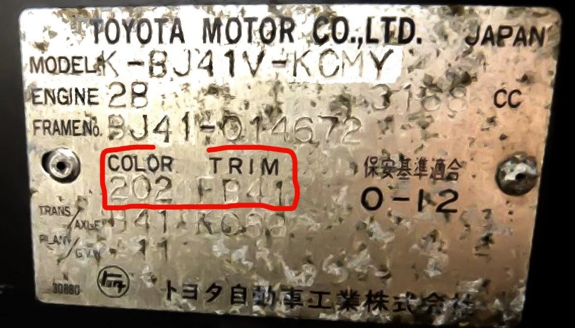

Next challenge for @Racer65 is a red floor mat for FB41 trim color :)
Not very common
That's probably a BJ41. Those have way goofy interiors.
Think I may have seen a mid wheel base in Europe with a red interior.
I actually like the brown interiors but the front and back mats are just the begining, still leaves seats, door cards, door handles, door pulls, window cranks and steering wheel to make it blend. Would probably paint the padded dash as a finishing touch. Cruiser painted mustard color with factory style decals would be one sharp cruiser.

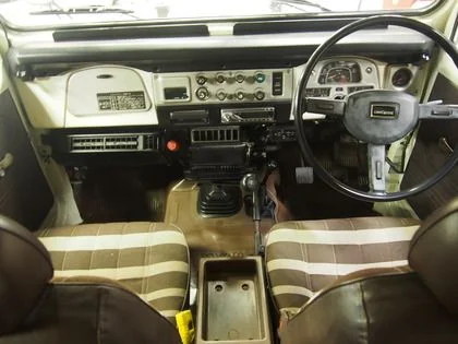

Toyota was very Creative
Brown with a logo
Brown without a logo
Wonder if they dropped the Toyota 10/82 when the five speed became a option in some markets. The opening for the transfer case moved back on five speed models. The picture with the logo has a transmission shift cane boot from before 10/82. The one without is 10/82+.
@Living in the Past
So many versions to discover... It looks like for 5 speed and Brown mat(?) Toyota has reduced the logo and moved it to the seats
