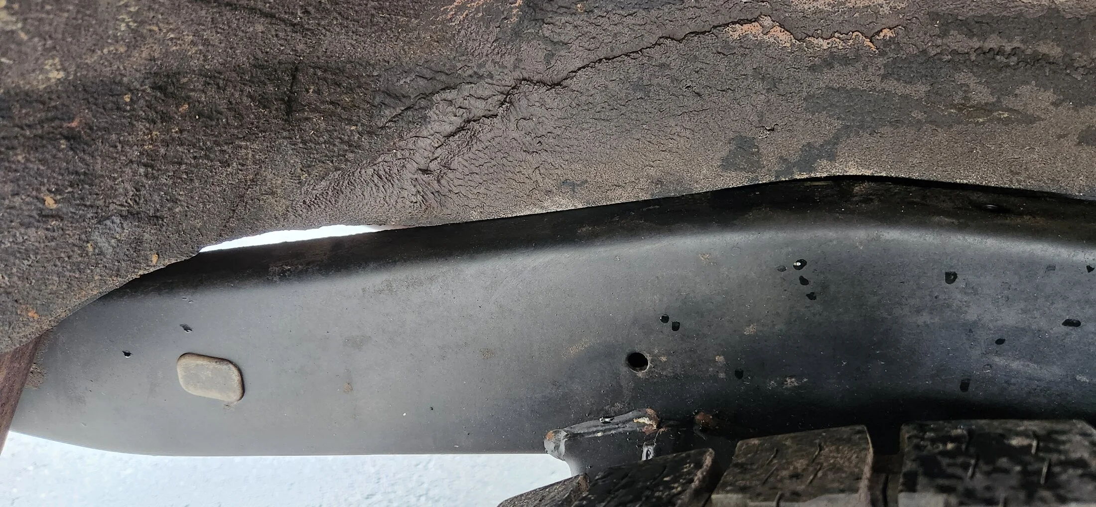

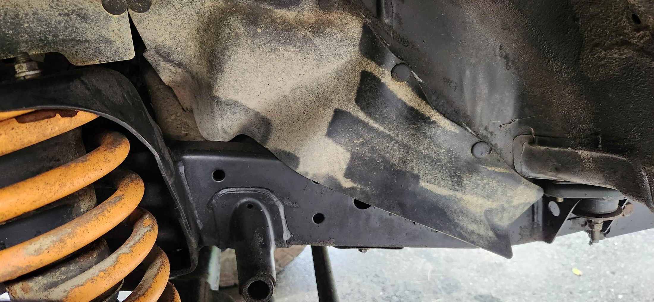

The pics below were taken after I did a lousy job power washing my frame and other dangly bits to get the 10 years worth of Fluid Film and dirt layers off and see what's actually underneath. The following day I did another coating of FF in my driveway.
This is after 10 years as a daily driver in Jersey, so you can make the decision if it's worth it to put up with a temporary smell and a greasy undercarriage.
