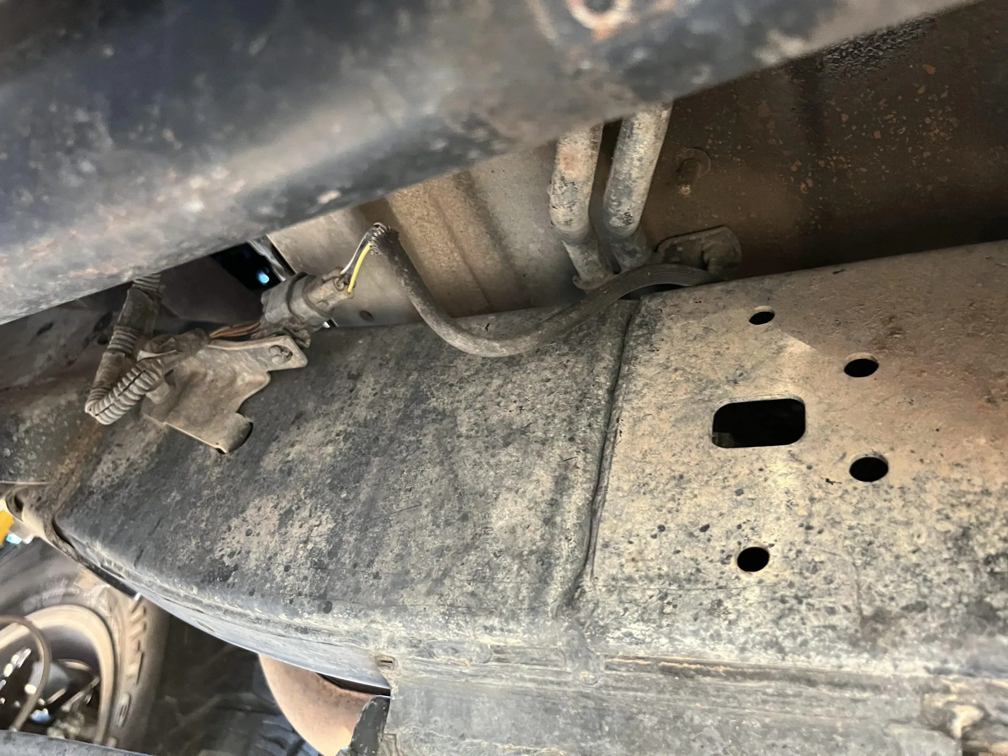

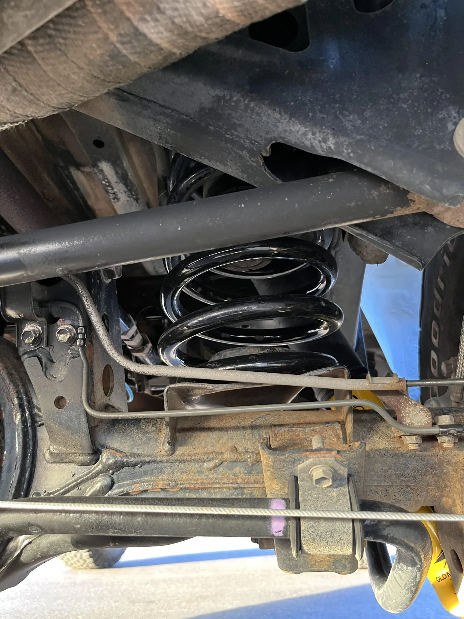

Looking to the locals here on suggestions to protect my new baby's bottom side. Some of you may know that I flew out to AZ to pick this one up back in July...she was garage kept for years and obviously in a very low humidity situation in southern CA and AZ all of it's life. That said, she's an east coaster now, and I want to protect it from the winter sludge, Assateague salt, and PA mud. Thinking of using Woolwax or Fluid Film, any other suggestions or pluses for one or the other of these? The cruiser will stay garage kept, but I want to keep it as rust free as possible while still being able to enjoy for what it was made and built for. Thanks for your thoughts!
Here are a few pics of the overall condition now...super clean except for the AZ red dust/mud residue and very light surface "rust" on the axle...

Thanks...thinking Fluid Film right off as I don't think I want anything too thick and don't mind applying annually if needed, plus it's not a DD or really driven much in the rain either.
Happy to hear other input too!
I may end up going with Woolwax...my son needs to do his '96 Taco, which is crustier and would benefit from the thicker coating from what I've read. Makes it worth it to go with the decent gun and buy in bulk too since he wants to split the $$. I'll probably do a sampling of the thinner version for mine and the thicker one for his.
I definitely want to get this done before we get to winter cold and (hopefully!) some snow here...My mild OCD will make me probably power wash and detail the whole underside first even though they say that you can just spray away...
