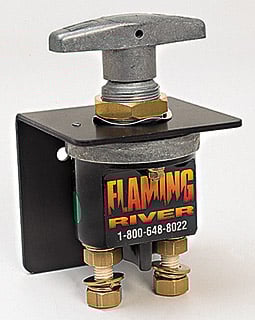

Standard Perko type switch. I'm partial to this one:

For real though...... I have considered doing a disconnect of sorts, but i don't want to have to reset my radio, clock, etc. each time I use it. I say this because I would consider using it each time I parked the truck remotely and was not planning on driving it in 2-3 days + or camping and leaving for a hike so it would still be there when I get back.
Any thoughts? back up battery for powering computer memory for "x" period of time? but now enough juice to arc?
