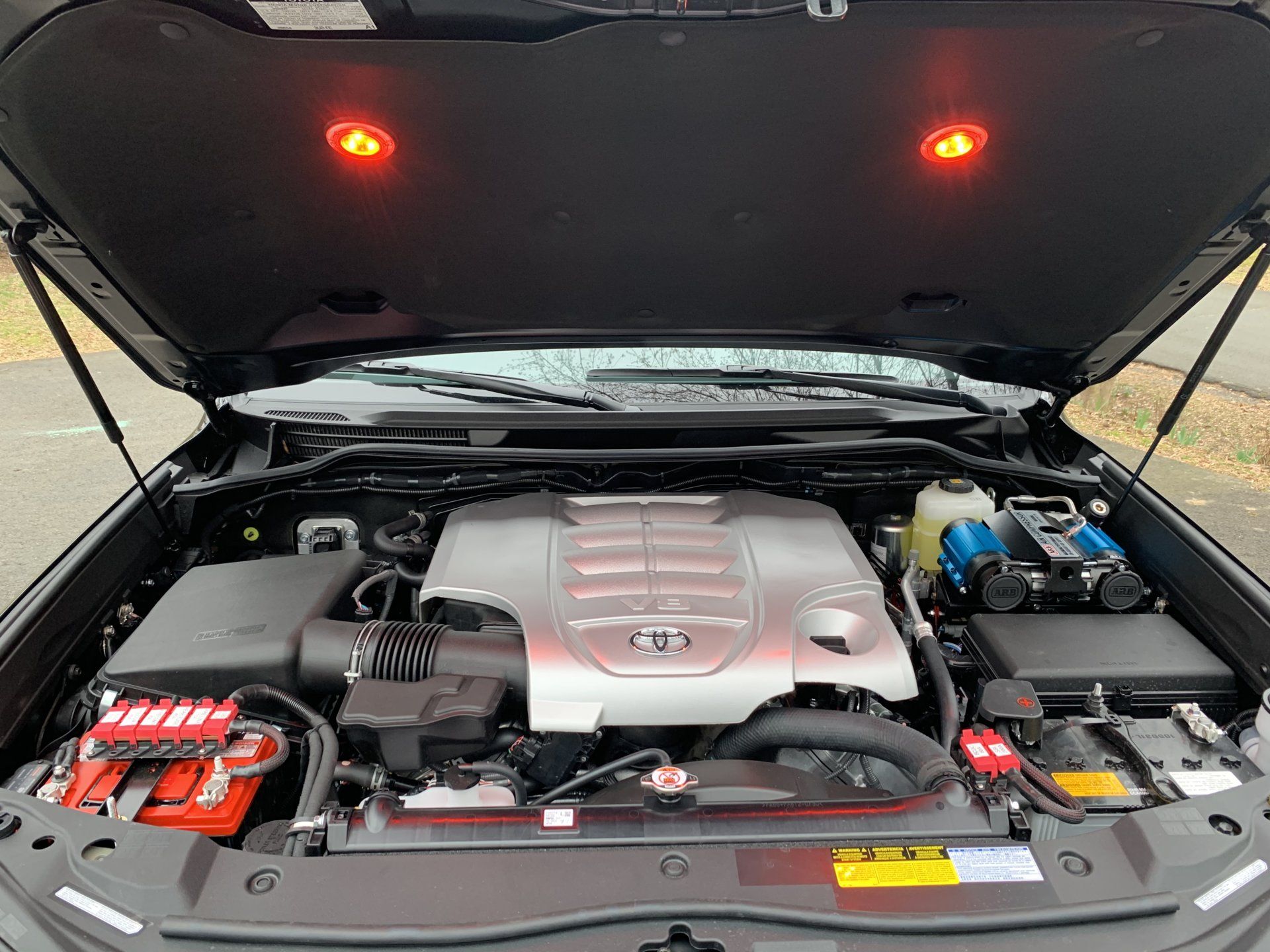

Quick video of our under hood light offering for new 200-series
Those work nice! Especially like that they have a red mode which helps save night vision. Wonder what light fixtures you're using. I could use them in the rear hatch.
Highly recommend these! I no longer need a flashlight at night. Great job Eric.

Eric, I just ordered a pair of these but focused on the mounting. Are those glued to the hood liner or bolted through with backing washers and shortened studs.
wonder what the output is. Whalen website doesn’t specify.

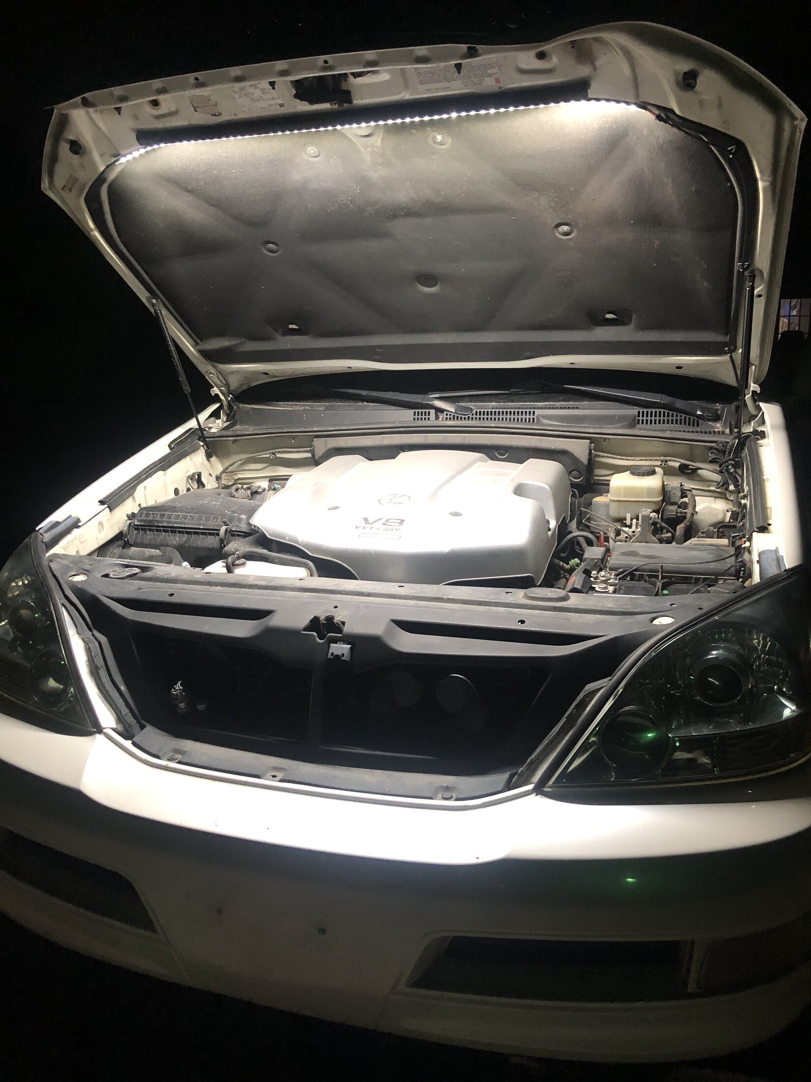

And the cheaper LED strip method which might give better spread.

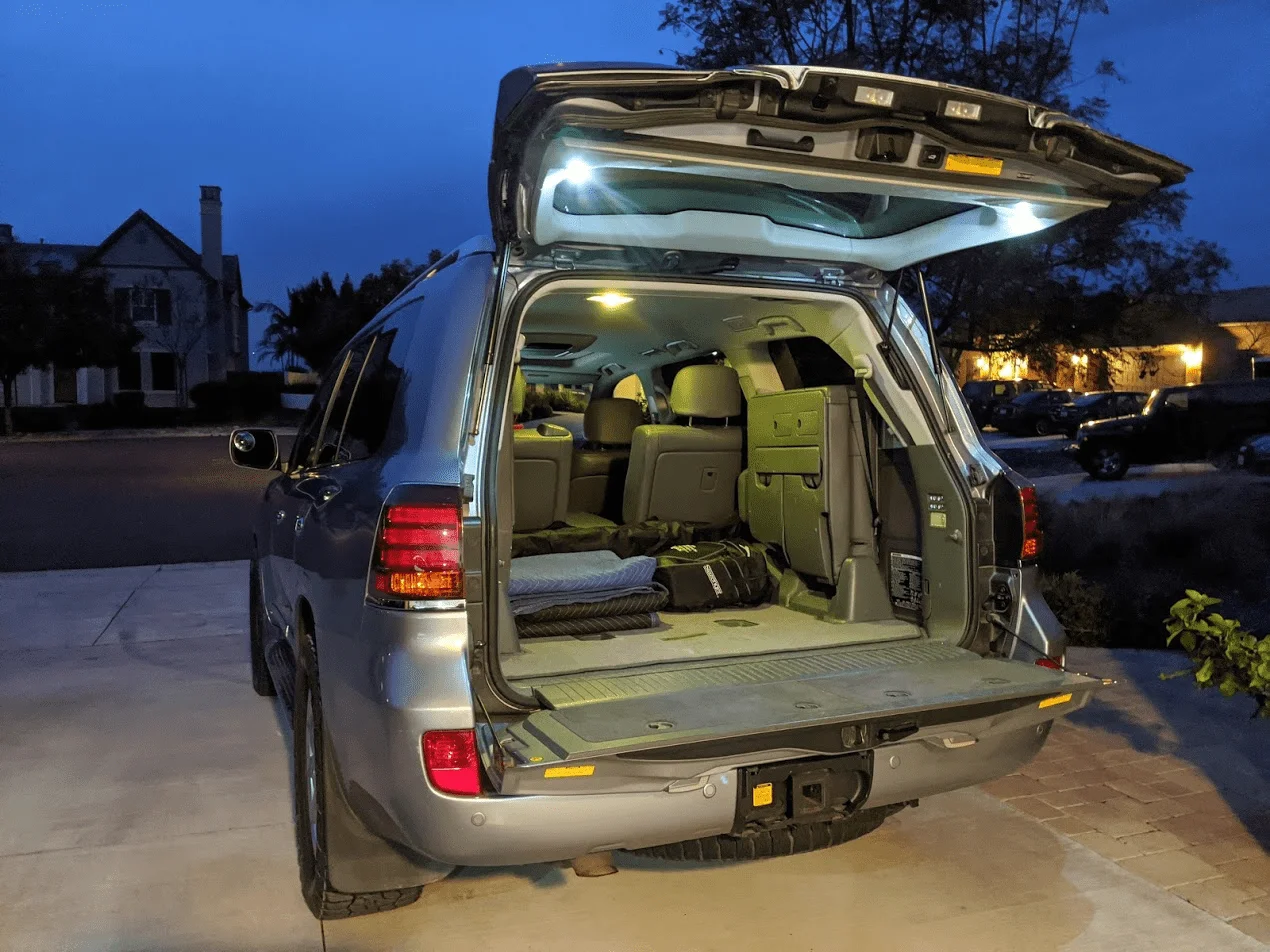

I also ordered some Luna LED strips for the rear cargo area. I may see if these would fit and do well in the engine bay too. But leaning toward the cyclones for now.

Found this in a Whelen flyer: https://manualzz.com/doc/11638909/3-round--super-led-lighthead-”
3SRCCDCR
...Compartment light,
combination red/white,
.31 amps 140 lumens red,
.31 amps 250 lumens white

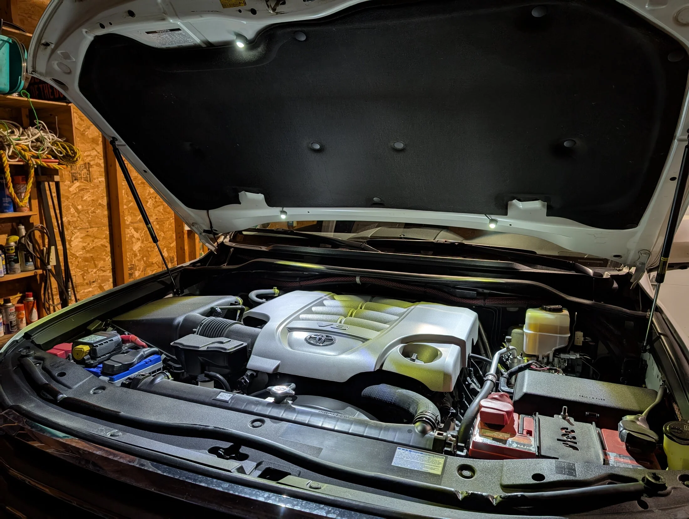

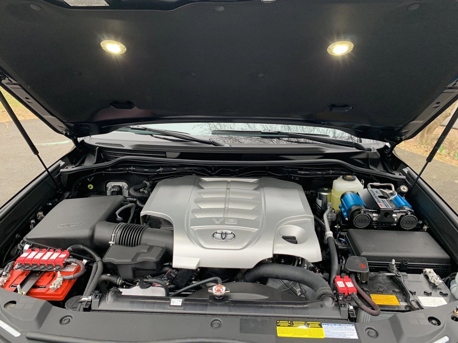

I kept it simple. A single manual switch (you can see in red at the right). Used rock lights mounted with double sided tape. Cheap and easy mod.

Photo doesn't really show them well, they are very bright. Wires are all above the hood insulator, no cutting required anywhere. I use these lights, very strong 3M VHB tape holds them on:

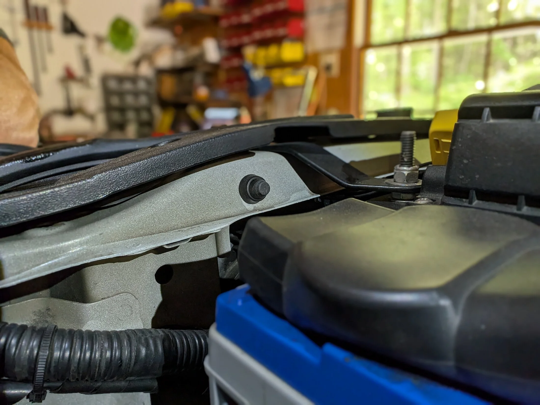

I initially had them wired with one of those pin switches. Yeah, they pretty much suck. They rust very quickly and stop working, you have to fiddle with them to get them to make contact and turn the lights on. Found these nice weather resistant pushbutton switches on Amazon, works great, they fit perfectly into an existing hole in the core support on the passenger side.
