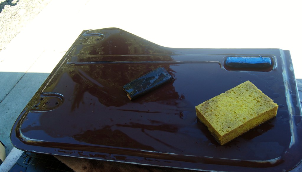

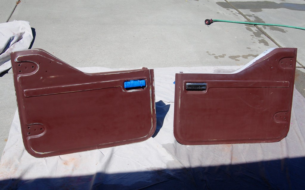

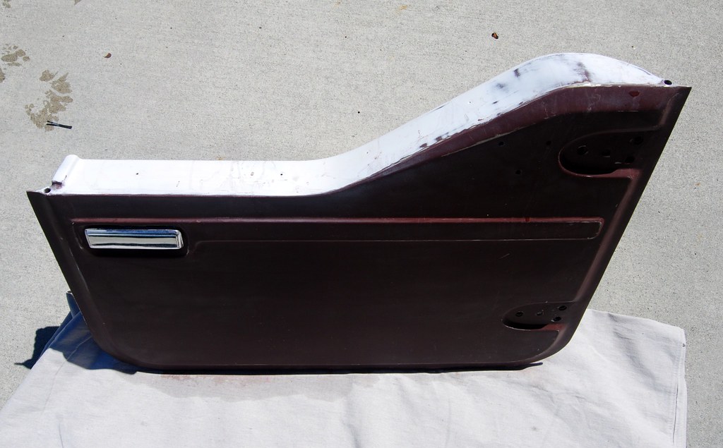

Finally decided to bear down and paint the half doors.
I've never painted anything before (except Estes rockets & Marvell models).
Step one complete: Wet sand Pakistani primer (after adding a bit of filler primer where some had chipped off).
I'm now ready to paint the final primer. I bought some high-quality stuff at a auto paint supply store.
I have 4 cans of rattle cans I had made up from a sample that matches the Mustard Yellow on the rest of the rig. Maybe I'll find time tomorrow to get 'er done....
Tips, comments, suggestions, all appreciated....
Treat it with a good neutral cleaner (not soap) before applying paint to ensure all oils from your fingers have been removed. No matter how delicately you handle it you will transfer oils from your skin onto the doors. POR15 carries a good product just for this task, which is what I use, but I'm sure there are other products on the market that will work equally well.

Paint: I use 90% Isopropyl rubbing alcohol to prep right before painting. Make sure your primer and the final coat don't react to one another - test paint a small area where you can't see the paint. If they react, then the primer will crinkle up like a dry lake bed.

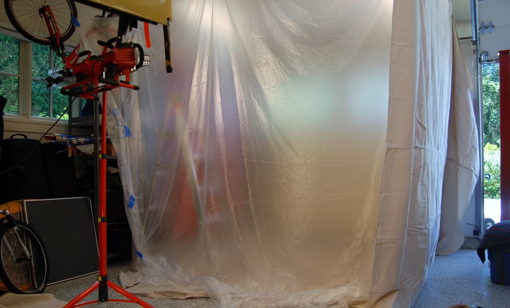

Making progress on the painting today.
Built a little paint booth so I could paint the half-doors for the FJ40. I've spent ALL day in the garage today (with the England v. France and Germany v. Japan women's soccer games playing in the background). It's like I've died and gone to heaven.
Here's the dorky paint booth.

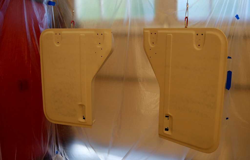

Got the first coat of epoxy primer on after prepping the doors.
I followed everyone's advice and:
- Removed all the door hardware. It was easier than it looked.
- Prepped with Marine Clean and Metal Ready after at smidge of bondo to fill the snap holes in the top (I'll never use the soft-top half-door tops)
The epoxy primer should be ready for block sanding in 30 minutes or so, right?
I'm going to block sand it (lightly) then apply another coat of epoxy primer. Then block it again.
Then a real light coat of paint, let dry 30 minutes and then one heavy coat.
Right?
Not too heavy, just smooth and complete. I find that is you can paint it with a decent, even light reflecting on the area being painted, you can see when you have a smooth coat of paint; too much and it will sag, too little and it will orange peel. Nice, smooth, even - that's the key.
Josh
