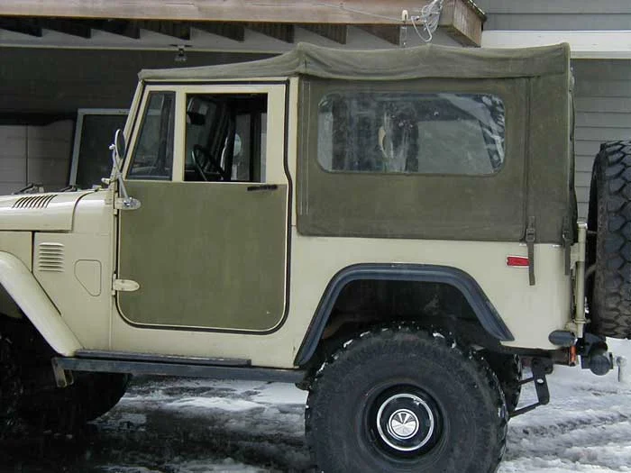

highlandcruizer & softtopguy,
I have an older style OEM soft top that you could use. It's made of thick canvas and no zippers. All twist lock fasteners. The three window panels are removable as well as roll-up. Due to the age of this top it has shrunk quite bit, but still fits on the truck.
Not sure if this is what folks are looking for but it is oem. It flaps in the wind a lot less that the later style oem tops which were made from the thinner material.
Let me know if you want better pics.

The top in #142 is about exactly the look, color and type of material I'd be looking for in an OEM top. Cept I'd want the two little rear windows on each side of the rear window opening - safari style. Don't care if the side window is one - or split. Lots of options. I do want the sides, the rear sides (either side of rear window opening) and the rear window to all be removable.
