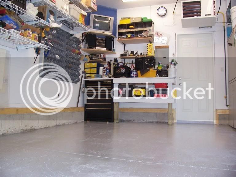

I have a Rezor 60K BTU in my garage and love it. It keeps the garage "shorts and a t-shirt" warm in -30 winters up here. I was border line between the 45 and 60K BTU units so I went with the bigger one for my garage (3 car).
http://www.rezspec.com/catalog-udap.html
