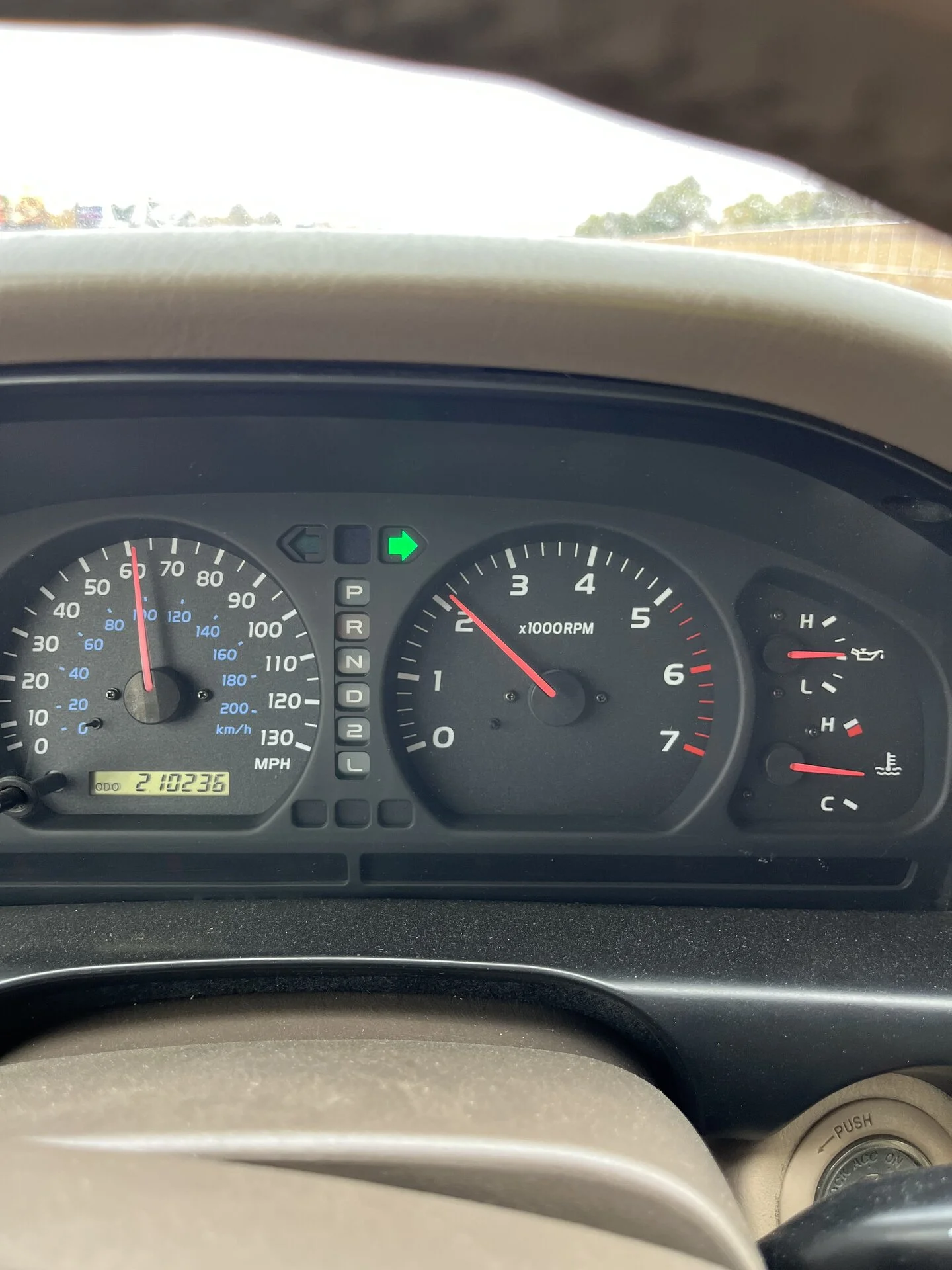

Right turn signal turns permanently on when temps are below freezing. Had the first day below 32 yesterday here in CO. Right signal came on and the front and rear signals are stuck in bright.
This hasn’t happened since below freezing weather last year and I was really hoping the weird electrical issue healed itself!
If I engage the right turn signal on the column, I hear the click in a rapid fashion but light on dash and exterior signals just stay bright.

Took a video of the dashboard, but realized videos are supported file types!

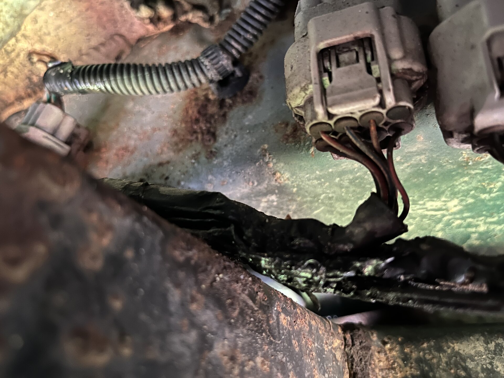

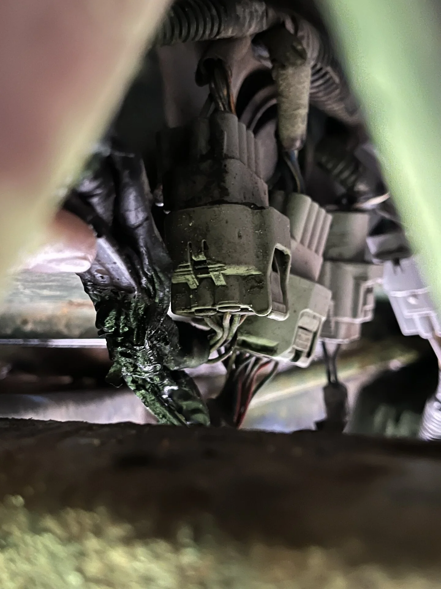

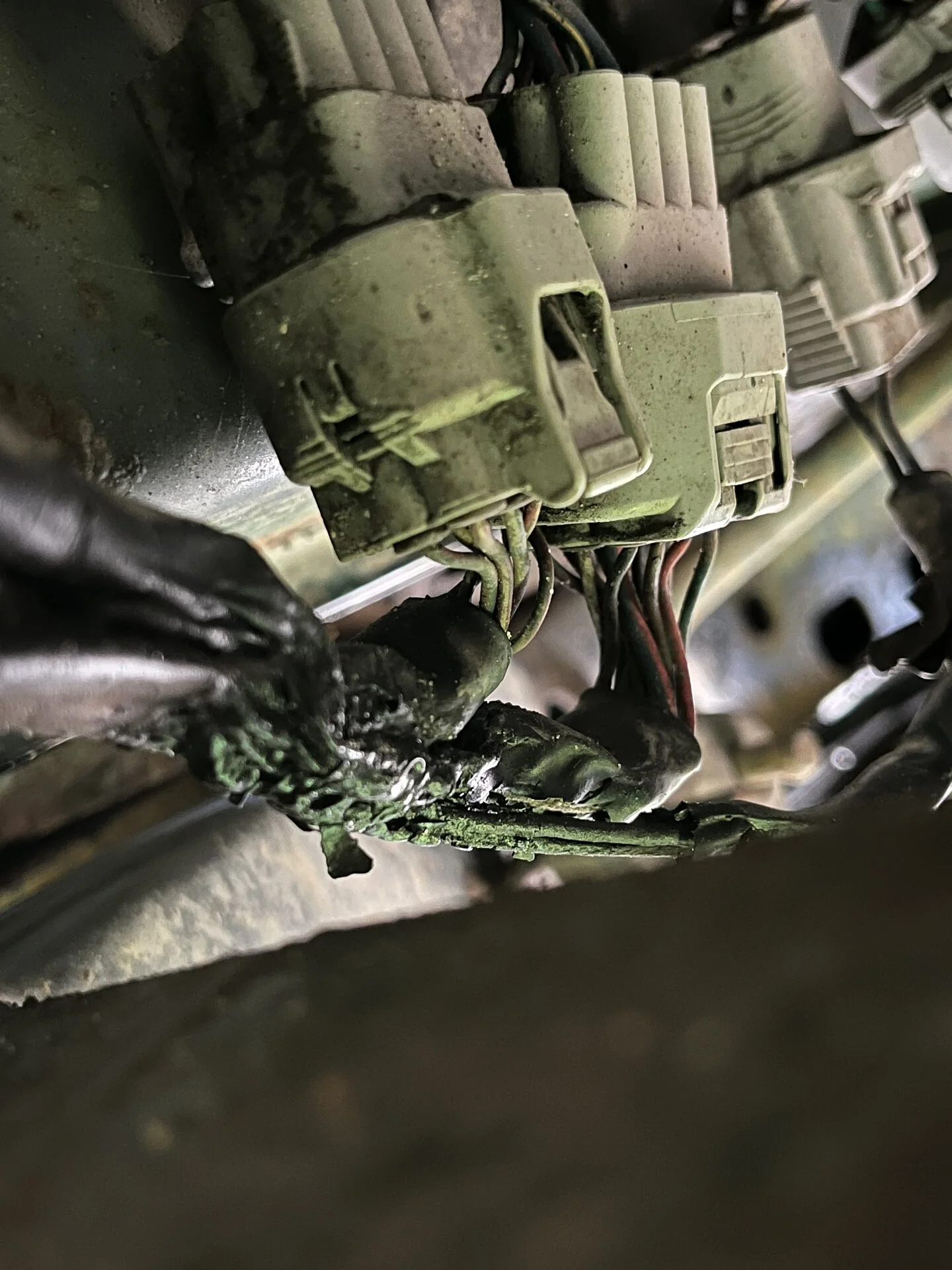

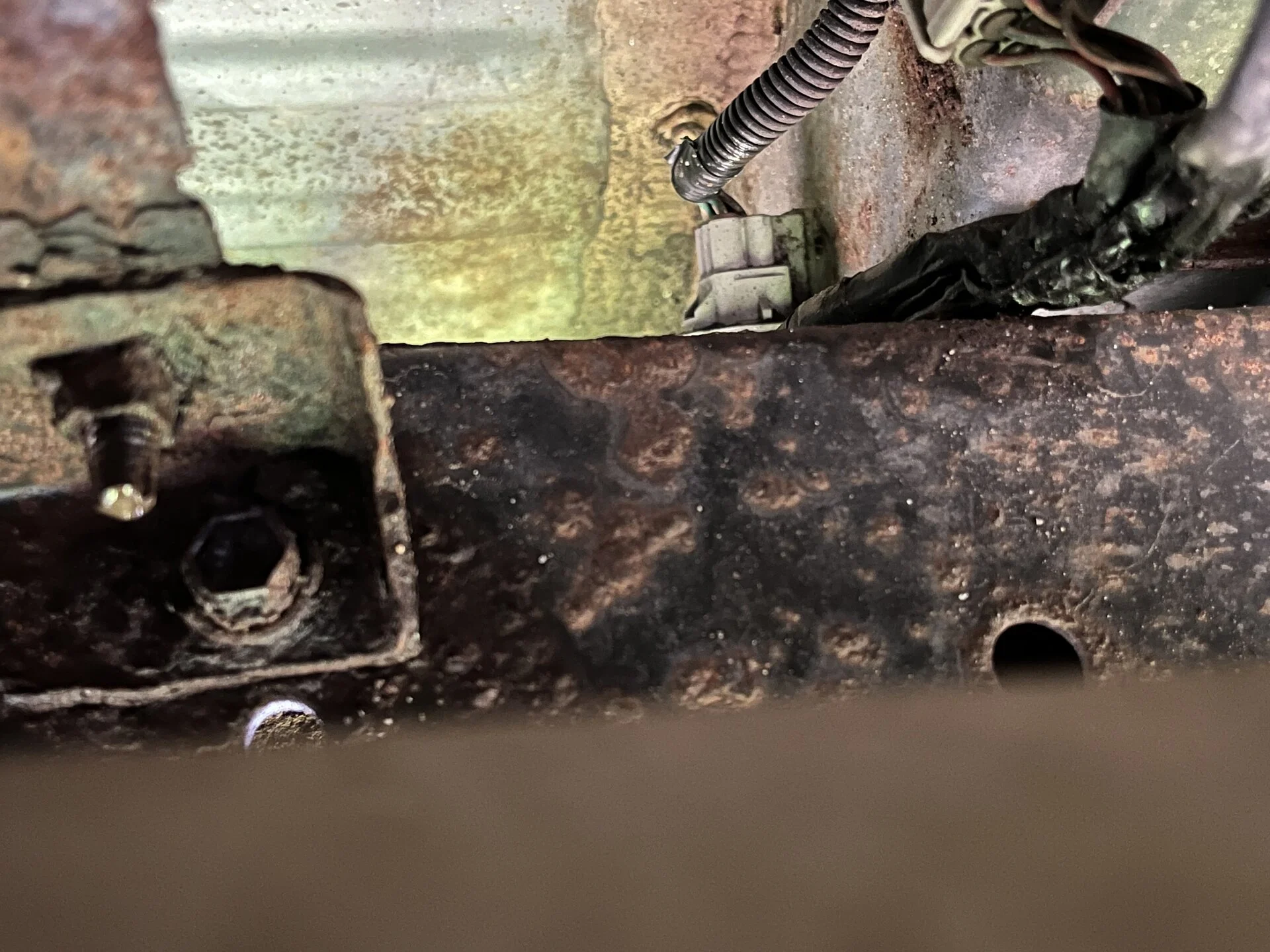

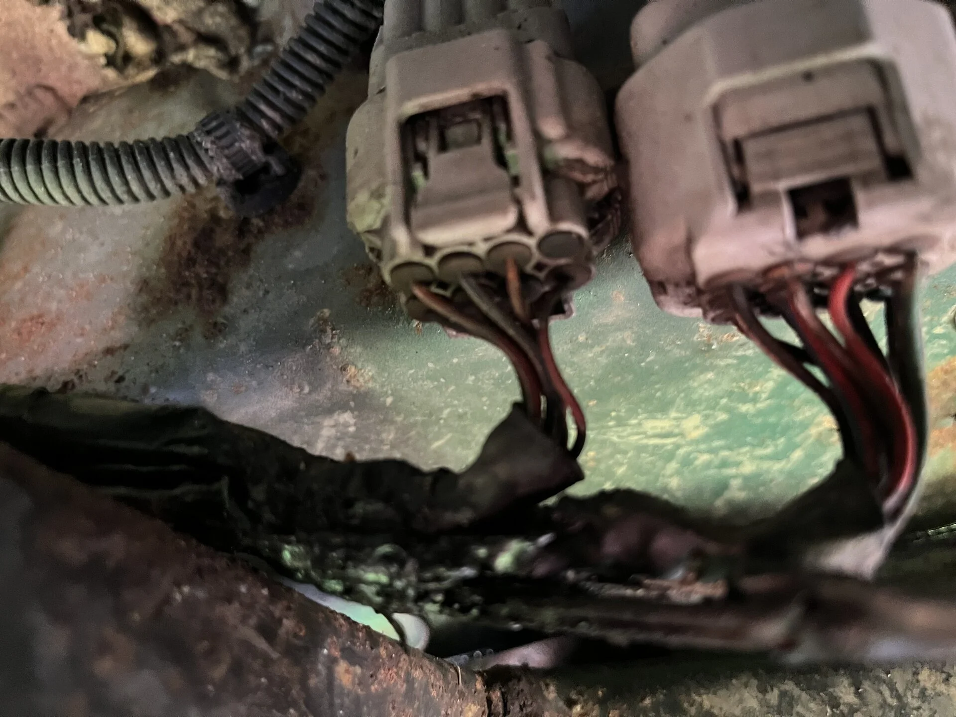

Saga continues, sorta fun in an awful way. Was under the truck removing the trailer harness and felt some crusty rusty wires sitting atop the chasis above the exhaust.
As I typed this, I’m now wondering if something shorted and melted?
I’m thinking this has to be the issue. Look at how bad the wires are…damned salt and chemicals have torn me down…
Alright, wires spliced and cleaned up!
Really hoping there are no other issues from having these wires exposed for about ~10 months.
