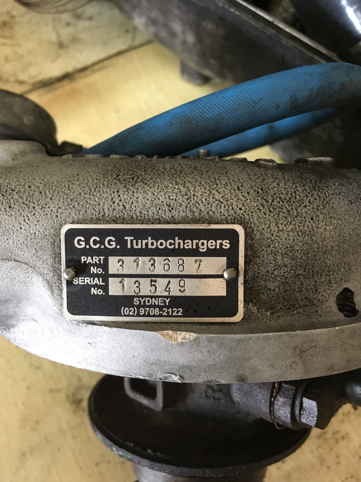

Turbo 2H guys help me out. Turbo Dynamics/Denco kit fitted. Runs like a top, got the fuel adjusted pretty well. Slight black smoke at low RPM, almost none at high. EGT at the manifold with the sensor on cylinder 5 is 950F degrees max, usually sits much lower. But it won't build more than 5 psi. Even with the waste gate disconnected and wired shut. I had a nasty exhaust leak and two broken exhaust studs so I just pulled the exhaust manifold, turbo looks ok. Very little shaft play. Spins freely, no abnormal noises. It is a Schwitzer S2A (T3 flanged). Changed exhaust studs, exhaust gaskets, turbo gaskets, and all the turbo hardware. Put it all back together and still 5 psi. What do I look at next? No intercooler, all hoses and couplers are new too. I'm stumped. No massive leaks that I can see or feel. Here's a couple pics of the setup.

The schwitzer s2a is quite an unresponsive turbo . It has an old school design turbine which isn't the most efficient and the turbine housing is probably on the large side for your use . I think denco use a .50 or .54 A/r turbine housing . I'd say that 5psi is about all that it will do with a factory 2h pump. There simply isn't enough energy to drive the turbine to make more boost.

Snorkel is new-ish, I installed it when I got the truck. And the silicone hose has a very short unsupported section. Both pipes nearly meet in the middle. I can't crush it by hand so I don't think that's the issue. But I'll try running without the intake pipe and see if it changes anything. Thanks for the suggestions! I'm thinking it's just a too large exhaust housing for a stock pump. Spool isn't super quick but it isn't unbearable. Is there a turbo size that's recommended for a stock 2H for when I get around to replacing this guy?
Update, I tested it with the intake piping removed. No change in boost. Right at 5psi. Also cranked up the fuel another turn. More black smoke, but no boost change. Didn't run it long enough to see what it did to the EGT's but it smokes like crazy now, so I'll be turning it back down. Lol. It's crazy that it can't make more boost. I guess I don't have enough experience with turbo diesels, but with a turbo gasser I've never had boost building problems that weren't leak related. My only turbo diesel experience is with our 7.3 Ford's at work and they build PLENTY of boost (unless you have a leaky intercooler connector). Oh well, I'll keep running the S2A until it gives out then upgrade to a better turbo!
