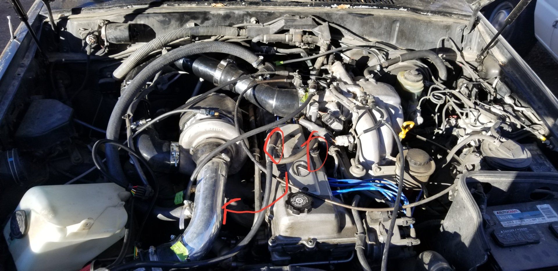

Route the PVC and Crank case to a catch can and then pre-turbo. stuff in red.
Or if you want to smell the nasty stuff vent to air.

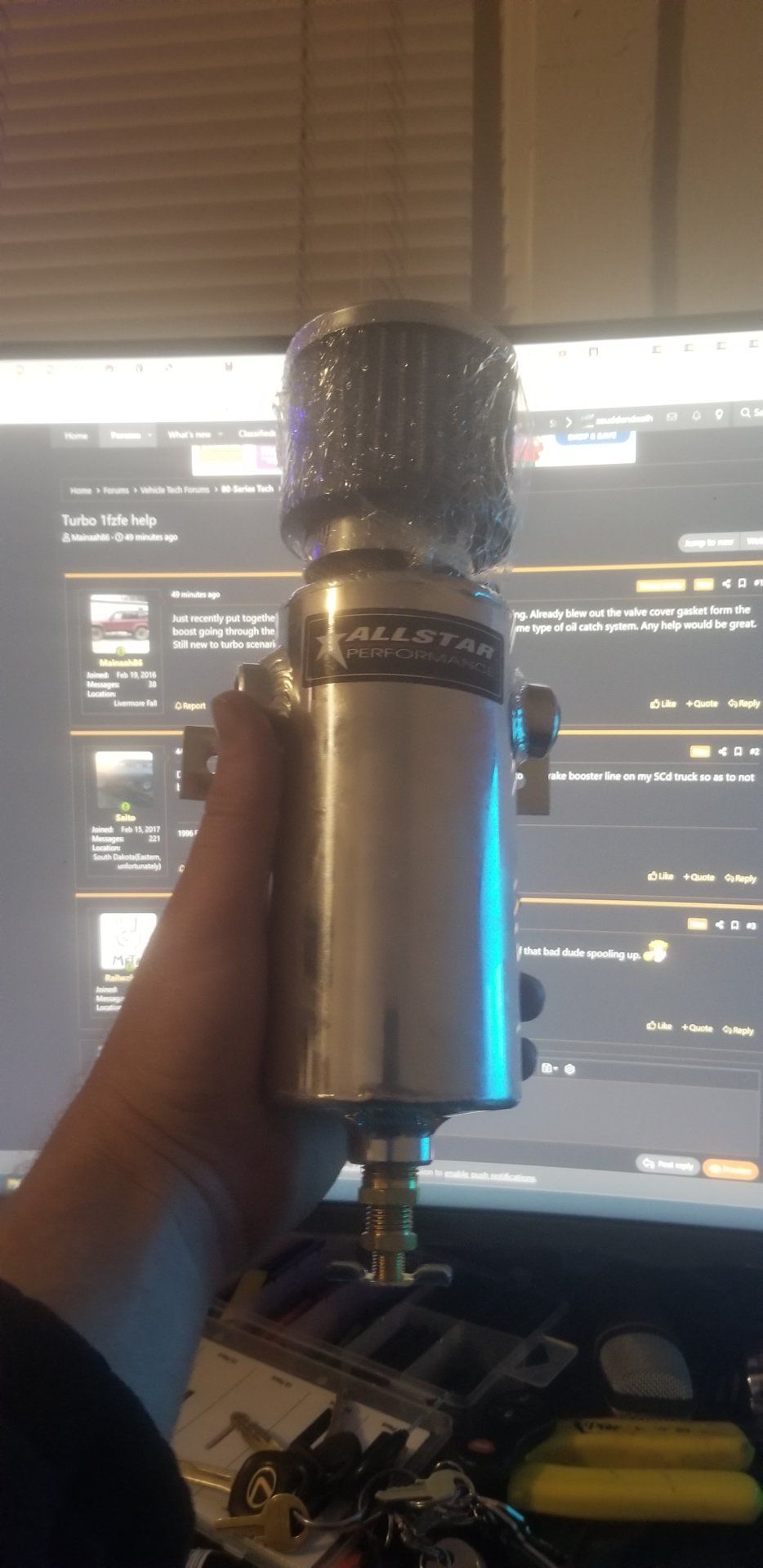

I think ill be running this, catch can to air.

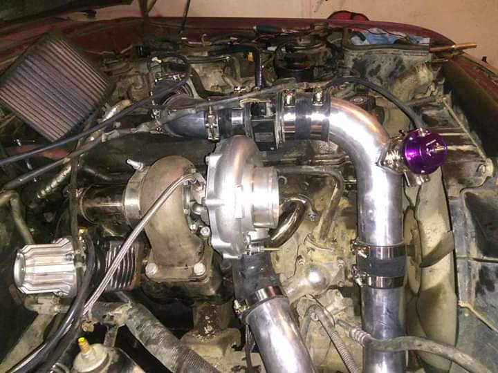

No pictures at the moment. Still a my friends garage. Is this your set up? Also where did you go with the hose from the throttle body.
Goes to the waste gate.

Yes it is a cx racing kit. It's not really worth the money in my opinion. Going to be looking into a better turbo, possibly smaller one. I have one from a 5.9 12v cummins that I might fab up to fit. No a fan of the turbo lag it has at the moment.
Most questions have been answered. You will want to vent those lines out of your VC to an air/water/oil separator. Best to have a 1 way valve in it so you don't have a big vacuum leak or plumb it to pre-turbo. You will also want to address the other vacuum lines that shouldn't see positive pressure.
Yeah a 76mm turbo is way too big. 60-62mm is the sweet spot.
