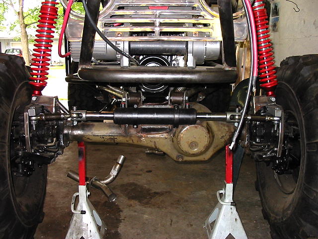

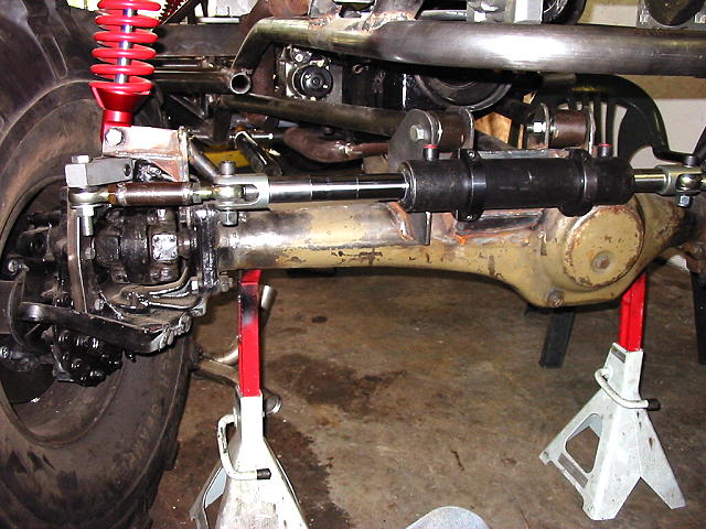

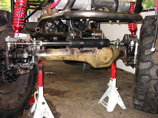

Thanks for all the great comments. Here are some more pics of the steering work last weekend. I also finished the front y pipe, but don't have any pics.
Finished ram mounting:
Steering angle before:
Steering angle after grinding and going to near limits of CV Joints (gained about an 1-1.5" travel from the ram. For those curious that is a 10" ram:
More to come after this weekends work.

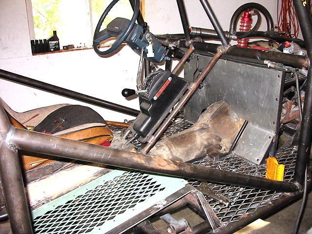

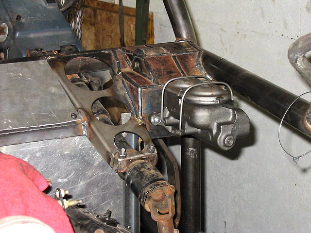

Here they are:

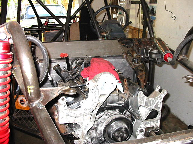

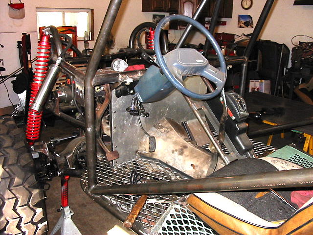

Work on the floor and firewall:
Engine side of firewall:
Master Cyl and steering wheel mount:

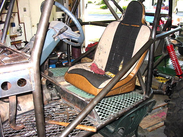

Drivesside with pedals (yet to modify to larger brake pedal :D ):
Lastly, driverside under the seat:
Enjoy!! And yes I will finish this someday.

Do you have some close ups of the steering system you built, top mounts.

I have bee working on the firewall and floors lately, I'll try and get more pics after the weekend.
By top mounts are you reffering to the high-steer arms? if so I can get more pics and info on them. All I have done so far with steering is the rams, tierods and highsteer arms. I am saving my $$ to get the rest of the hydrostuff.

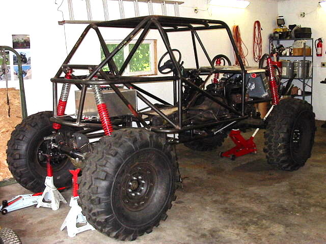

Figured I'd bring everyone up to date. Today was tear down from all the mockup so I can do final welding and painting the chassis.
Here is the start of today:

Update

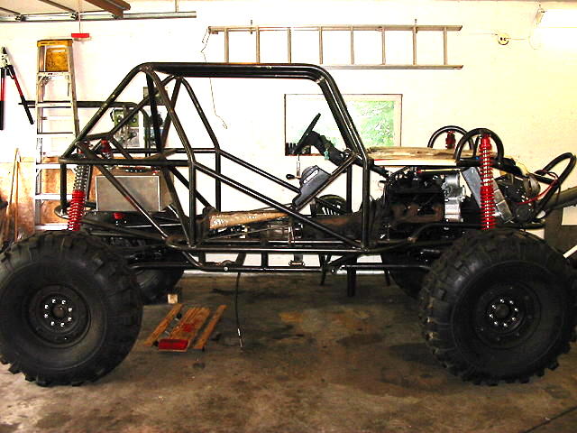

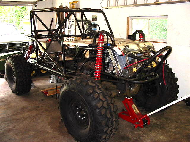

Well over the last couple weekends I have been able to finish all the final welding and get a coat of paint on it. Here is what it looked like this weekend all back together:
Here are some with the 55 series narrow hood on them. I still need to do some work on and paint the hood. On the rig I have hydrosteer plumbing to do, fuel lines, air lines and pump, finish work on the electrical and brakes, and mount the fan for the radiator. Then some odds and ends like seat belts, limit straps, guages, swtiches, and lots of other tiny details. Oh and there are now fancy race holes in my uber radiator protectors, but not pics of that. :eek:
