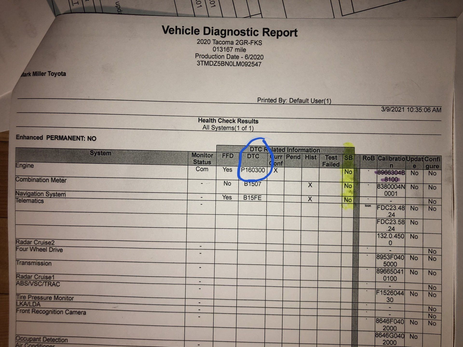

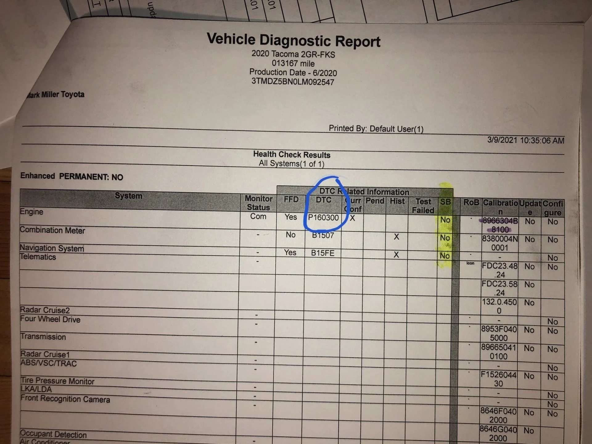

Manufactured 06/20. Dealer ran a health check and the current calibration matches that of what should be after the TSB was performed.
Interesting note though. They didn’t say anything about the DTC that was present (P160300) which seems to point to the same issue. Sounds like I’ll be making a trip to the other dealership in town.
