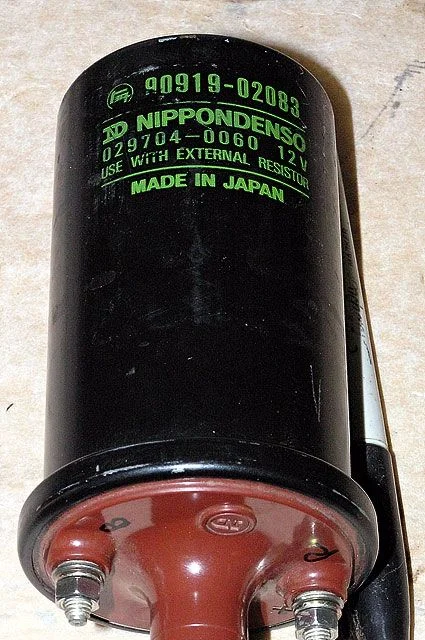

I noticed today (okay not paying attention again) :rolleyes: that the old Toyota coil says "for use with external resistor". So I went and found a resistor for the coil - a ceramic thingus, that is marked 1.6 ohms. The guy at the shop said this is the correct resistor for this coil (FWIW, Toyota is doing inventory/stock taking today, so I couldn't go there to get anything, including advice). BUT, I realized I have never had a resistor on this coil, so I don't know if it needs to be there to do the coil test. If yes, this may explain the lack of spark from the HT lead. the hitch is, I don't know how to hook it up. I would guess that the lead off the resistor should go to the + terminal, but that probably means it really should go to the - post :) I really AM that ignorant of what is going on with the electrics here. I am probably missing something that would be immediately obvious to someone who knows what is what with ignition, but that is not me. Without a known good replacement for either the pick-up or the igniter, which would make "troubleshooting" more of a parts swapping exercise, I'm just frustrating myself.

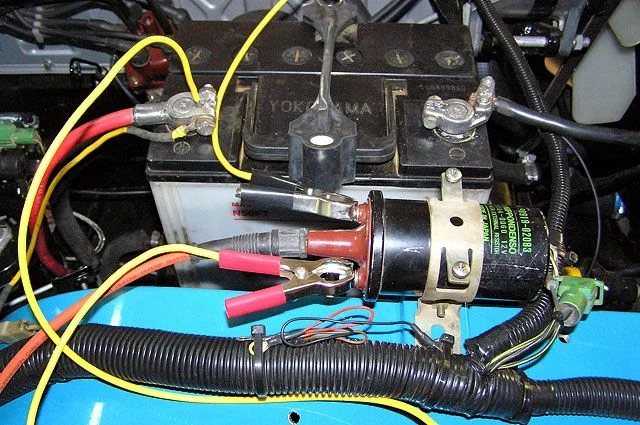

My thoughts as well. Here's what I've done: disconnect everything from the coil, attach a temp lead from battery + to coil +, and temp lead with a bare end to the coil -. Then I hold the HV lead about 3-4mm from the valve cover, and touch the - lead bare end to a ground. I get a nice strong blue spark at the - lead where I ground it, but nothing from the HV lead. I expected to see a spark there, but have not, with either of the coils I have tested this way (original and new after market).
Perhaps, I need to hold the HV lead to another ground? I figured the aluminum valve cover would be enough, but didn't think about the valve cover gasket until just now :doh: Maybe that insulates the valve cover. I'll try a different ground in the morning. The head and block were just painted, so I did not think to use that as a ground. I'll let you know what happens in the morning.

you mentioned the coil not being for electronic ignition? Not sure if that is okay or not we mix and match on FJs like no other vehicle!
I would ask some more on that.
Coils do not go bad often but it does happen and not using a BR when one is required would speed the process. A short could also do it. spark from the neg wire but not HT means the secondary winding is bad or your ground for the wire was bad or the HT wire is bad (that would explain more than one coil eh?)

Thanks again for the quick response. The coil I started out with was the one I had in the mule for as long as I remember. That's the one I took the picture of - "for use with external resistor". I have never had a resistor on it that I can remember. Of course, my memory is no guarantee it did not ever have one :rolleyes: The main difference I saw in the two coils at the shop Saturday was one has the ceramic pack resistor and is painted black. The other does not have the resistor, is painted red, and has additional flat blade terminals on the + and - posts. And it costs a little more than double what the first one does.
Which post does the resistor connect to if I need to use it? I presume it needs to be grounded as well? I have no manuals that show a resistor - the Haynes manual does not and the FSM does not.

BIG BRIGHT blue spark, with a good snap, from the - lead. This is what I was expecting from the HT lead, but it snuck out the side door :)
My test set up is/was as simple as I can make it - the coil, bare, with battery + to coil +, temp lead to coil -, with bare end for grounding/touching to ground, and HT lead held close to the valve cover with insulated pliers (I've done the bare hands thing way too often :o ). I touch the - lead to a good ground quickly and get a great spark there, but nothing from the HT lead. I have been using my valve cover for the HT lead - maybe the gasket and rubber seals at the top isolate it from the head sufficiently to make it a poor choice. I will try a different ground this a.m. This is what caused me to suspect the HT lead. But, it shows 14K ohms; the FSM says anything < 25K ohms is good, so I have been assuming the lead is good.

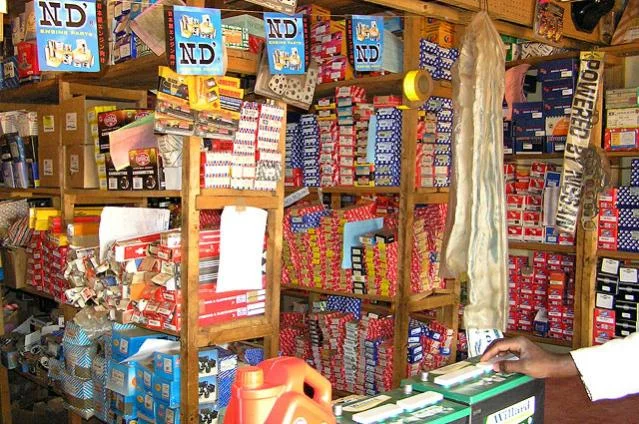

Since the coils still tested out so close, I decided to go back to Old Town (Sunday - only 2-3 places open) and see if I could find a HT lead I could use to test again.
So... Off to Green Motor Spares. No wires available quite the same length as what I needed. But HT is HT, right? So, I bought a set of leads for a 4-banger (nothing available for a 6 cylinder), figuring that at least one of the spark plugs leads was long enough to reach from the coil to the distributor.
BTW, most of those parts are for diesels. Green keeps a small stock of spares for petrol engines.
