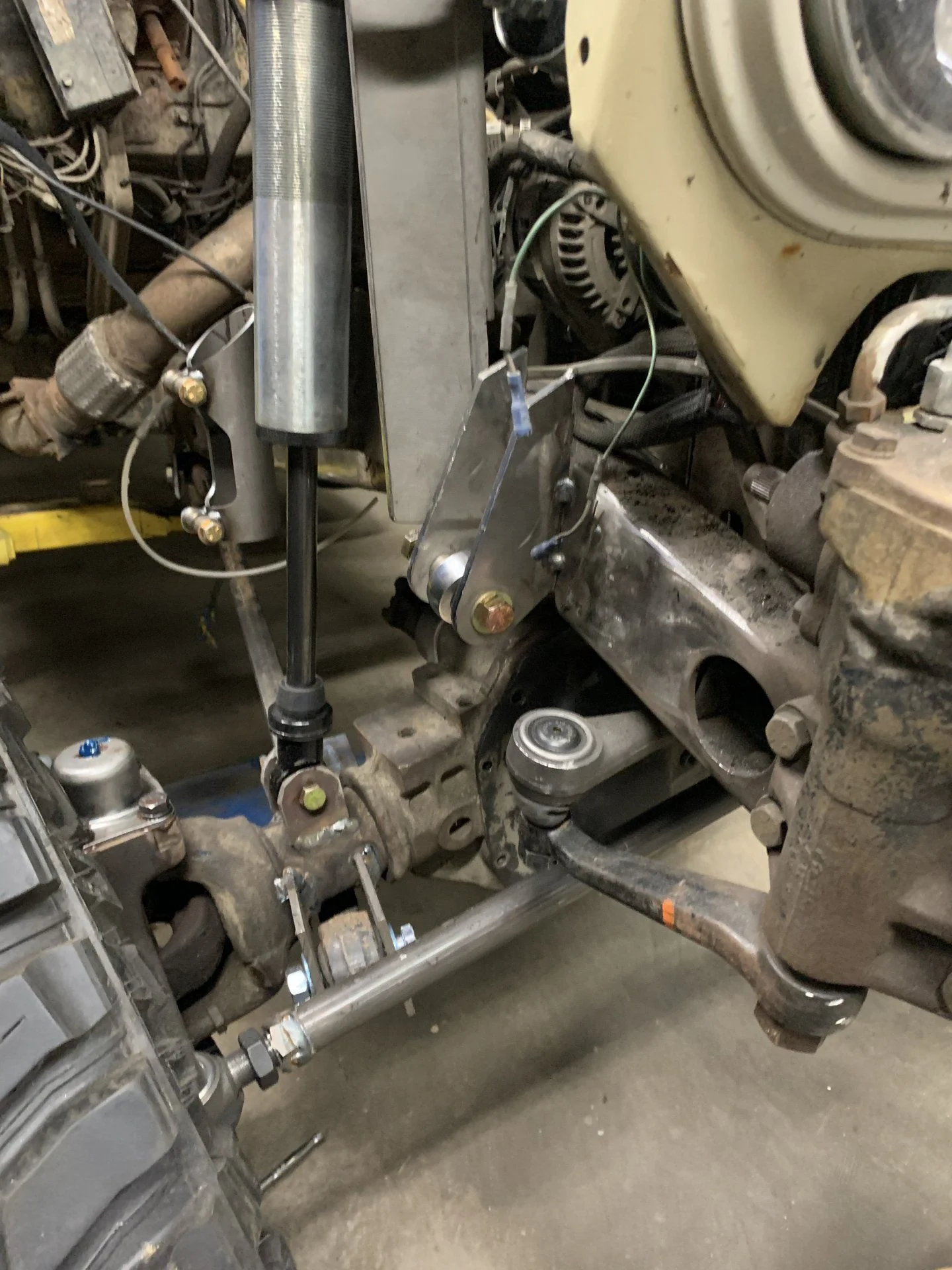

Sunday was another good day. After moving the axle side panhard mount I had just a little more clearancing on the frame to do. That made me move the mount one last time to get it right where I wanted. Seems to be good now!
Paul came by to have a look. Once we starred at it a while we decided enough was enough..... We pulled the axle out again so that final welding can take place. Made a plan for some frame reinforcements and braces too. This frame has had a hard life with quite a few patches and welds already...

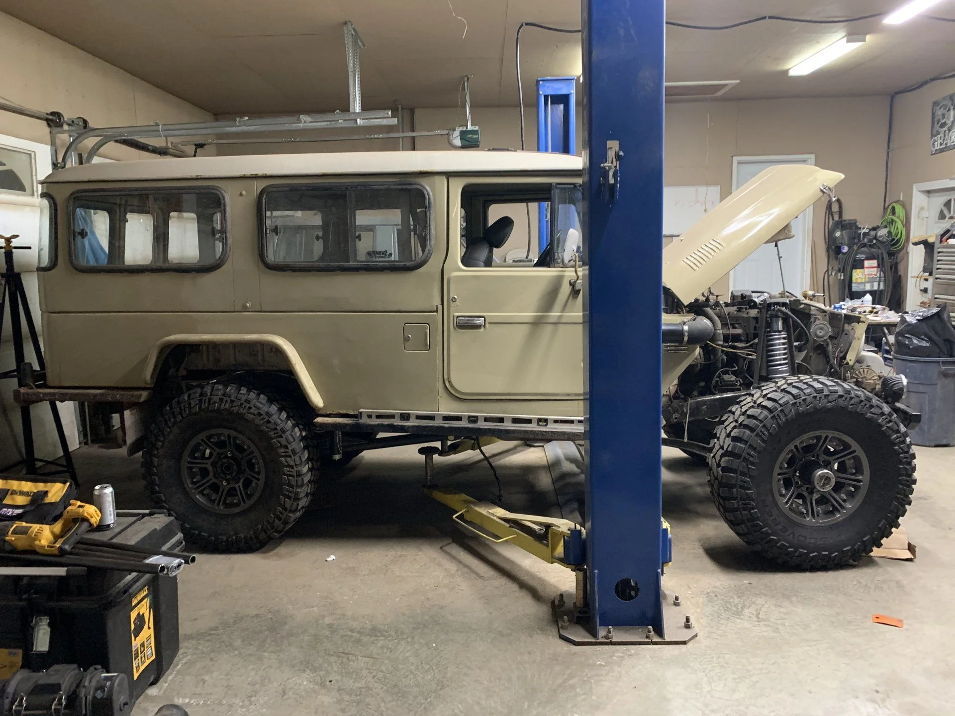

Next we tackled some front body mounts that I suspected has collapsed some. The doors haven't fit right for ever and after a month on the hoist they nearly wouldn't close. We remove the front bolts and lifted those mounts to slide in a space..... NIGHT AND DAY DIFFERENCE..... the doors line up better... shut better and gaps look better. So happy and im kicking myself for not doing this ages ago....

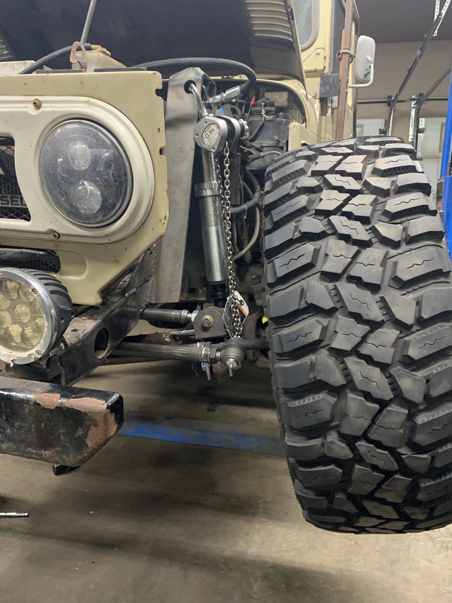

Looked at my air filter housing too and where to mount it.... the towers for he coil overs made everything even more snug than before....

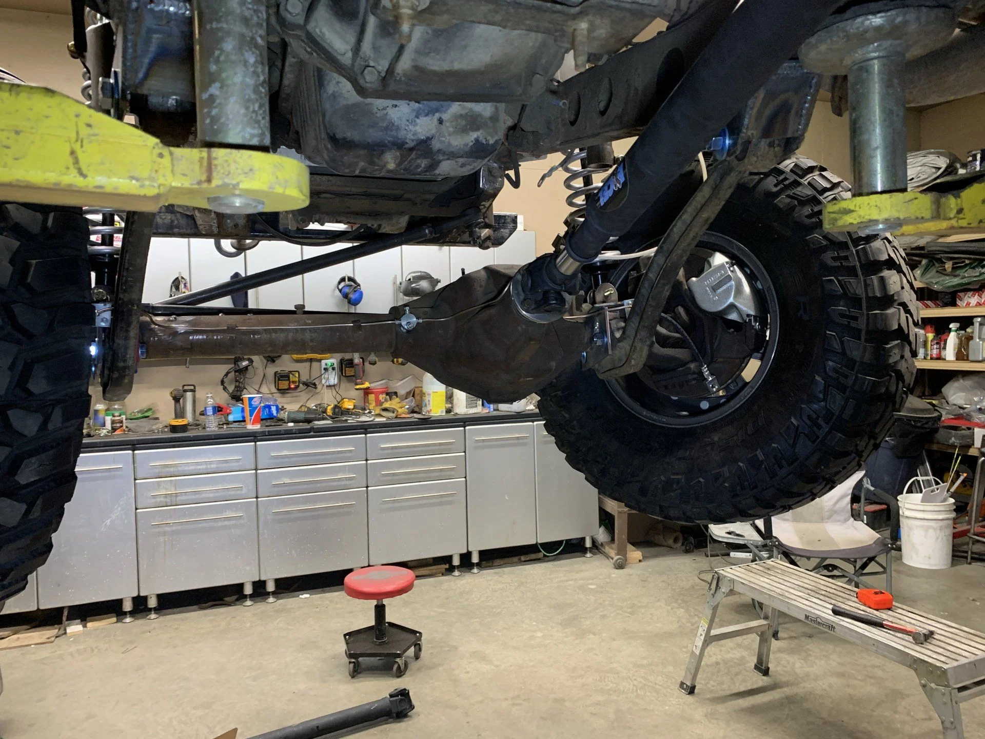

Welding in the front end. As best I can!

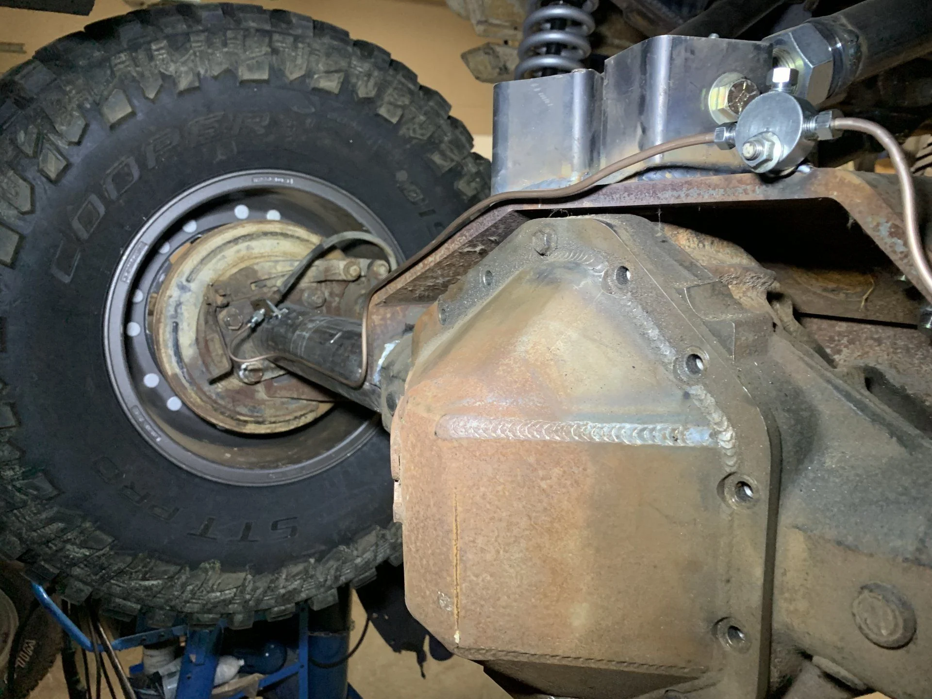

Plated the inside of the frame and got the notched sections cleaned up. Should be laughing now.

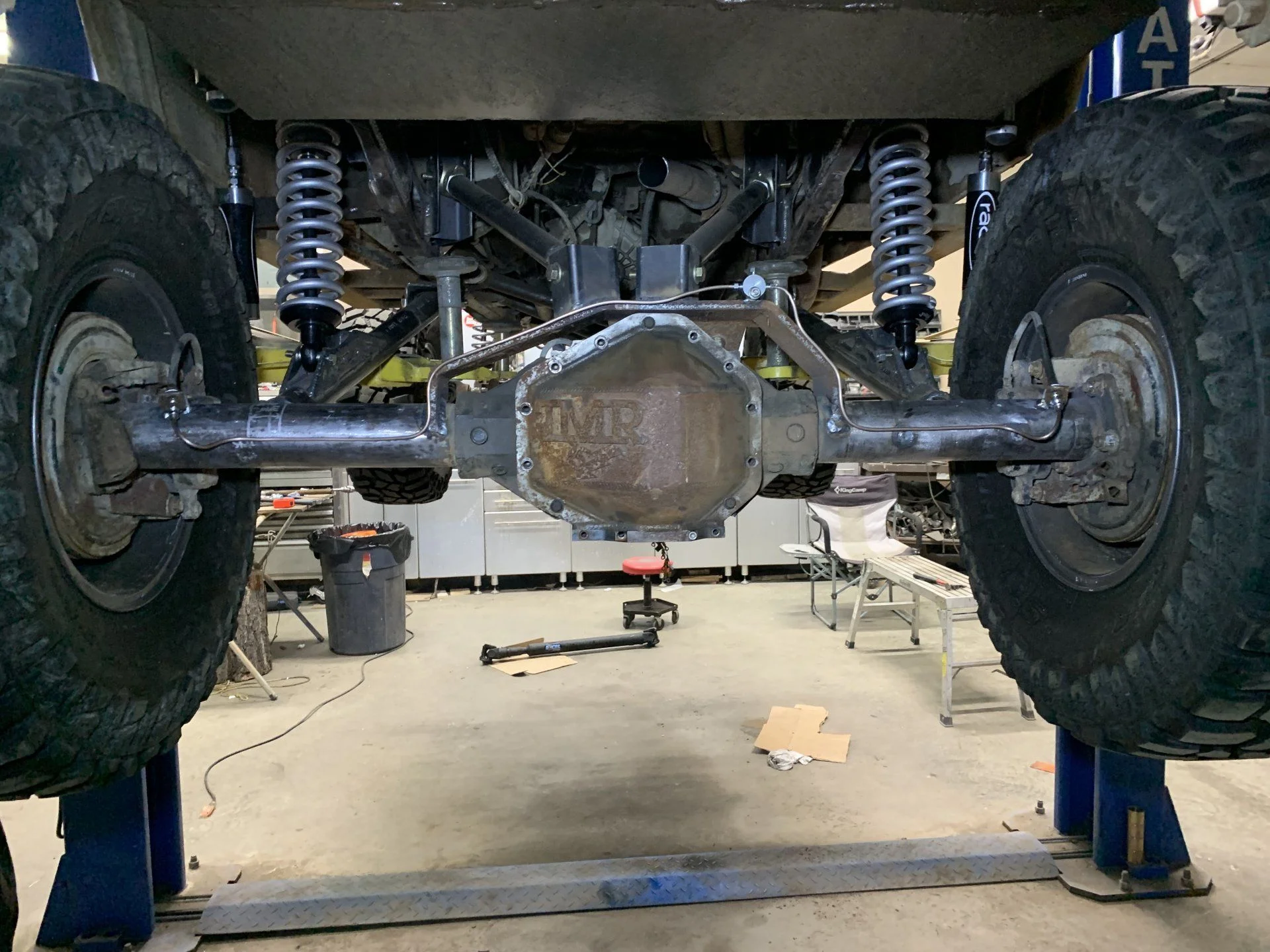

Axle is back under with all but the last tower welded out. Need to wait until I get my steering shaft double confirmed and then I’ll be set.
all the frame notches and cleaned up patches look pretty good. Should be as strong as ever.

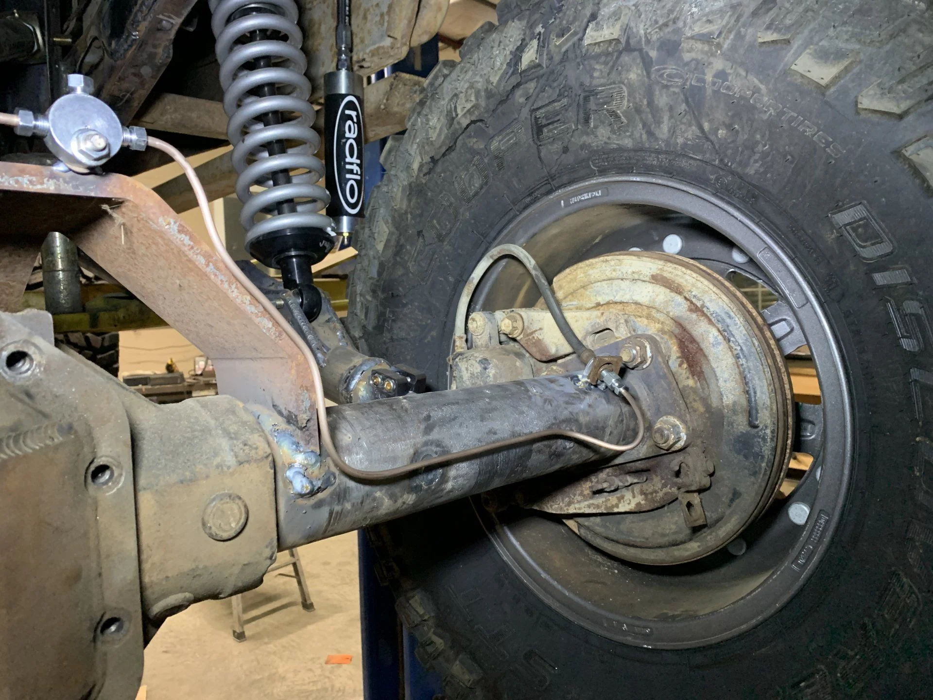

got new calipers and pads installed on front axle but am struggling to get the right banjo bolt for them. Ordered all my other brake plumbing. it will be converted to the familiar metric fittings everywhere I can as thats what i have around most of the time. Hoping to get brakes going soon.....

A long time coming. It’s in its own weight and springs tonight. Pretty cool to finally get here.

Back in the saddle tonight. Tackled the brake line plumber for all but the axle to frame lines. Should have those soon but I ordered hella long extended ones. Bought a whizzy new line flare tool that has changed my life. Must have tool for brake line work.
