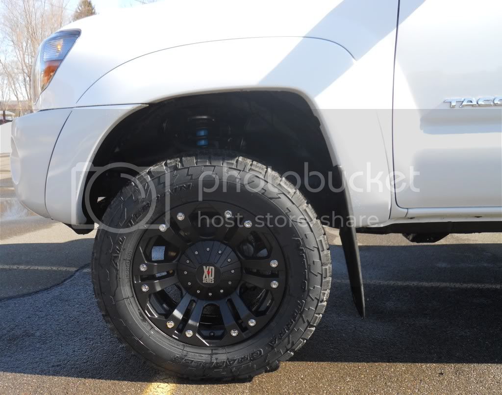

So I am now thinking either go with some TRD wheels and some sort of mild AT tire like maybe the BFG rugged terrains. Or maybe go aftermarket and use some XD wheels like these.
What are some of the pro's and cons to the TRD wheels vs aftermarket like shown above. I am guessing some companies offer after market wheels that are hub centric or sell the rings to make them function like they are Hub centric.
How does the RIM width compare on the OEM to the TRD wheels. I know someone mentioned you pickup about 10mm of offset. I am thinking that's really not enough to get them close to flush . My 1.25" spacers and OE wheels were very close to flush. Is the TRD wheel only sold in the +50 offset?

Billfish are your XDs hubcentric?
The one I posted a pic of above is the one I like. Looks similar to you wheels in your avatar, are they the same ? What size of tire are you running ?
