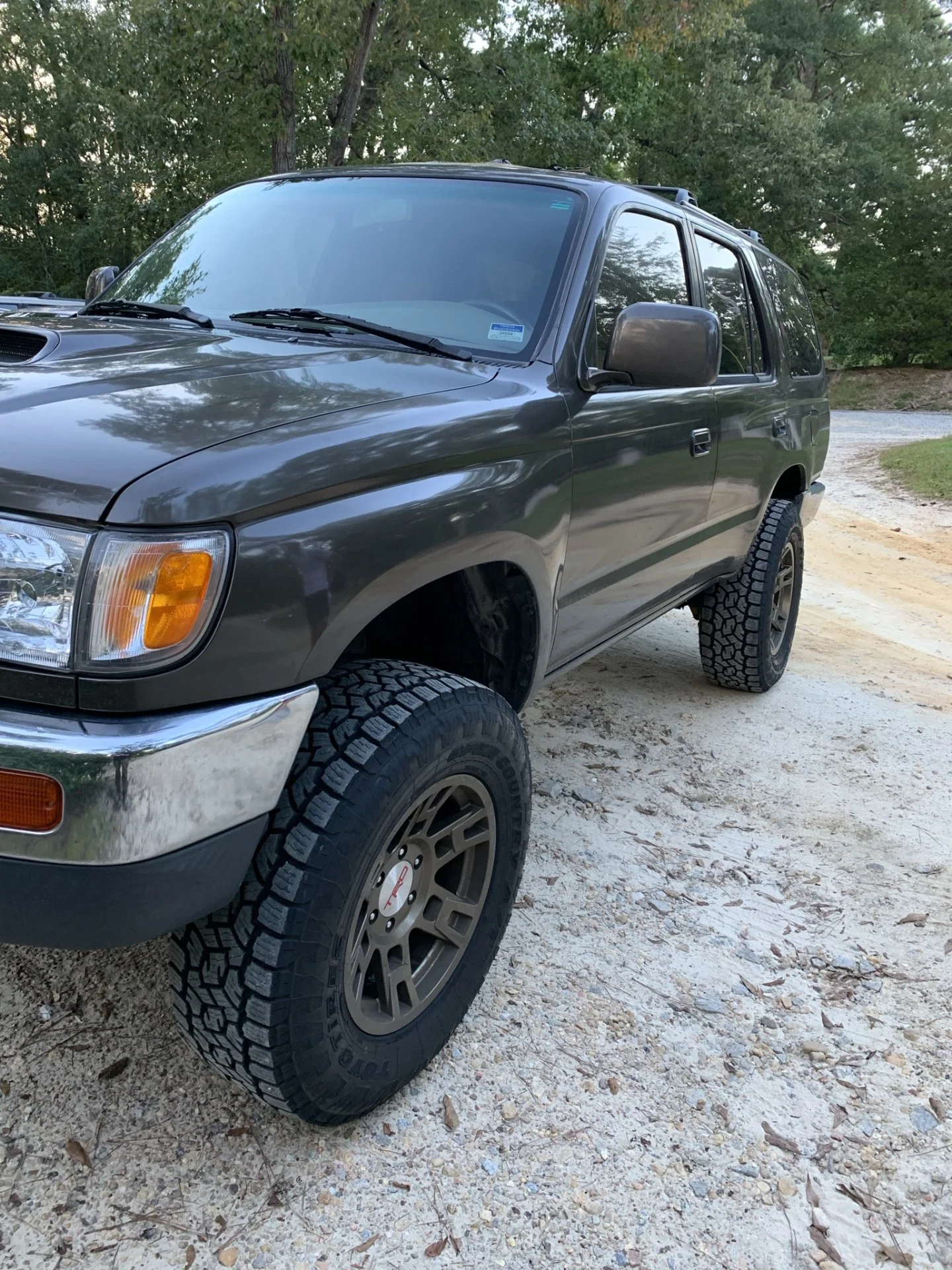

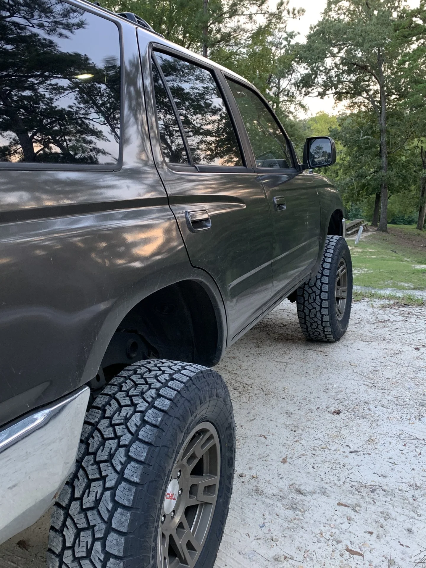

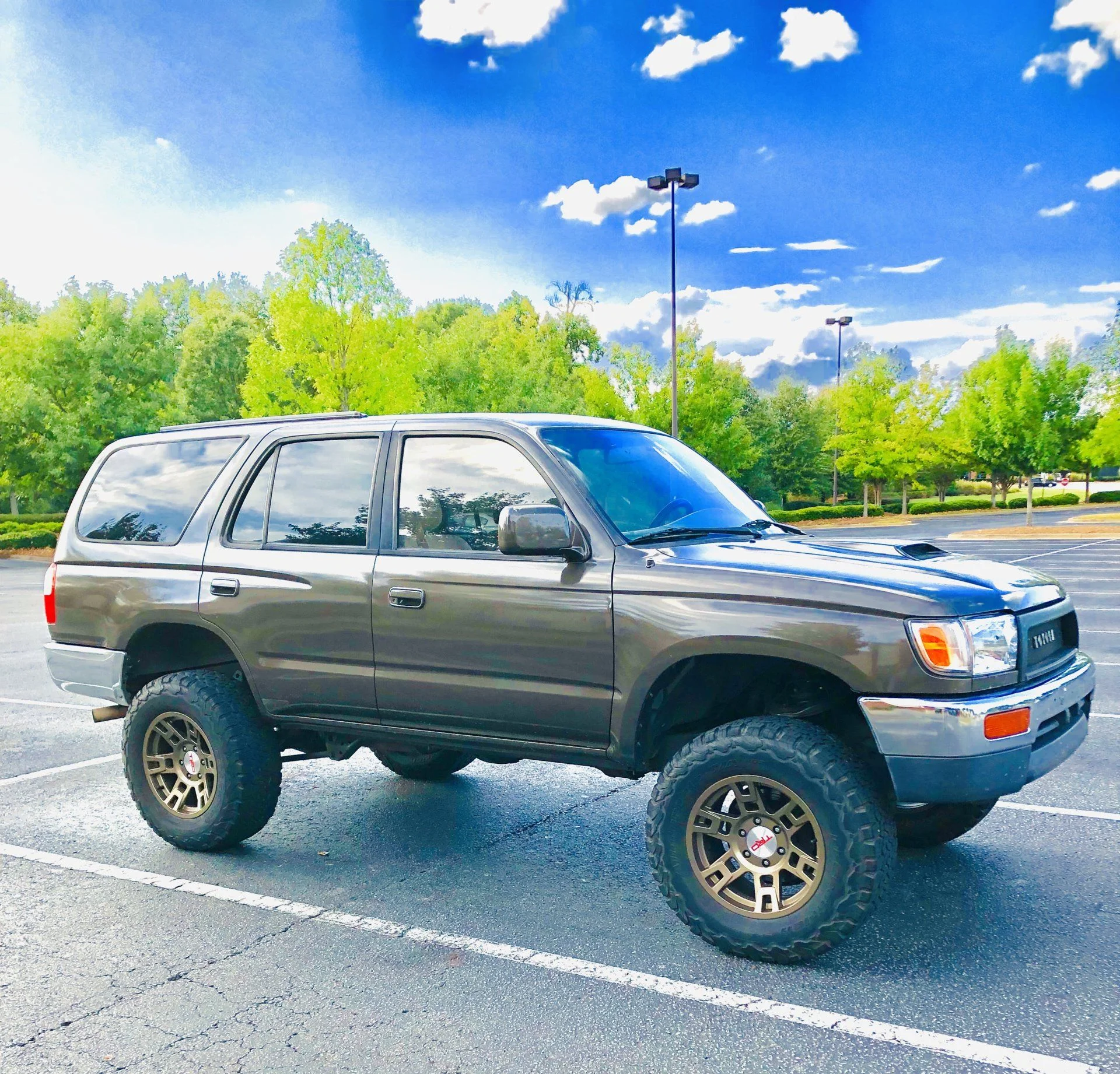

I've searched here and on the 4Runner specific forums. I have a 1998 (came stock with 16" alloys) that I am currently running 17" FJ Cruiser alloys (no mods/no spacers)...pictured top.

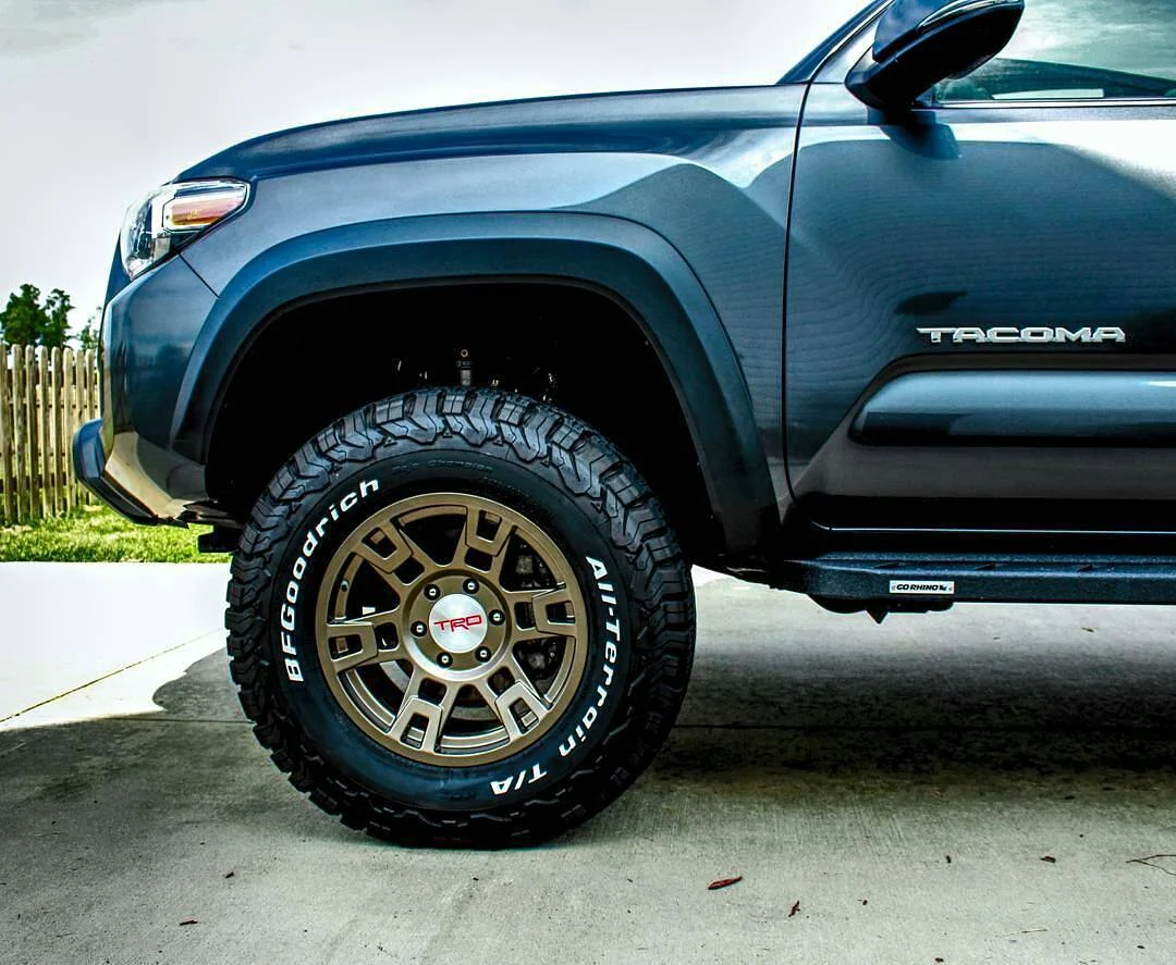

When I browse the 17" TRD Pro wheels pictured second, eBay and Slee's site both indicate that they are incompatable with 3rd Gen 4Runners. The only reason I could think of would be backspacing.

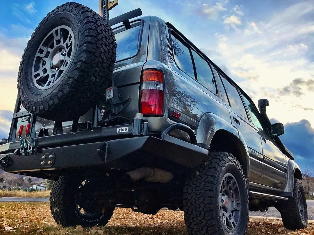

Those are one of few OE wheels I flat love! - I need to find a set for the 80, seems 16" wheels are getting too small for many tire brands to want to go ~35" or better.
I know for 80's it's just a set of spacers & you're gold - I am not versed what it takes to run FJC wheels on a Taco.

The PRO wheels do fit. This is without spacer. Tires are bfg ko2 285/70/17 with bilstein shocks and OME springs. Not sure why they would say they won't fit. But trust me they do without any problems.
This was the response I was looking for. Thanks for taking the time shadowless.
