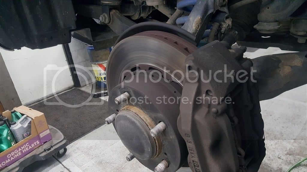

ggroot30, I have not had success with the TRD pads but it might just be my vehicle or something. I have replacement rotors and pads on order and everything should be upgraded next week. I am going to a two piece floating dimpled front set of rotors. Rears will be dimpled and slotted. I'll update once everything is installed.
Solid brake upgrade

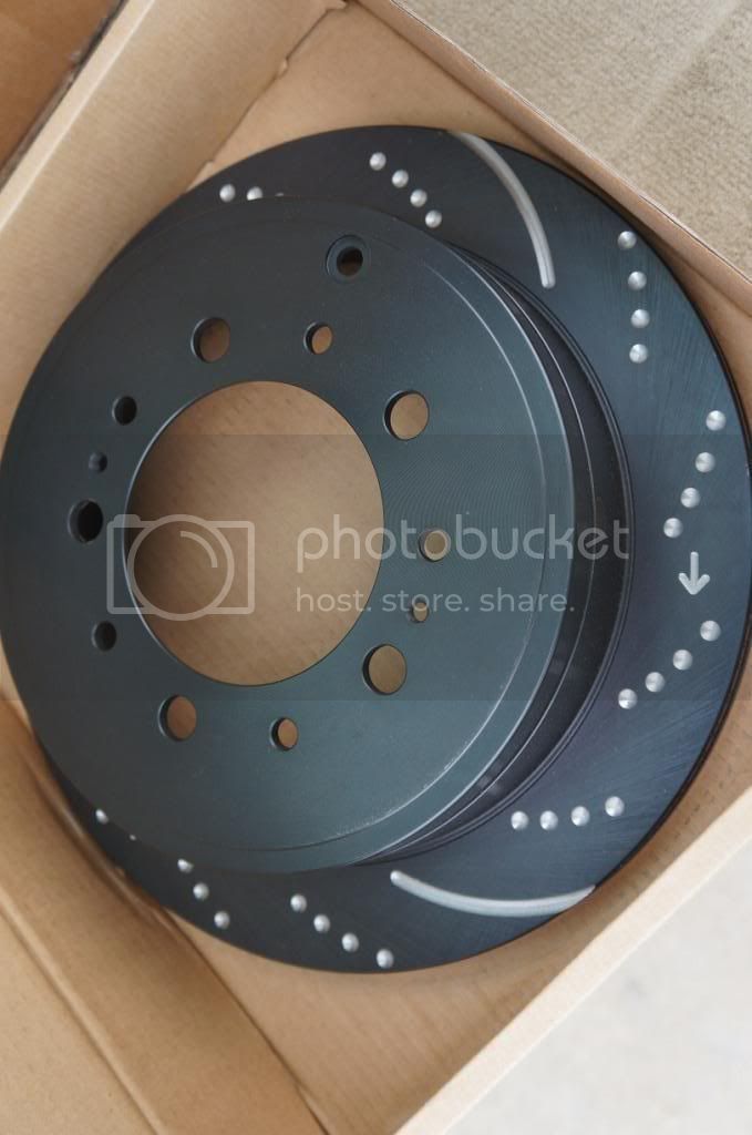

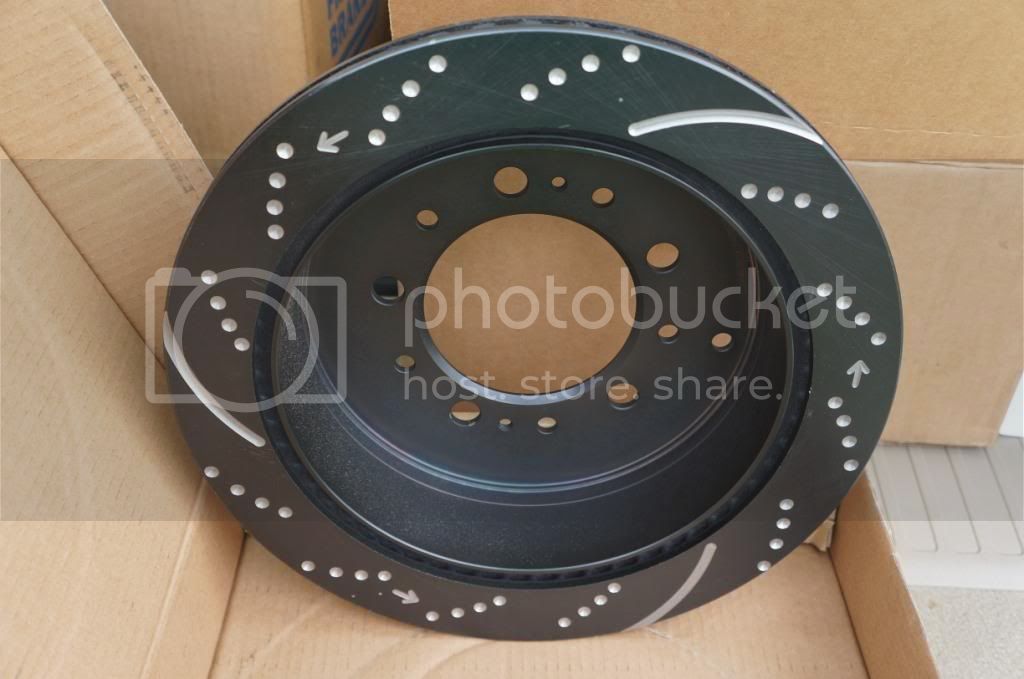

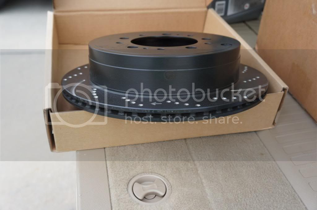

Here are some pictures of the rotors in the boxes. The brakes are installed and they work really really well. I'll get some pictures of them installed once I have the truck cleaned up.

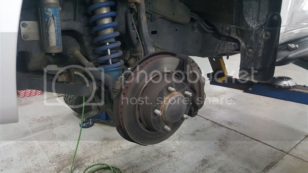

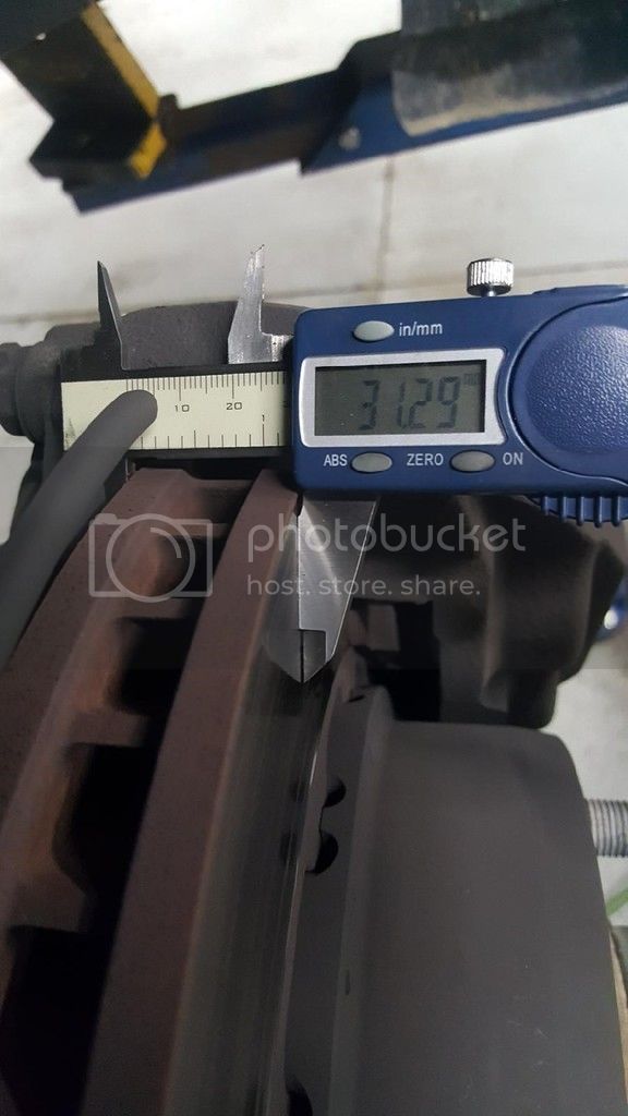

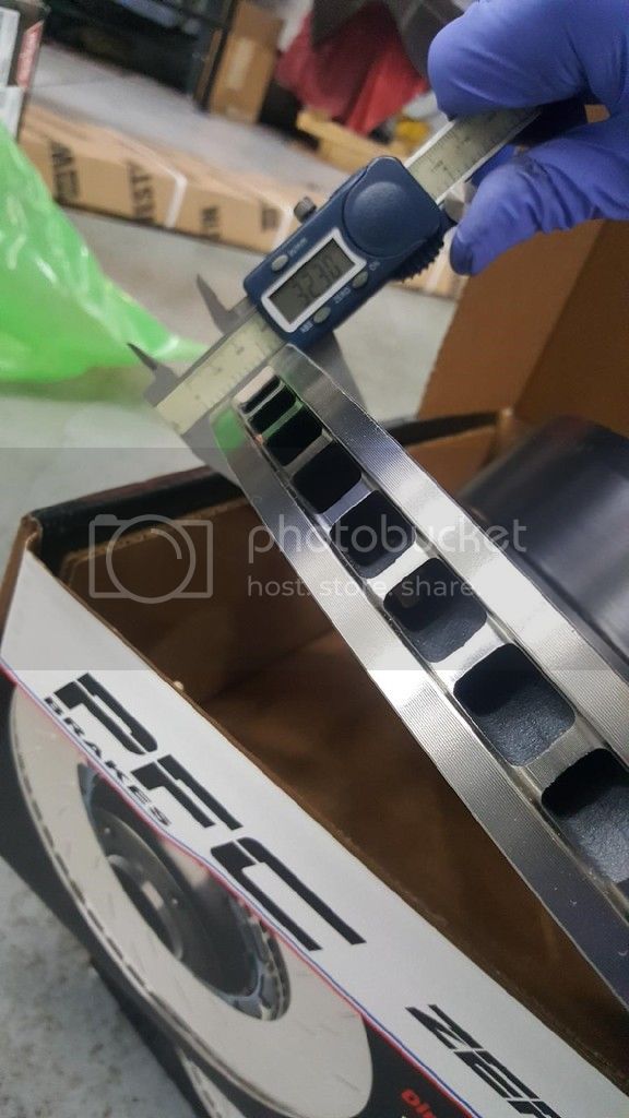

After six years and over 80,000 miles I'm replacing the brake rotors. I have been very impressed with the set up. I just replaced the rear pads, no turning. The front, I'm replacing the rotors while I work up a solution to turn the floating 2-piece rotors. Only lost 1mm after all those miles. These are the brakes that were developed for the SOCOM Non-Standard Combat Vehicle Contract. My LC200 isn't nearly the weight of an up armored variant but I'm pushing a lot more power.

Where did you get them? Can you share part numbers and manufacturer?
What’s the improvement over stock? Cold stopping distance improved? Better heat dissipation/less fade? Just no warping?

I'm sure the Non-Stand Combat Vehicle program office has data but unfortunately I don't have access to it. Just personal experience. I like them so much I bought up the remaining inventory to offer them here. I fought brake rotors warping for months until I switched to these. Six years and finally replaced them. They only lost 1mm in width so I'm investigating having a fixture built to resurface them. PFC recommends the Wagner semi-metallic or Bosch severe duty pads.
