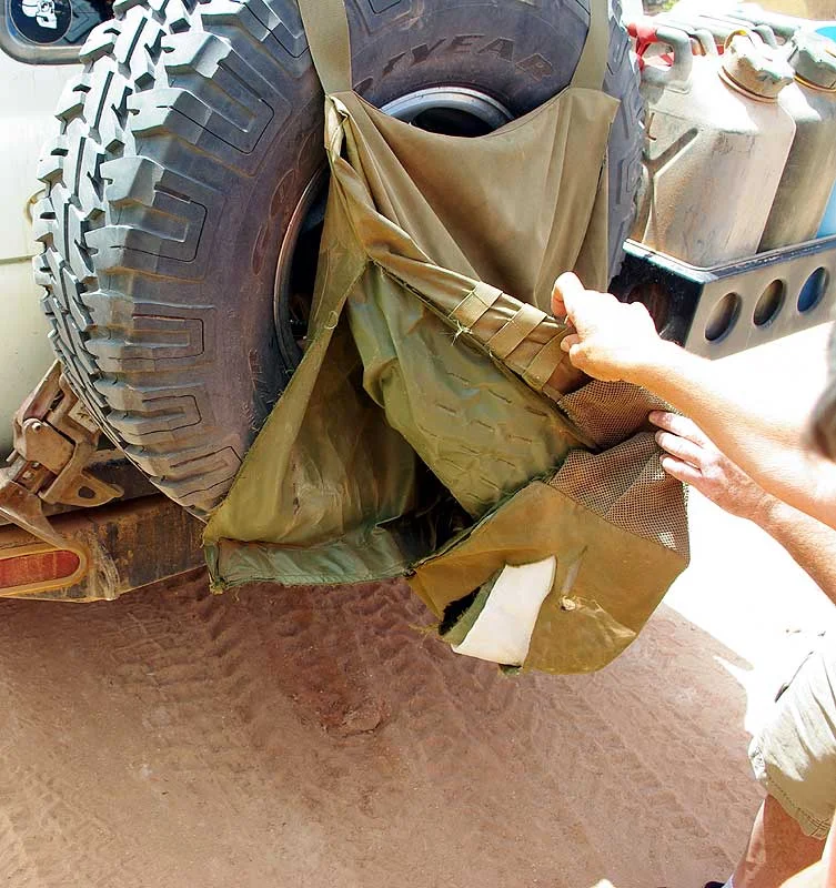

Those of you with the famous Trasharoo may relate to this. Mine kept rotating down and on couple of occasions, totally slipped off the tire. If it weren't for my buds following me and telling me what was happening, I'd have lost it for sure.
I normally place the straps in the "X" pattern across the spare tire but the top of the straps would spread and over time simply slip off the tire. My spare tire is normally covered with a tire cover and the slippery surface only exasperated this issue. Those of you with M/Ts may not have this issue due to the large lugs.
The mod consist of sewing on extra strap across the top that helps with the prevention of the straps spreading apart. As a bonus, another strap with buckles to really locate the unit properly. This is not needed, but following the mantra "while I was in there....". This extra strap keeps the unit put, regardless how much crap is in the bag :D
Let me know if you have any questions.

Hey David,
Yup, I've had to do that quite a few times, especially when it's wet. I've spoken to Dave from Trasharoo about this mod and I think it's on their "to do" list. Similar unit from Oz has this top strap from the factory so I think it's a necessary item.
Furthermore, having this top strap negates the need for tightening the two vertical straps "mo fo tight", LOL!

that would not happen if you find a way to keep it hi mounted on the tire .. that's why I'm trying to do ..
