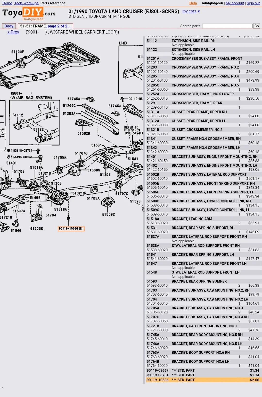

I have used Yoshi Parts. Some how I came across this site after I recently tourqed the AT Skid plate bolts per the manual to 22Ft/LBS and snapped one off in the crossmember.,after draining the ATF and putting the A/T skid plate back on.
I believe you are in search of the 8, Transmission crossmember bolts and are all 14mm heads. The part number is 90119-10586 and are roughly $4.00/per.
Hope this helps and have a nice day..

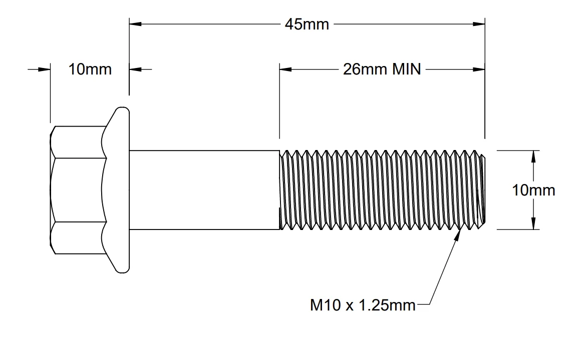

I have replaced mine several times due to rock damage. McMaster has them in packs of 10 for about $9. McMaster part #95735A645. M10x1.25x45mm, JIS 14mm head, JIS High-Strength Steel Flanged Hex Head Screws.
91116A390 are oversized stainless steel washers.
@jonheld Thank you. Definitely a better price! Just to confirm - that 45mm length part number comes up as partially threaded - that works okay with the unthreaded shank not being too long?
No issue on mine, but I'm running the IPOR belly pan plus a custom cat skid plate.
Measure your existing bolts and use your judgement.
