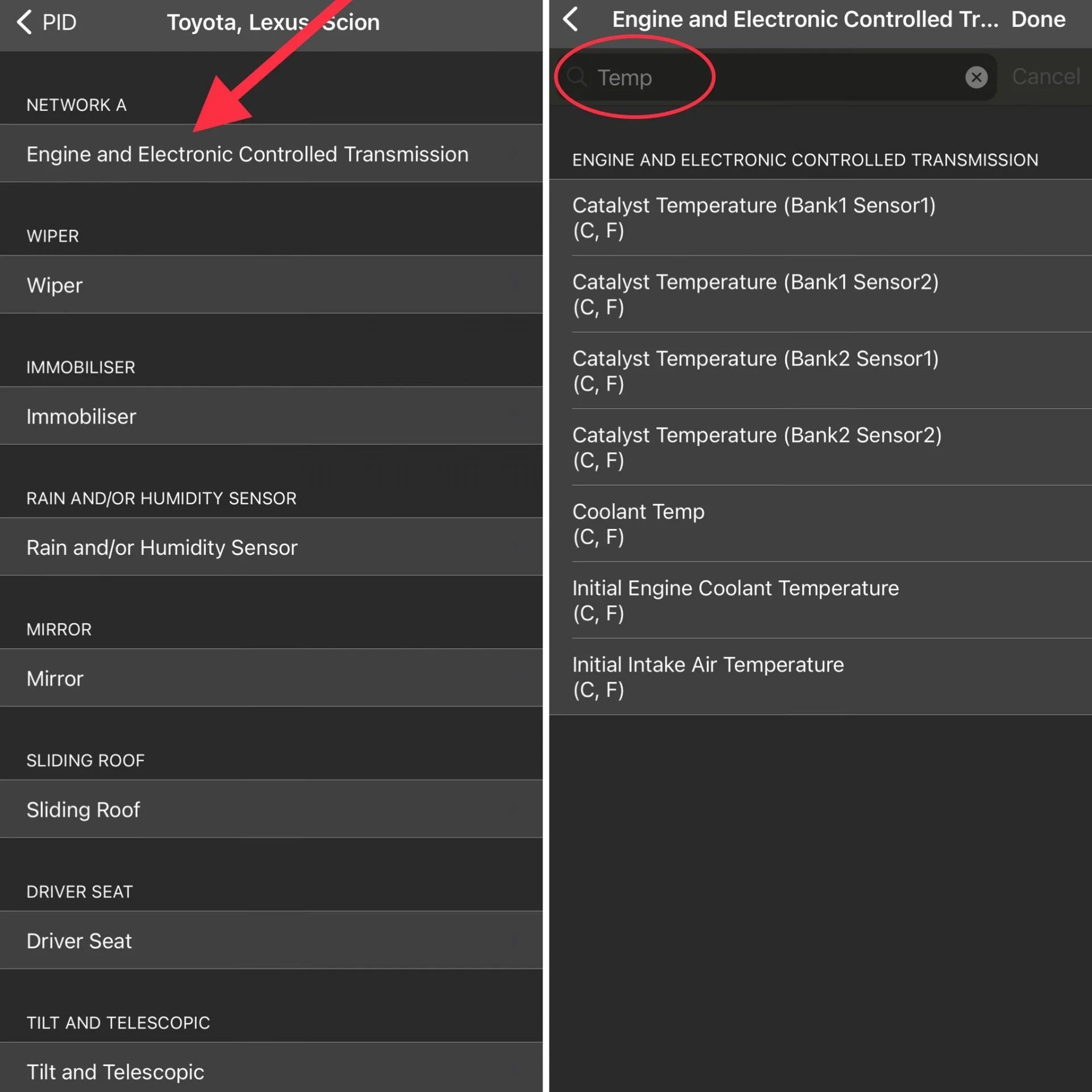

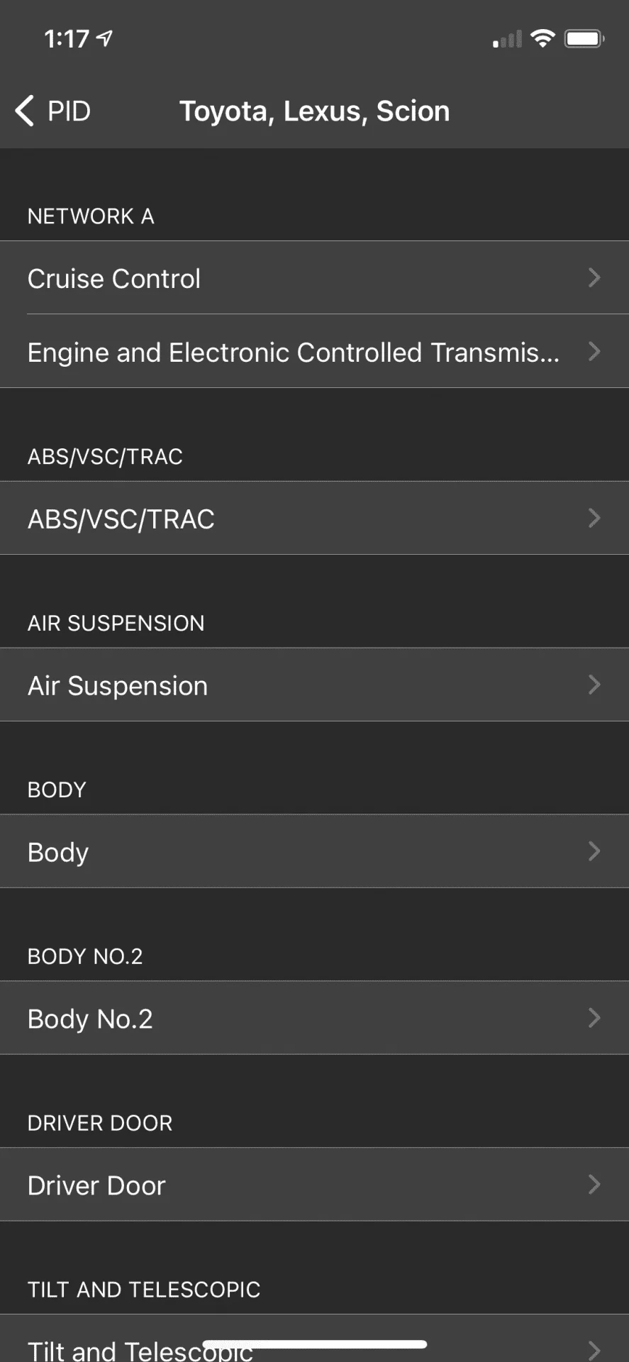

This is how mine looks:

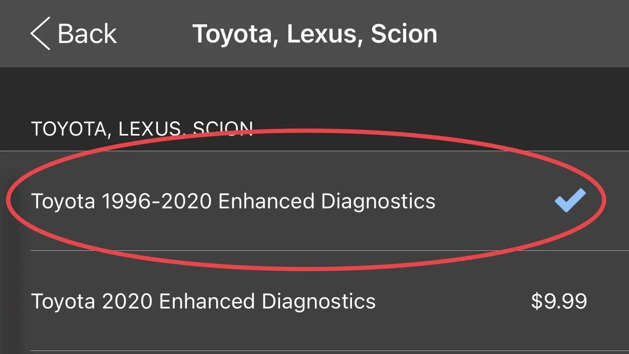

Before I bought the enhancement, I contacted them and they confirmed that they had the A/T temps for my vehicle. I suggest that you inquire. If they say that it is in the 2006 enhancement, I would ask them how to access it. Perhaps you need to uninstall and reinstall the app?

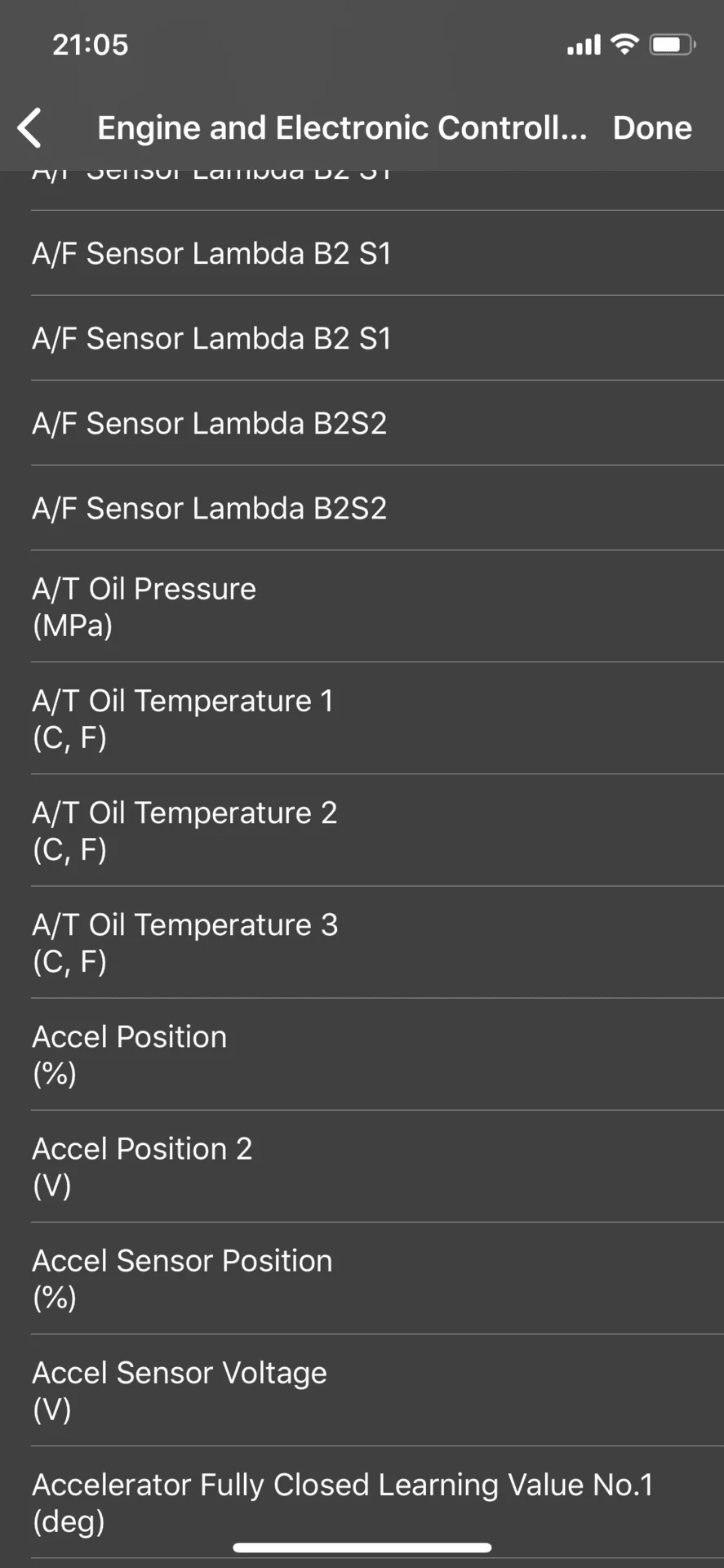

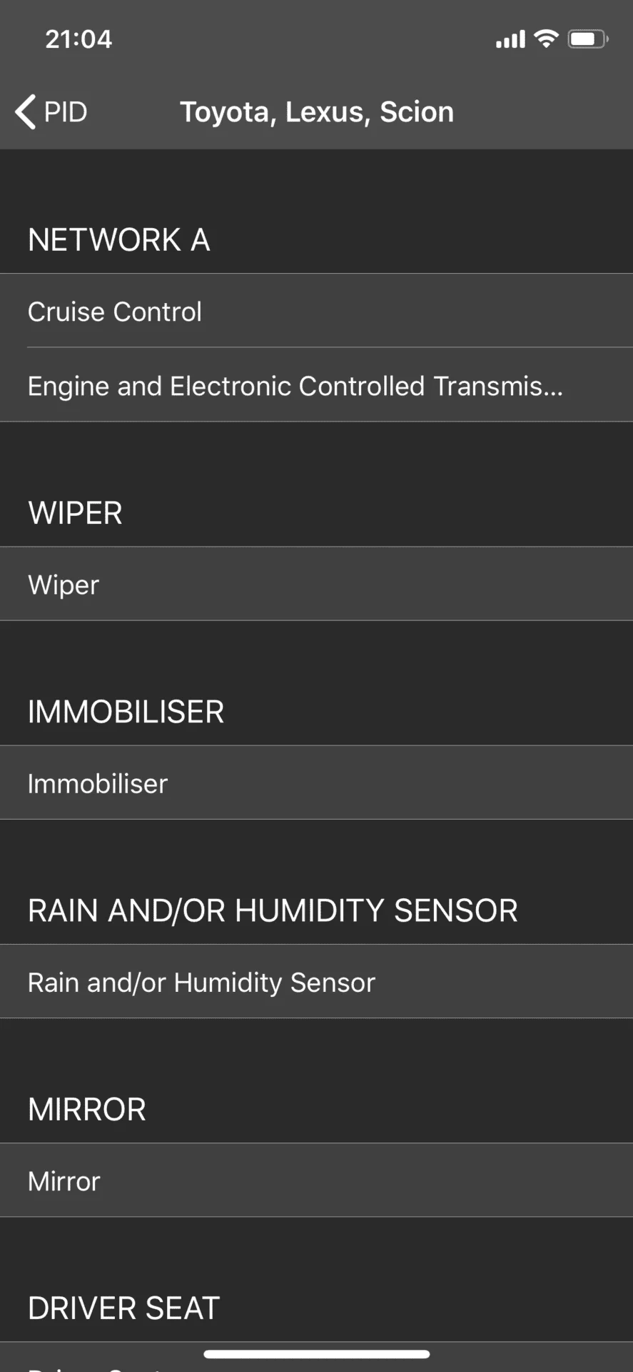

I reached out to them yesterday and they suggested performing a PID rescan under the vehicle editor. Did that twice as well as deleting and reinstalling the App and still nothing, no A/T Oil Pressure or A/T Oil Temperature 1, 2, & 3 options. Strange considering the 2005 and 2006 GX's should mechanically be the same...

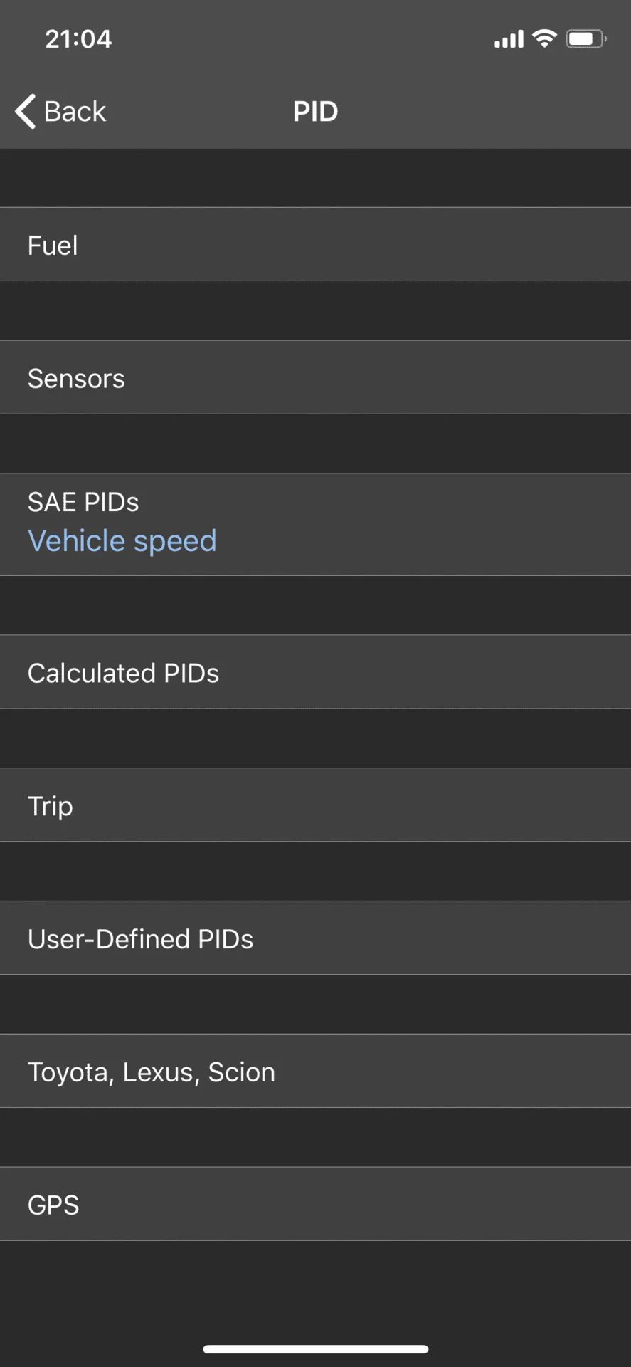

I am using the VeePeak WiFi OBD2 dongle as well on my iPhone. However I do not see the automatic transmission temperature PID on the list even if I got the full pack.
Any ideas and inputs are appreciated. I hope I didn’t waste 70 bucks on a software that doesn’t really have what I need - the AT fluid temp live data display. :bang::doh:

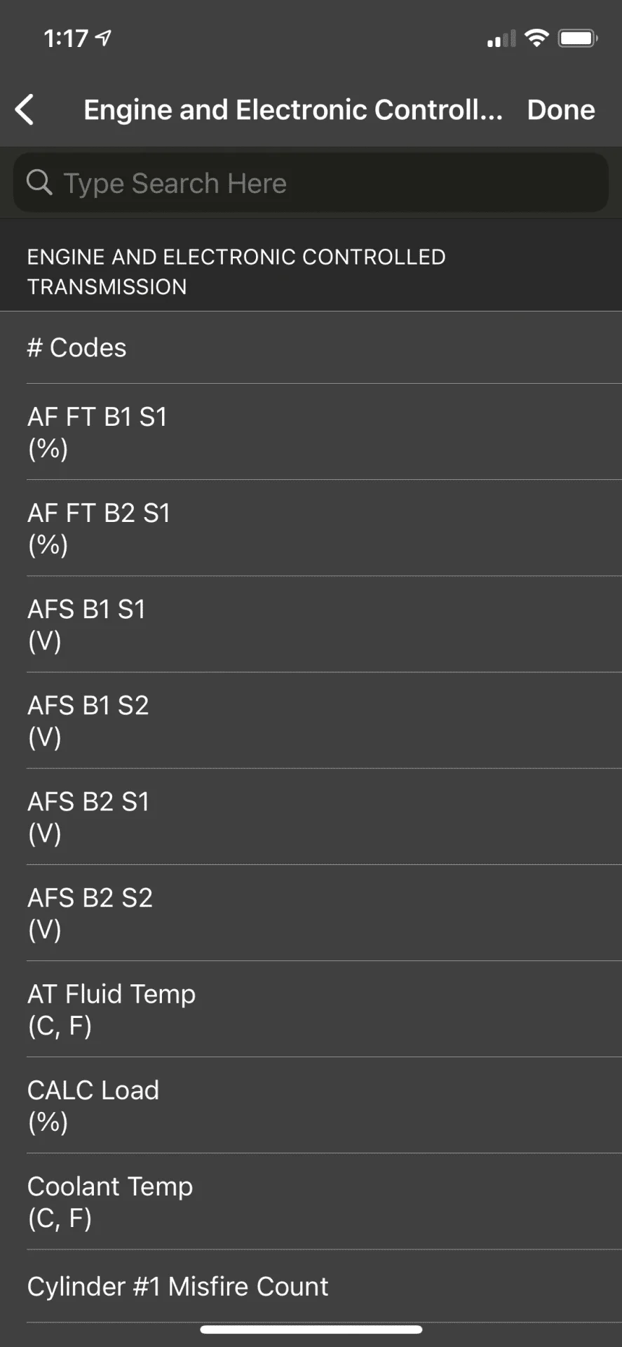

I have OBD Fusion and they are here:
just checked it now and still not have the AT Fluid Temp. Their support team sent me an email and followed it down to the last step and still have no AT fluid temp at this point.

Can you please try adding the initialization commands shown below to the app at Settings > Preferences > Advanced under the Interface Initialization > Commands section?
ATAT0,ATST64
After doing this, follow the instructions below:
  1. Open the Settings > Preferences > General page and select “Debugging Enabled”.
  2. Open Settings > Vehicle Editor and change the Enhanced Network Select option to Prompt.
  3. Go back to the main page, then click the Home button to exit.
  4. Close the application by double-clicking the home button, finding the OBD Fusion app using the app switcher, and swiping the picture of the app up.
  5. Restart the app.
  6. Connect to the scan tool on the network with the Engine and ECT module, and open the Settings > Vehicle Editor and tap the Rescan Supported PIDs button and wait for the PID scan to complete.
  7. Go to the Logs > Messages page, select the menu button, and select “Send Debug Info”.
Thanks,
Nathan

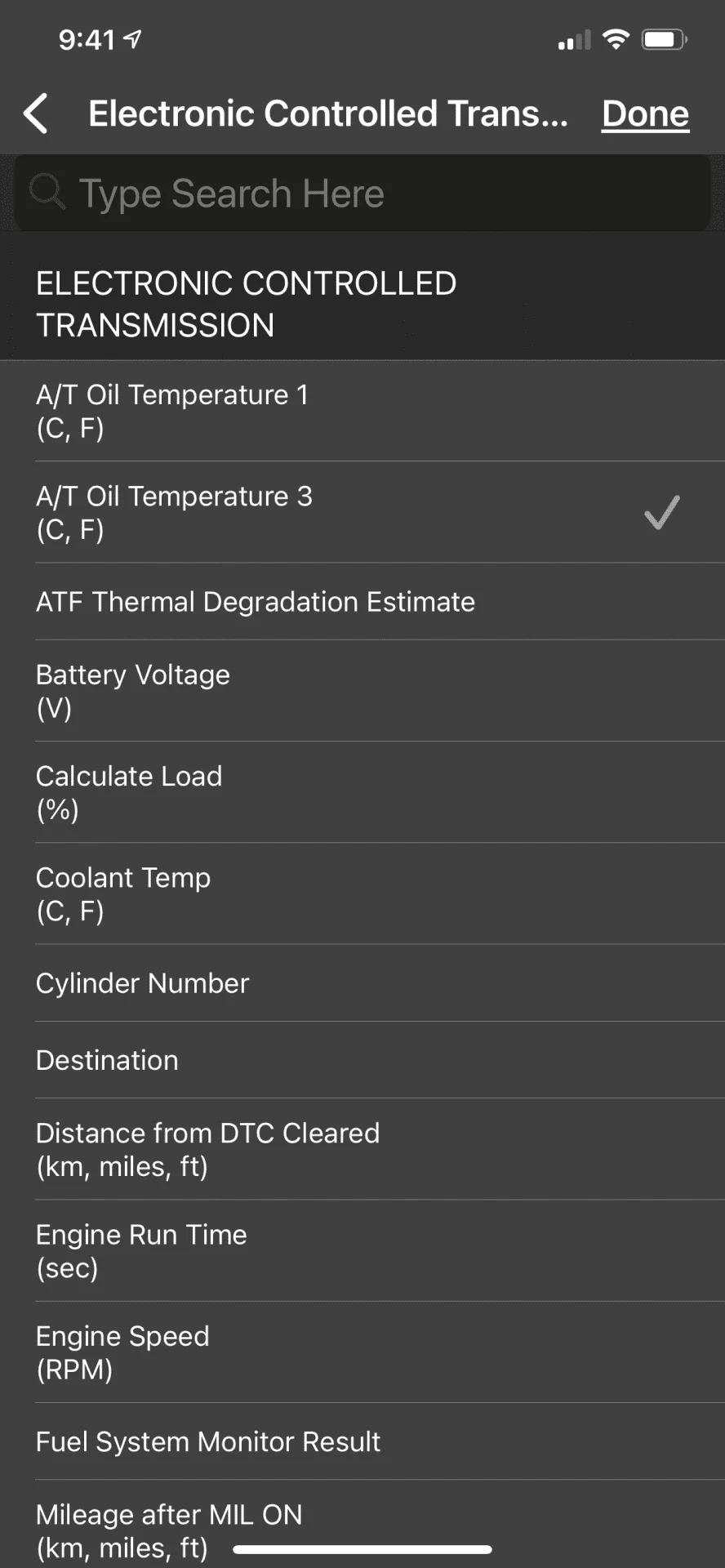

I’m using the OBDLink MX+ adapter which comes with a Toyota/Lexus PID set.
There are two transmission oil temperature PIDs, temperature “1” and temperature “3”. The app doesn’t show PID numbers, just descriptions.
Does anyone know which is the pan and which is the converter? I added both to my dashboard but the “3” shows readings that vary from 0 to 100 degrees which can’t be correct. “1” shows temps that are realistic, around 190 degrees.
