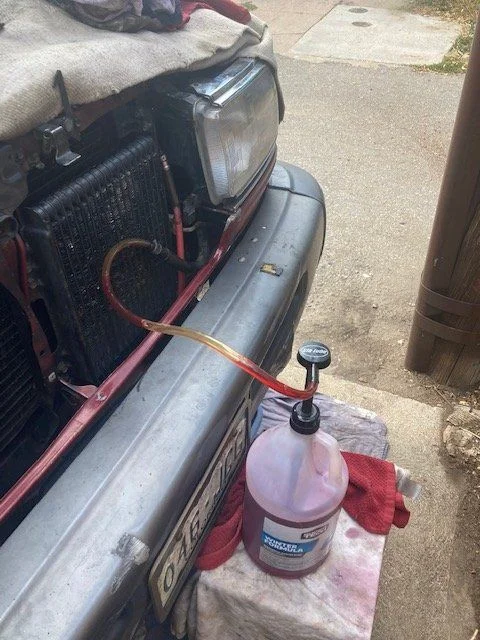

The A343F tranny issue. I reviewed I see a post of mine from last March.
Follow up to code light and overall tranny.
Code light indicated solenoid issue. Ordered a solenoid knowing it took three but the prices were up there.
Last question to the shop " Will I need to reset the computer for light to go out?"
It should go out after a few cycles if fixed or you can come by.
My plan was to remove pan and install new solenoids.
Why put new solenoids in old fluid. Change the fluid to clean for the new solenoids. YKNOT, grit in new is not good.
Drained what would come out, A Gallon. Now we know it holds more but other technique required to remove all.
Poured a Gallon back in and Daughter drove off. Comes home, "Dad the Light went off".
The one gallon made a difference in diluting the old for solenoids to work better possibly.
Did the major power flush with Wife, daughter and myself to flush out the tranny completely.
AS ANOTHER MUD MEMBER SAID " NOTHING LIKE WATCHING THAT BROWN FLOW OUT AND RED FLOW IN".
Certainly a worth while job for our FZJ80 @ 300,000.
My daughter ran the cruiser threw the gears. My wife pumped fluid in fill line after oil cooler and I poured in fluid through fill tube. We flushed about12-14 quarts, for a clean red line.
This lead to a complete baseline at 300,000 for all fluids. The cruiser runs better than ever, if it only didn't burn the oil.
Thanks for the great write up and IH8mud community input
