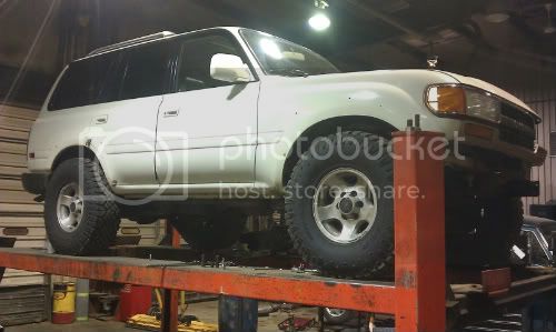

BACKGROUND
My nephew has a 1997 40th.
Great truck, he is the 3rd owner, 199,996 miles.
The truck runs and drives great, it had a slight vibration at 35 mph and then again at 65 mph that we attributed to needing a tune up.
Just ordered a tune up kit from ACC when the following happened.
Dopey nephew decides to go mud riding in his 7000# pig with 295 Terra Grapplers and gets it stuck as hell.
No one can verify what happens next but when I arrive home, the truck is in front of my shop with a broken front driveshaft.
I pull the driveshaft, turns out one of the "lifetime" joints in the front shaft...the one next to t-case broke up and took out the shaft.
When I get the truck, the long portion of the shaft is hanging and beat up from hitting the sway bar and the slip yoke is gone.
I pull the shaft and walla...the vibration is gone...
Not the spark plug wires like we thought, but it was the shaft because all vibrations are gone without the fornt shaft in the truck.
NOW TO THE TRANNY QUESTION....
OK, since said mud riding incident, the transmission in first and reverse slips. RPMS rev to 1500 or so then the tranny catches and it drives great, shifts great, runs great (no vibs)
The slip is there. It is bad, something is wrong. I can't get a real story out of the kid, so I am assuming he beat the crap out of it trying to get it unstuck and fried something. The tranny fluid smells new and looks new.
Here is the other thing...it won't go into park. It will shift into park, but the cog will not engage. I tried to adjust the linkage but that does not help.
So the questions I have are:
1) Are there any "quick fixes" like on the FJ62 tranny with a flush or anything that may get him some more miles out of this tranny with the slipping. It is a $5000 truck. Putting a $4000 tranny in it totally defeats the purpose.
2) What is the deal with Park? I adjusted the linkage with no help. Thoughts?
I need some answers because I need to advise the dad...my brother in law on what to do.
I never have heard of this problem with a late model 80 so I am looking to you guys for help.
Thanks!

The 35 mph vibration is an indication of drive shaft/ ujoint failure. The 65 mph is normally a tire balance problem. The unbalance could be caused by mud stuck on the backside of the rim or even a defective tire. A vibration is not a sign of needing a tune-up. An engine problem will be based upon changes in load not a set speed. A tune-up is always good if the components are aged and the MPG has degraded.
for what its worth, i just got done putting a transmission in my cruiser this weekend. mitchell on demand at work calls for 6.90 hours to do the job. i only had $450 in the transmission and i did it by myself in 9 hours on a lift taking my time. it wasnt that bad at all...pm me if you have any questions it is still fresh in my head.
i was lucky and was able to see the donor truck run and drive b4 the junkyard pulled the trans. trans has 100K less miles so i feel pretty good about it lasting.

The ujoint at the case died and when it fell out, the sway bar kept it off the road but it really beat it up. No way it will ever be balanced. Nice spare though. All I need it a slip yoke.
