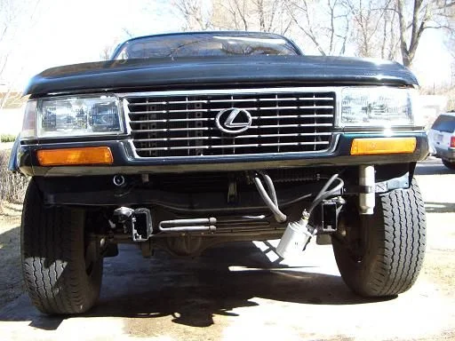

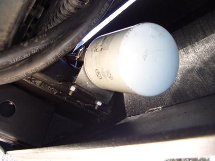

I took the liberty of putting a screw on filter in series with the line going into the trany cooler. just use a $15 3/4-16 thread remote filter adapter avail from summit racing.
I like the looks and sound of that. Got any more pics?

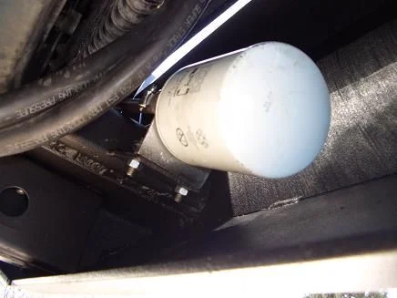

sorry friend these are all the pics i got. real easy to mount. i have mine inside my custom bumper now but orriginally i just made a simple bracket that bolted to those threaded 8.8 holes in the front of the frame rails
Now that is what I call real American enginuity!

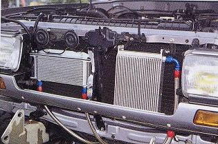

I took my hard lines off and had an fittings welded to the ends and used fittings and lines from frozenboost.com to my factory cooler with an fittings welded on. I think I'm going to use a filter adapter also like Dusty!
