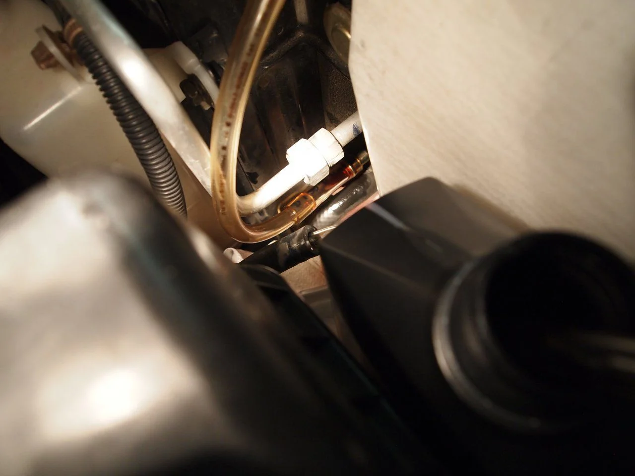

Transmission fluid is pumped into lower DS metal nipple going into bottom of radiator. Comes out metal nipple on PS of lower radiator connected by rubber hose going to lower nipple at PS of upper radiator next to over flow tank, then on to oil cooler in front of radiator via metal tube. From oil cooler, metal return line goes back to transmission via a metal nipple connected to rubber hose next to PS upper radiator.

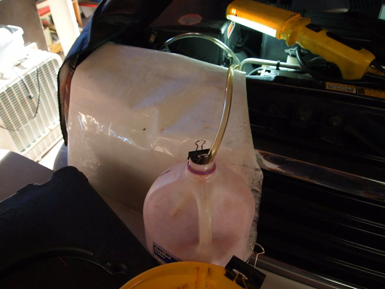

Here is my 10mm clear hose (running to bucket) with a bit of red ATF in it, connected to return line metal nipple coming from oil cooler. This is next to coolant overflow tank.

So i should disconnect the return line at the radiator and connect a line to the radiator at that point and into a drain bucket.
Then pour AFT into the dipstick tube while running the engine.

Thanks for the help it worked great, the only thing i forgot was the beer:beer:
PS it was the top transmission cooler line next to the upper passager side of the radiator.
