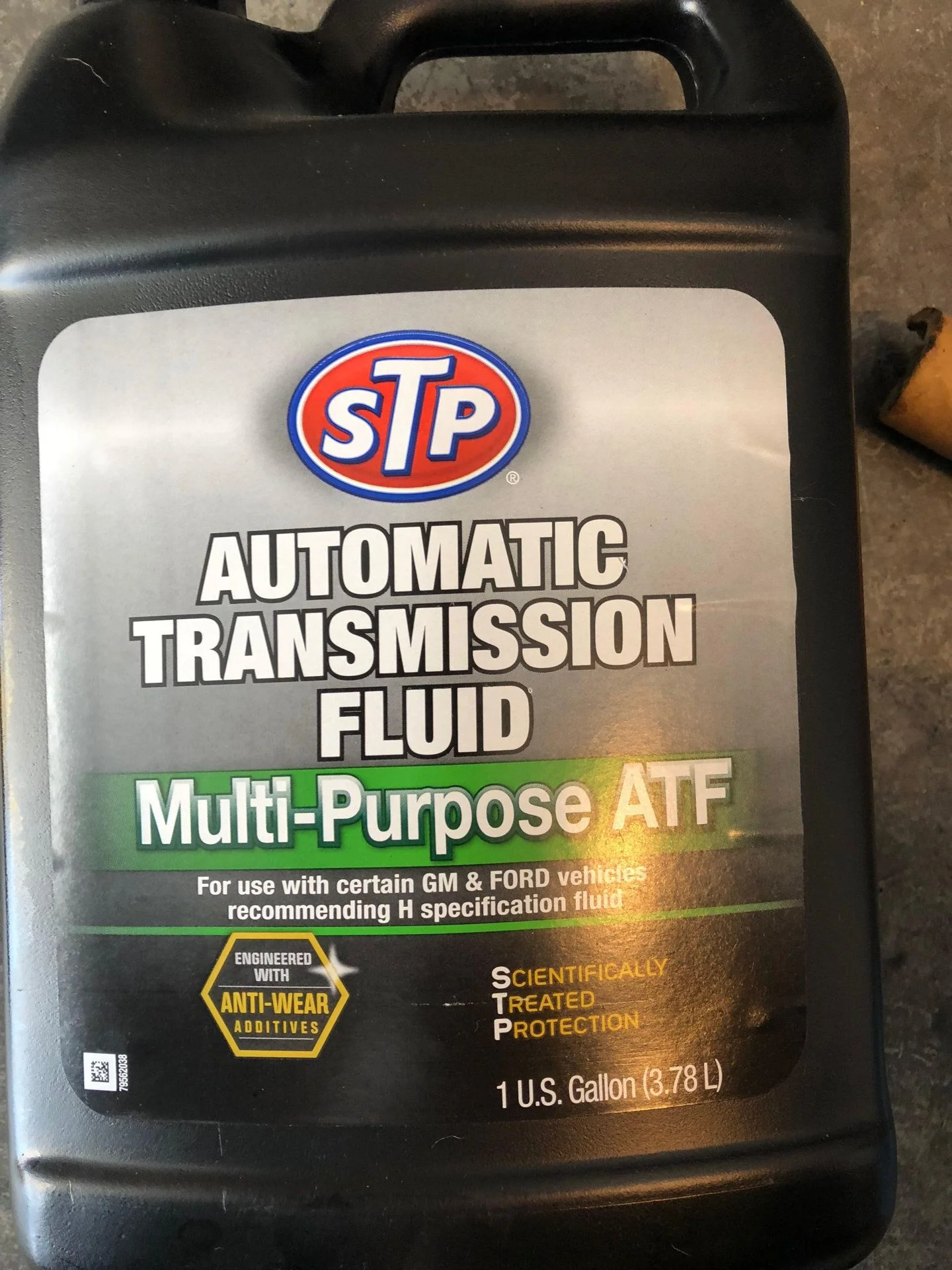

Hey Guys:
Thanks for the help so far. I used an STP multi purpose ATF. See images. The bottle indicates it should be good with Dexron II specifications. Let me know what you think.
