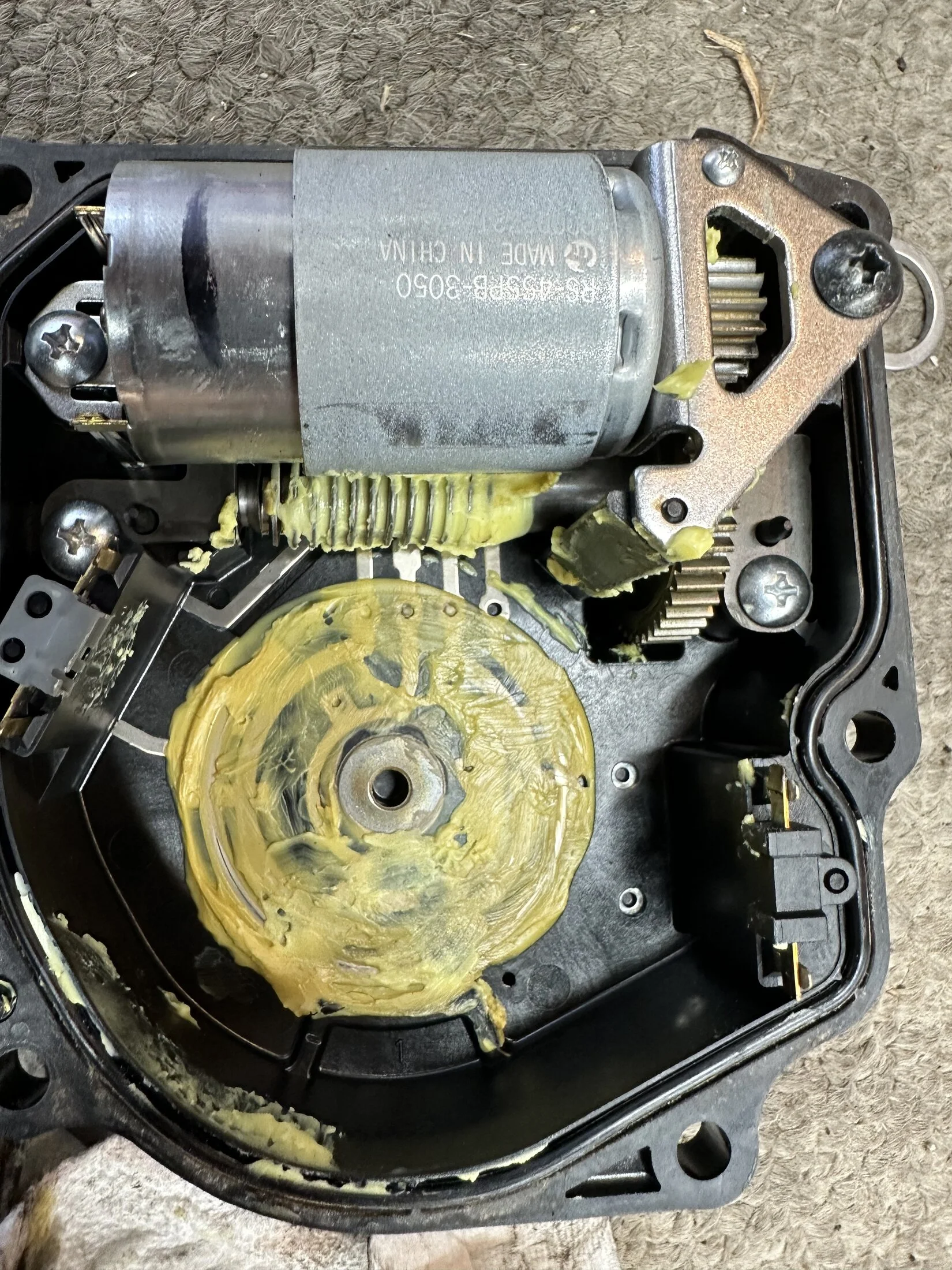

New one came in. Aisin part not toyota direct. Plugged it in, tested it and it worked flawlessly, confirming something is definitely wrong with mine. Took it apart, clocked it, put it back together, tested again, and worked great. So, going to go ahead and disassemble the old one like in the video, leaving the rods in place, and using this new one. Never messed with the hi/low side of the actuator so I'll have to familiarize myself with the clocking of that one since I sorta never paid too much attention to that portion of the video...🫣
Oh, and the microswitch of this new one seems exactly like my old one. Springy, no click. So, I don't know what the heck is up with the old one.

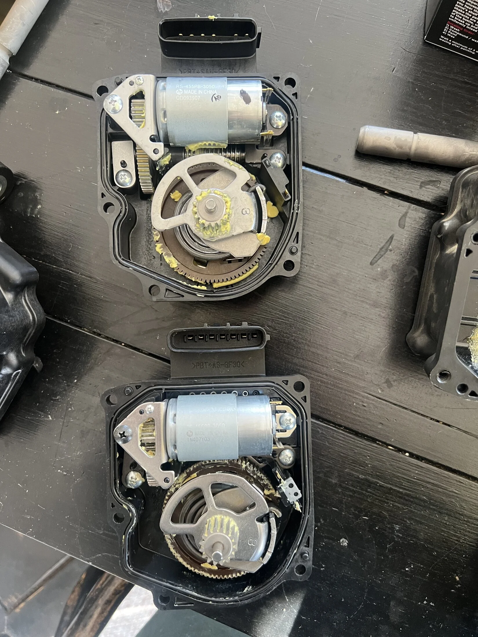

I'm just installing a new Toyota/Lexus part, and notice that _there's no microswitch_ on the new part. The reason I bought it was to replace my old one on which I'd broken the microswitch.
This makes me curious if they've switched to a Hall effect sensor instead of a microswitch to increase reliability, and whether I should just go ahead with the install or freak out.
Here's the old part from my 2008 LX at the bottom, with the new Toyota/Lexus part at the top. Same in all other aspects, but no microswitch.
Here's the old part from my 2008 LX at the bottom, with the new Toyota/Lexus part at the top. Same in all other aspects, but no microswitch.View attachment 3698308
I see some other differences
There is a different pin count in the connector, for example
Good catch...I suspect the part number I have is for some newer model though it was listed for 2008. This case is identical except for having a microswitch and associated pinouts.

The hi/lo on my 14 didn't have a microswitch. It's like your newer one. The equivalent part for my model year direct from Aisin was the same. But there's still a microswitch in the locker side of things.
Thanks for the speedy and helpful reply; I've nailed it down to exactly that. The eBay seller from Japan had the part listed as a 2008, so I snapped it up. I think I can effect a half-assed fix, since the mounts are still there; I can get the signal to the pin.

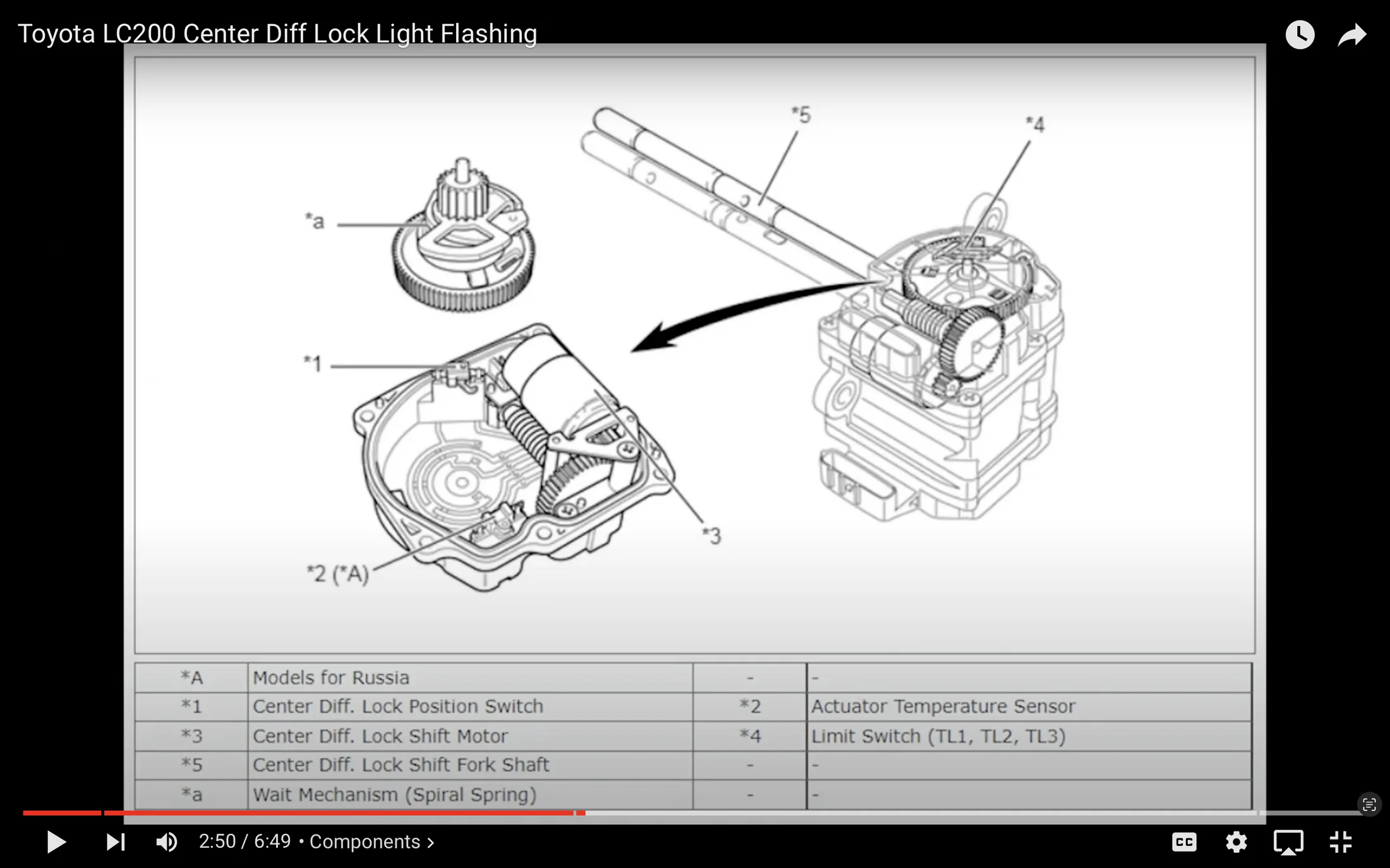

I have a similar issue that is described here, the flashing CDL light would come on periodically on a 2013 LC. Using one of the many videos available on the topic I removed the top cap of the actuator to place more of the yellow grease on contact spots that was the culprit for the high electrical resistance. I didn't realize until I placed the assembly back together that I broke the CDL position switch (the broken piece can be seen in the photo). From this forum, it appears the only option is to purchase a new actuator since no one has been able to find this switch. I have one on order and I was thinking of removing the top from the new actuator and installing it on the old assembly. The car has been in CA for most of its life so the dreaded corrosion that is seen on other vehicles is not present here.
However, in reading through this thread it seems like even if I was able to remove the top and install it without damaging the CDL position switch (no 1 in the diagram), it sounds like there may still be issues with the CDL light flashing due to incorrect clocking of the motor? While I'm hesitant to pull the new actuator apart due to the previous experience, the thought of having to put this on and off due to the position issue on the motor has me thinking differently. I have a shop that I trust to do the job (I'm guessing they'll just go with the option of installing a new actuator rather than risk damaging the internals), but wanted to check with the collective wisdom of this group before I did so.
I too am frustrated by how complicated Toyota has made this issue, both in terms of the lack of availability of the microswitch and other parts. Thank you in advance for any thoughts that you might have.
