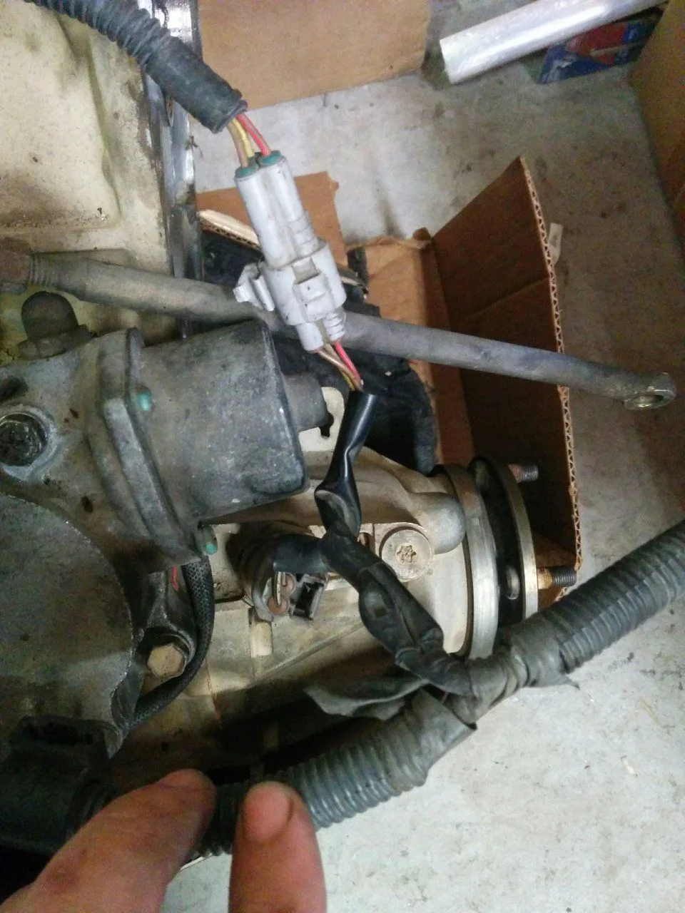

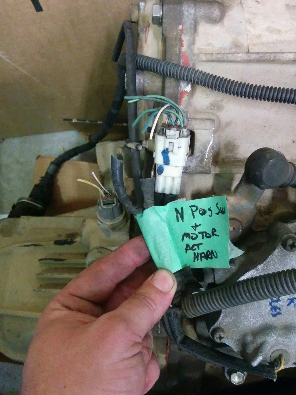

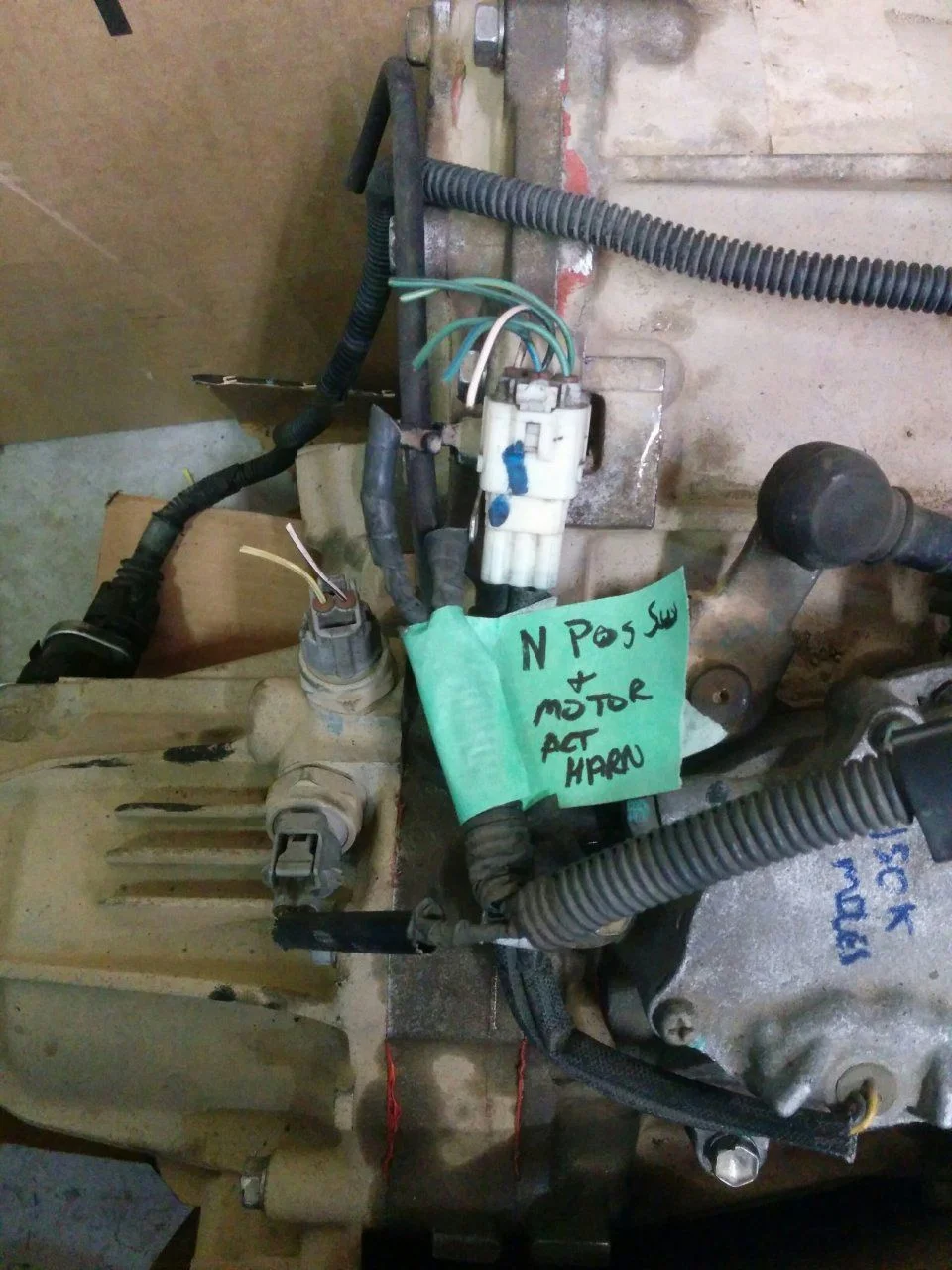

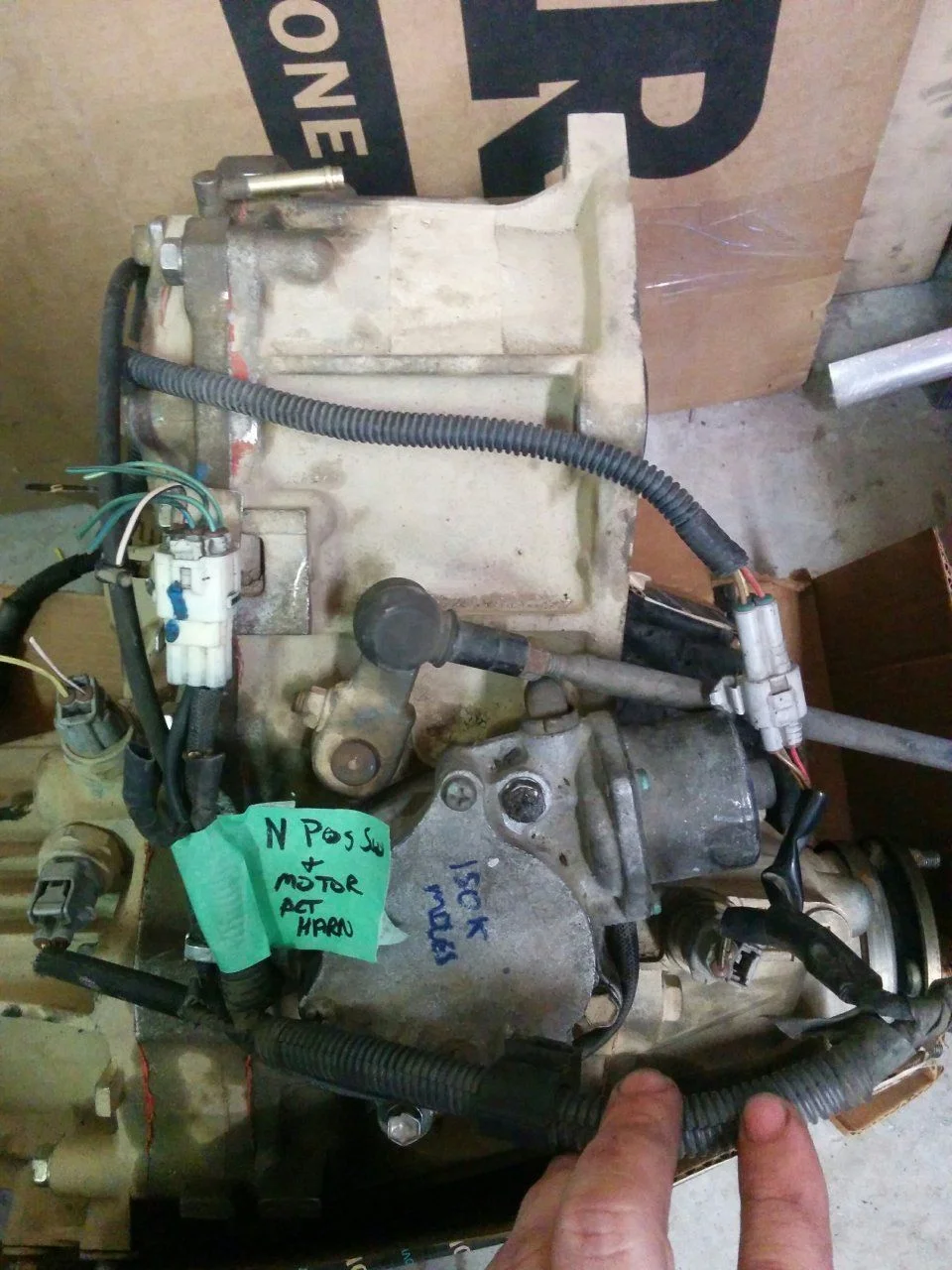

Right above the green tape you are the tcase outer shift lever, with the linkage attached. To the right of the boot is a threaded section.
Should be able to loosen the nut on the linkage and thread it in or out as needed. This could resolve both our situations.
Might have to disconnect the linkage from the interior shift lever at the front end of the linkage in question. Should just be a cotter pin.
Pretty sure the tcase is in low range with the tcase outer shift lever in this position in these pics.
