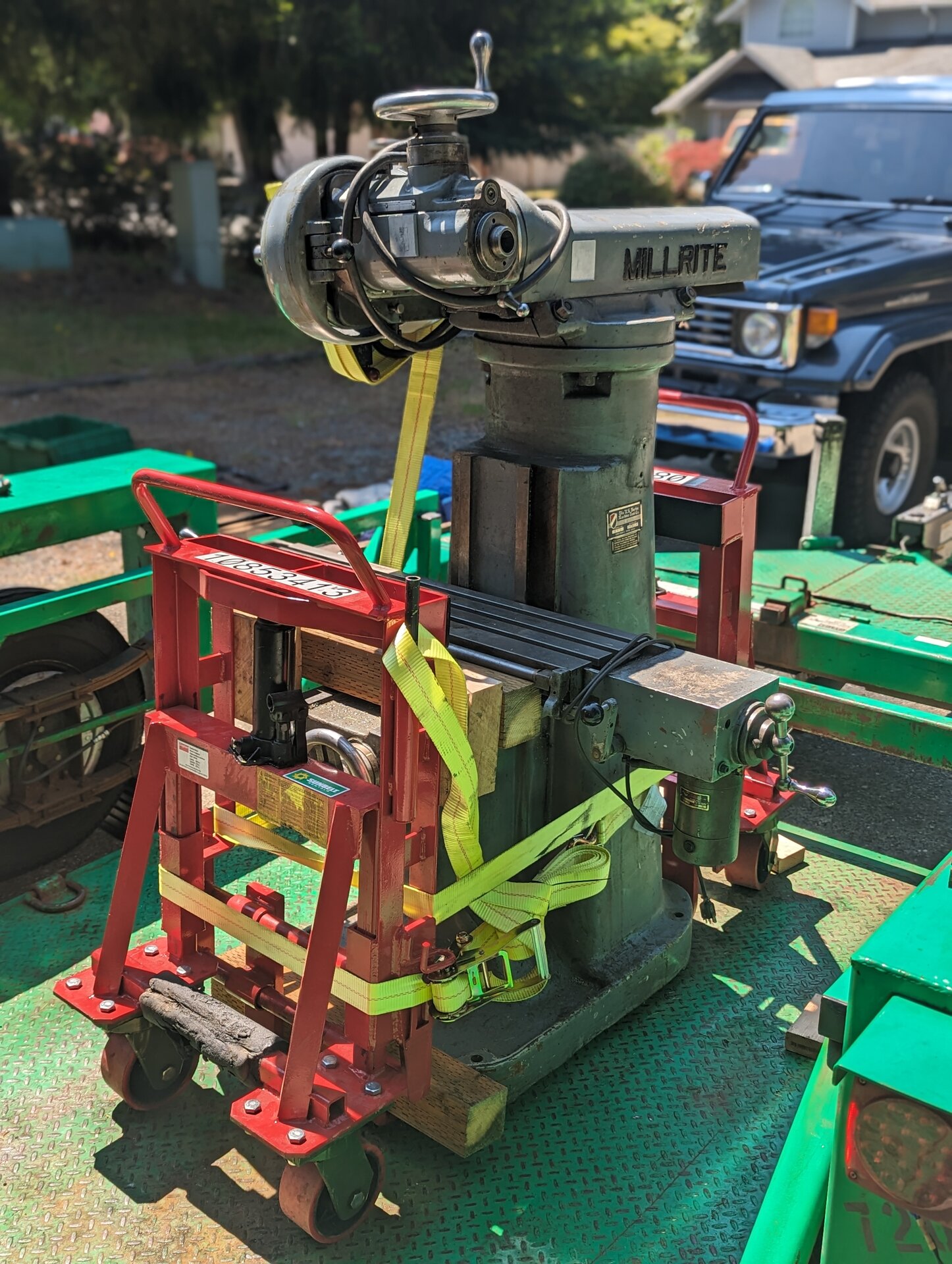

Pictured: Things you can haul around with a 1HZ.
Also, there was a lathe, a punch press, a brake, a sander and about 500 pounds of random stuff. So, let's call it 6K with the trailer. Good job, old girl...good job. ❤️
I call fake news! 🤣🤣🤣
I'm assuming you're at sea level with a tailwind? Some days I'm wishing I didnt have the extra weight of my dog onboard... And she hasn't cracked 20 pounds yet. 😉
Work horse. Nice milling machine!
Yeah, it's a decent one, methinks. Just right for a pint-sized shop.
Actually, yeah... that's about right. You can't live in costal Washington without being at sea level...and the breezes from the sound are pretty nice. 😉
I think mine just passed 140-something. Three years old and still putting on weight... 😬
