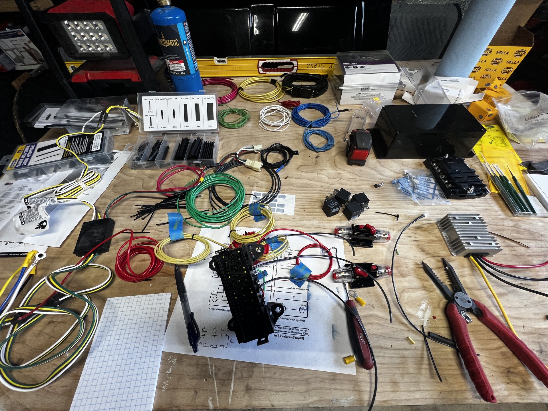

Looks like the junkyards around my area might not be a great resource; from what I'm hearing, selection is pretty low and electronic components are usually stripped out...so I'm thinking it might be easier to just order the relay block that I need and be done with it. I know Hella makes one, but I'm having trouble finding the 87426 mini relays anywhere that can get them to me quickly. Is there a Bosch or Denso interchange for them? I can't seem to find that chart, either. Maybe this isn't my day to look things up...
Edit: I couldn't come up with anyone that could ship the Hella relays anytime soon, and the junkyards don't seem to carry anything that's 24v...so I ordered some Bosch 0332209204 relays, and hopefully they'll work. I think the only difference is that they have a diode instead of a resistor.
As promised...
Pictured: The Mess
