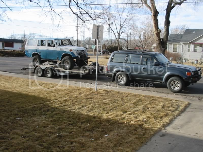

When I weighed Pig, it was 4280 with 35's aluminum rims, sliders, etc. I would imagine as long as the car hauler is a tandem axle you'll be fine. Here's a pic of size one I used to haul pig after the roll.
I would honestly be more worried about what you are towing it with. The 80 was not happy towing this setup even with trailer brakes. I wouldn't want to take it any distance at all.

you can see in FJBen's pix what did NOT work for me....ihis pig is too far back; I had it loaded like that BUT after a few miles was scared pi**less of the trailers wanderings..........the more weight I had forward the happier the towing went...300 miles total.........not terribly far but enough to give an idea;
