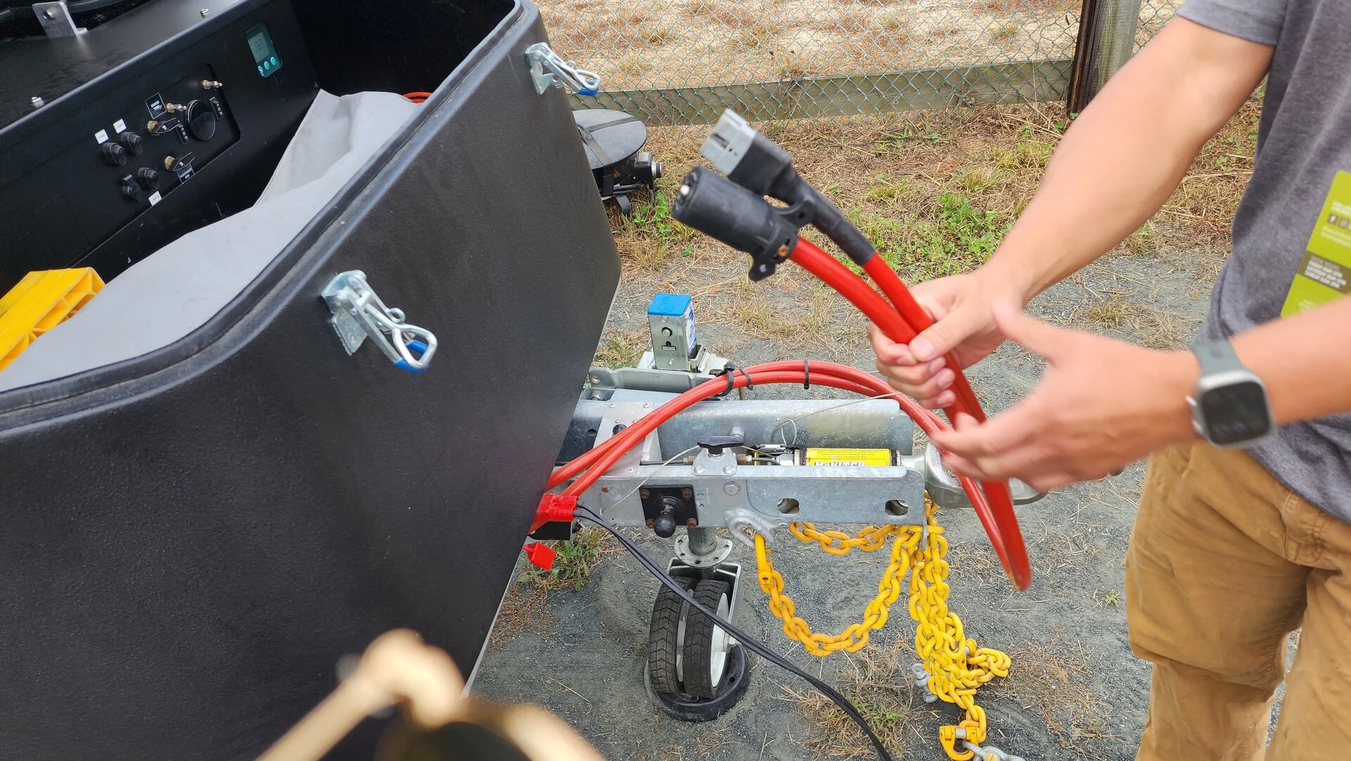

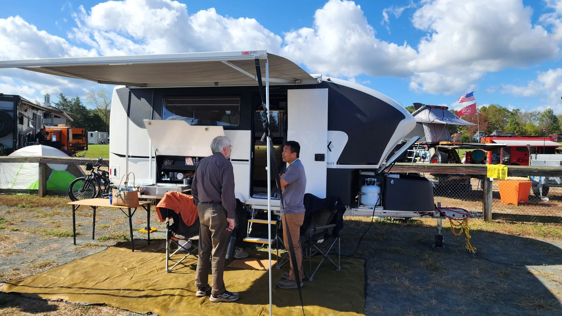

We spent all day at Overland East. We found a trailer - Kimberly, that has a separate high power dedicated battery charging cable that can connect to the tow vehicle! The company owner was there and we had a lengthy discussion on this topic.
How much $$ was the Kimberly?
The one we looked at was their smaller one, single axle E series. It's the perfect size for us. It was the trailer's owner showing it; got lots of practical questions answered. They said they paid total $100K. Shipping was $10K from Australia.
Here's the Kimberly E series we looked at:

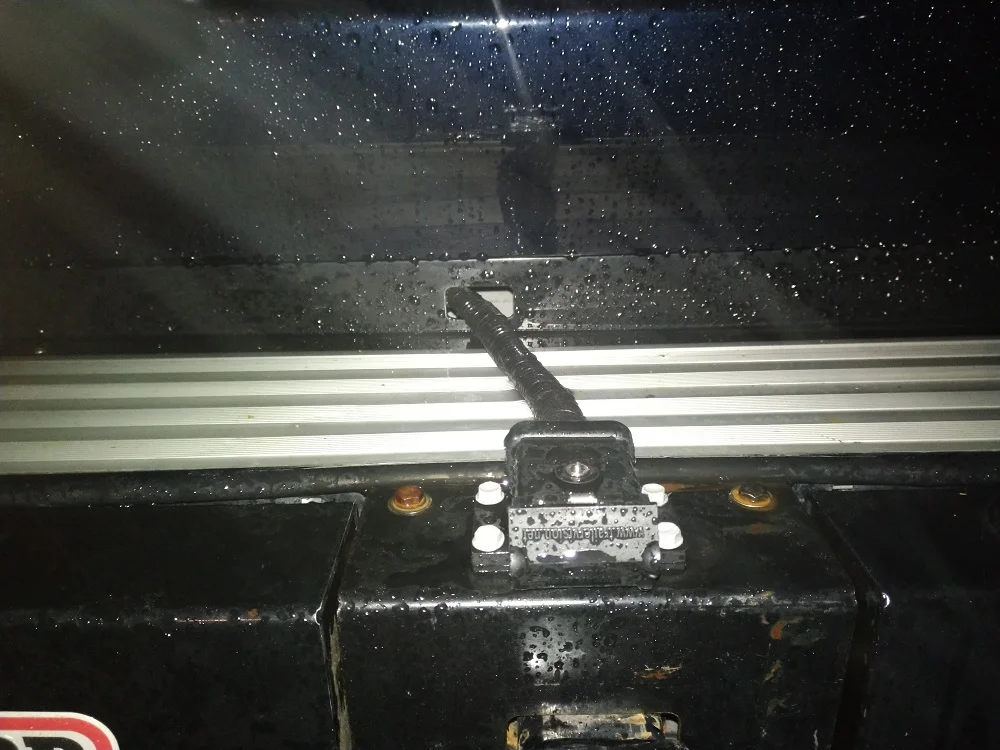

I ran my 6 awg wires for the 50amp Anderson from the rear bumper, up through the hole in the floor to my bus bars in the cargo area (with breaker on both +pos ends). I did that as I'm running a dc to dc to the trailer.
For ground you may want to use a bumper frame bolt since you are grounding to frame.

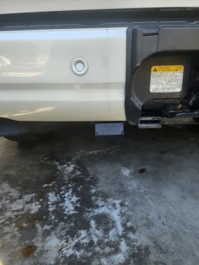

On the 200 there is a hole under the tail gate in the center.
This is mine. I still need to add a plug in the hole to avoid chaffing. I have arb swing outs which is why I selected that location. Other bumpers have better options.

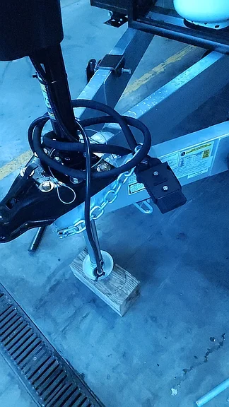

  • Anderson SB-175 in Trailer Vision weatherproof housing at tongue.
  • 4GA wire into the trailer to a new REDARC BCDC 1250D dual input charger.

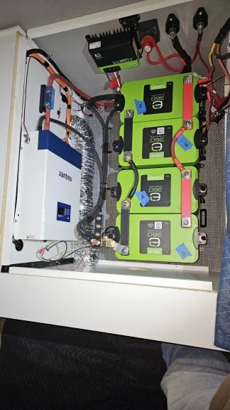

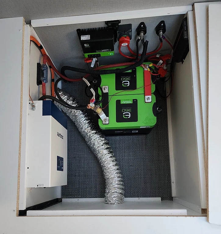

Battery area - placement of new components per my spec to accommodate future additional chargers, controllers and batteries
  • Factory
    • 2 100Ah Expion 360 Lithium batteries
      • 2 more are going to be added for 400Ah total
    • Xantrex 2000W inverter
    • Expion 360 MPPT controller for 400W roof solar panels
  • New/custom
    • Cutout switch for Anderson connector, rear center
    • Power posts, rear right
    • Newly added REDARC BCDC charger, right rear corner
    • REDARC BCDC Yellow wire connected to ZAMP connector on side of trailer
      • Formerly connected straight to battery bank; required either regulated solar panels from ZAMP or MPPT controller to adapt other manuf. solar panels to charge the lithiums
      • Allows me to use my existing Merlin XP-170 solar panels in addition to the solar panels on the roof
    • Additional fuses, not shown

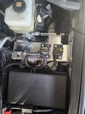

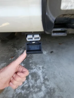

SB-175 at the bumper
  • 500A ignition actuated relay
  • 120A breaker for the Anderson SB-175 at the rear bumper
  • 60A breaker for the Anderson SB-50 at driver's side
    • 6GA wire from breaker to driver's side foot-well to be added future
  • Slee compressor bracket

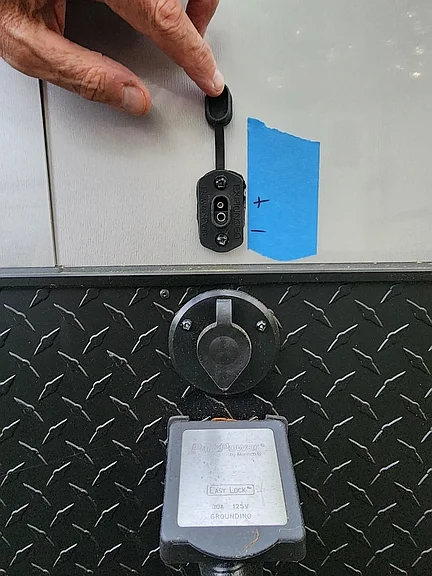

<I HATE ZAMP>
The ZAMP connector was initially connected by inTech directly to the batteries requiring the use of solar panels that were regulated.
Adding the dual input REDARC enabled me to re-route the connections from the ZAMP to the REDARC's MPPT input enabling me to use my existing Merlin XP-170 panels or any other unregulated panel.
I'm making an adapter for that vomitous ZAMP connector to an Anderson SB-50.

I finally did some testing on the Zamp auxiliary solar connection which I had the dealer connect to the REDARC's solar input.

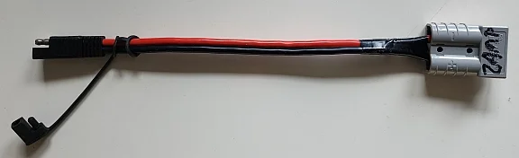

To do the testing I first had to make a polarity reversing Zamp to SB-50 adapter; 10 GA wire.
It's probably the only one in existence. 😁

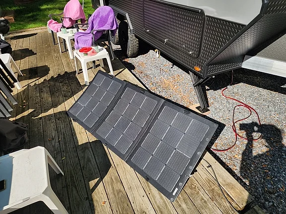

The test which was done in the morning had the 2 400W roof panels putting out a combined 240W and the portable Merlin XP-170 panels we've been using all along with our Yeti 1500X portable battery, putting out 115W. So it's a real gain. I suspect that the rooftop panels were a bit inhibited due to the partially shaded lot.
Zamp connector on trailer:
Polarity reversing Zamp to SB-50 adapter:
Merlin XP-170 solar panels:

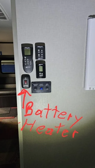

Just got two new 100Ah batteries added. Had to relocate the heater hose grrrr.... see post #50 above.
Also added a heating pad custom made for me by ultraheat which will hopefully keep the batteries warm enough to charge in cold weather. These are the same folks that make tank heaters for RV's & trailers. The pad is mounted along the battery compartment wall at the side of the batteries. It's controlled by a thermostat/relay that kicks on at 35F and off at 45F. There's also a remote switch that turns it off or on. This is a bit of a science project so story at 11.
REF: LiFePO4 Lithium Battery Warmers | UltraHeat - https://www.ultraheat.com/batterywarmers
With 400Ah total it just might be enough. We'll see!😎

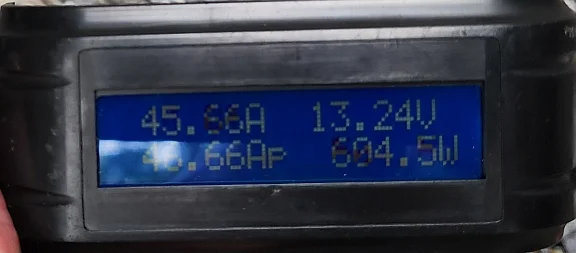

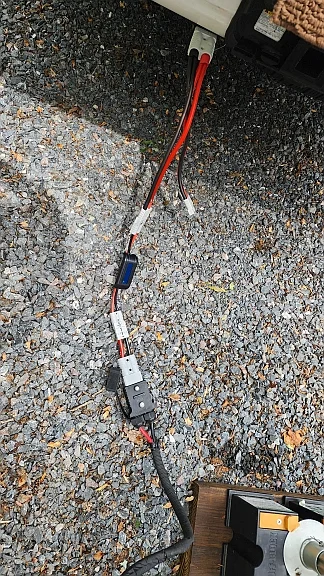

As I mentioned I just got the battery upgrade from 200-400Ah done this winter. But I haven't tested the charging from the LC post install. Previously I had tested charging by looking at the central charging panel which includes charging from all sources, like the solar panels. But you could come close by looking at the charging power before and after. With the LC connection I observed that the charging total went up to about what was delivered by shore power - 650W. So I estimated that 600+ watts was going to t he trailer.
But I never did a direct measurement from the LC's rear bumper to the trailer. Sooo with some adapters I bought over the winter and just because, I decided to perform an actual measurement of the charging power on the 4 battery bank and got 604.5W/45.66A/13.24V into the REDARC BCDC 1250D.:bounce:
It's just what I'd hoped but I'm a bit surprised it isn't higher like 50+A. Now as to what the REDARC is putting out EXACTLY to the batteries remains a mystery. I'll save that science project for another day.🤪
To do the measurement I put together this contraption which consists of a SB-175 to dual SB-50 adapter, power meter, SB-175 to SB-50 adapter:
