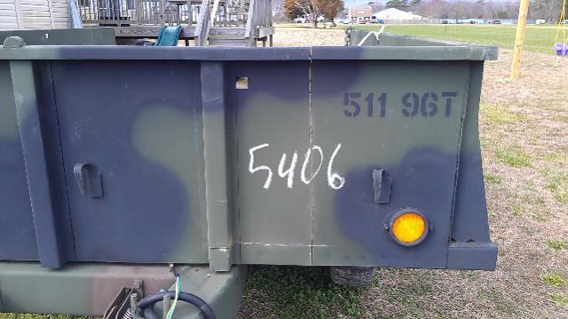

So I grabbed the grinder and burned off a few cutoff wheels :). The vertical cuts on the front and passenger side are done. I burned up four discs with those cuts, but it only took 20mins or so. The front should be ok to cut the bottom edge with the cutoff wheel also as there is no 4" lip along the outside as there is on the sides. Next time I'm gonna fool around on the unused sections to see how best to remove the sides from the floor. It might be with a sawzall, but I hate making long metal cuts with a sawzall. You can start to see the size difference in the cuts.
I decided to cut just inside the large u-bolts on the sides. That will make the inside dimensions 4'w x 6.5'l. It gives a small enough trailer for light offroading, more space than the old 416, and the floor cuts side to side will cut just on the side of a channel support- meaning easier cut and a beefy edge leftover.

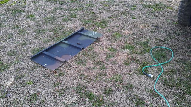

I only had one 8" metal blade left, so I spent abt 15mins giving it a rip. Finished removal of the front bulkhead and started the bottom cut on the passenger side. Dinged the blade tip so I stopped for today. It cuts the thin steel really quickly. I'm gonna have to open up a blade kerf hole where the angle changes on the wheel arches, but its going pretty well so far :)
So I'm doing my best to limit any cutting to the blade kerf along the bottom edge. The vertical cuts I'm making ~1/4" over size to trim down later.
My plan was to get some thin gauge angle, maybe 3/4-1" to support the inside edges of where the sides will hit the floor. This will give me something solid to weld to on the inside and it can allow some wiggle room to make sure everything will level out after the cuts are made. For instance, if an inconsistency in the floor means that the sides will have a very small gap in an area where it meets the floor again, the angle will back it up and a bead run over the gap on the outside can fill it in well. Sound logical? Or is there a better way to stitch is back together??

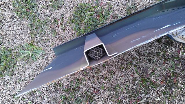

Side is now off. Found it the easiest way to cut around the arch is to ease the blade thru the goop under the spot welded flange from the inside out. Cut the spot welds and the flange was saved for reattaching later. Able to see in the pics what I have planned when putting it back together- moving the sides flush to the inside of the arches. I kinda like it.
We'll see :). Anyone can cut a trailer into a million pieces. Question is what it will look like in the end.
I ran out of time, but started to cut the passenger arch free. If you have one (or more) in your yard you can see what I mean- I think I'm going to move the arches in a few inches so their will be 4' between them. That will narrow the overall width 6"-8" on the outside of the arches. Will determine for sure at that point, but will probably take a few more inches off the outside of the arches too. Probably won't need all that arch width in the end(?).
