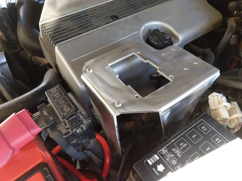

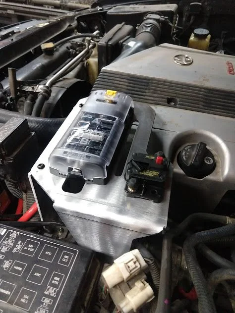

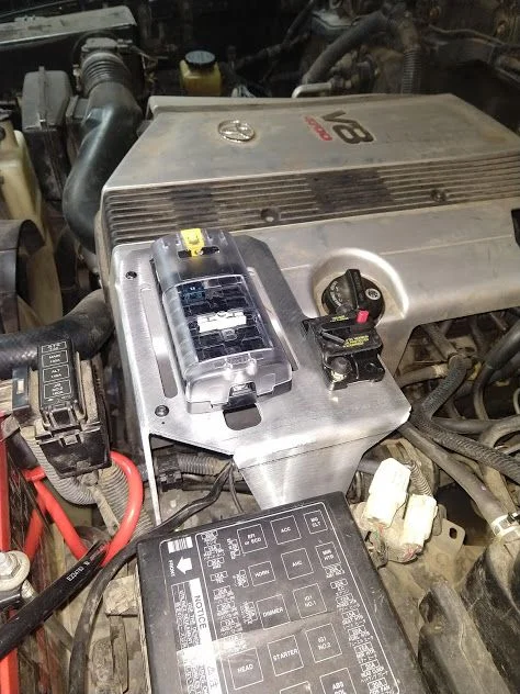

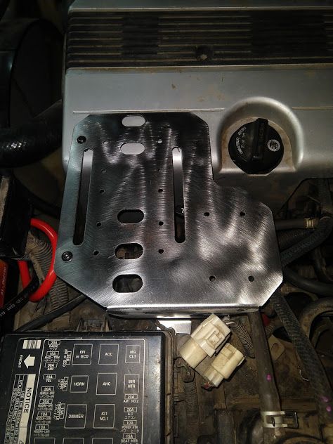

I am interested in a late model fuse panel, but also wondering how much room will be above and below. I have considered a Bussman RTMR setup running to a switch panel in the sunglasses holder area. It would require a different cutout but similar area. (Pictures from thread on TacomaWorld) Picture Source.

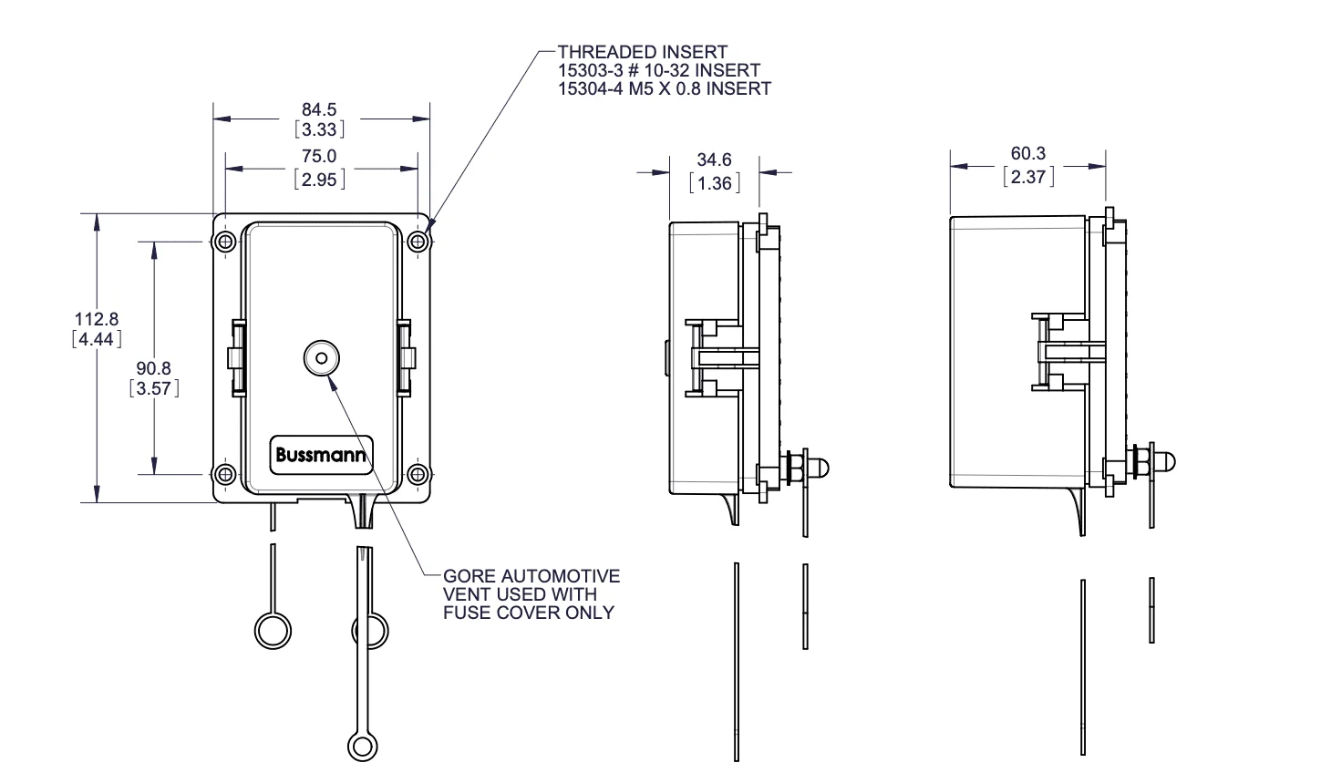

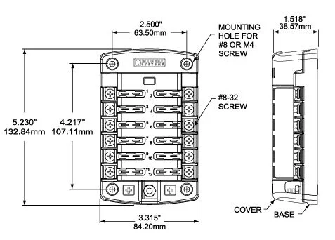

Also will gladly commit to paying for a panel that would fit the Bussman RTMR. I expect that with the short top (fits regular relays but not circuit breaker relays) this should be no problem since the specs show it shorter (34.6mm) than the Blue Sea fuse box 5029 (38.57mm).
Only difference needed is if @TRAIL TAILOR would be willing to make the panel with different cutout.

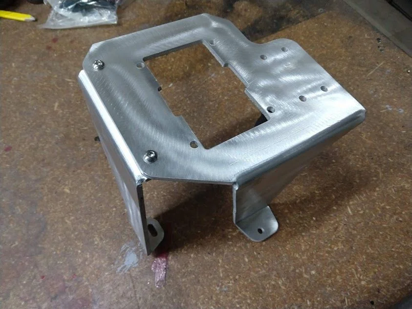

I'm out of the shop today, headed to the eye doctor. @neilson100 for a Bussmann RTMR is next and then I'll be cutting and bending a few. I'll be able to ship the E-100s by the end of next week.

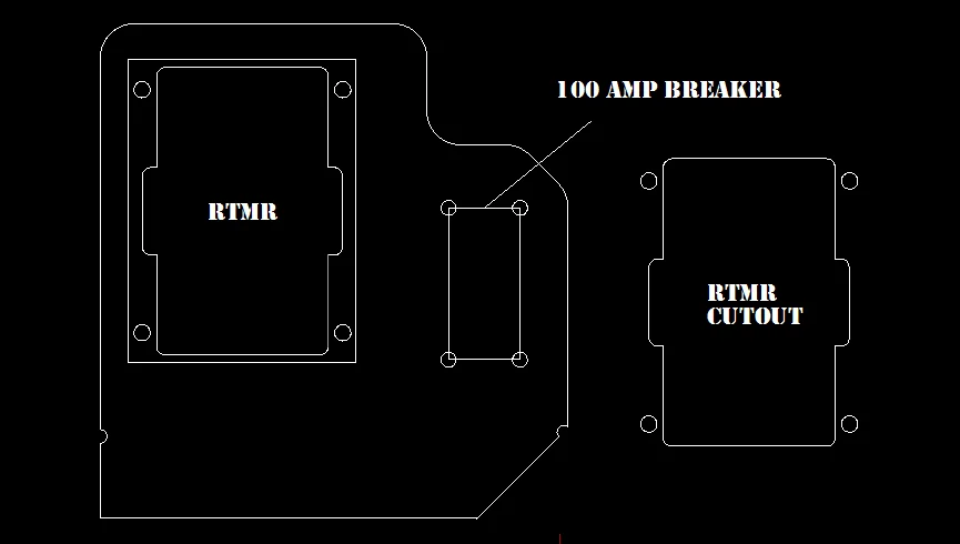

Will cut sample tomorrow.

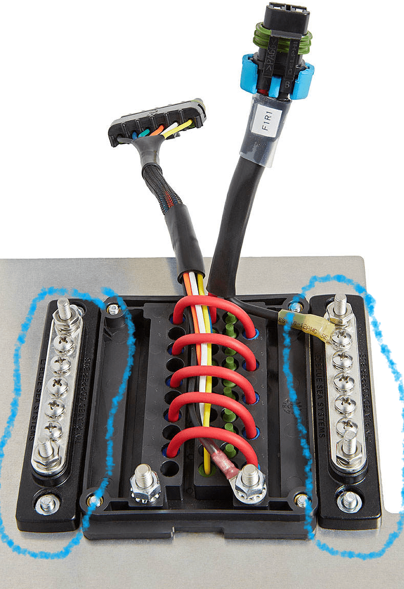

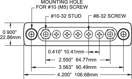

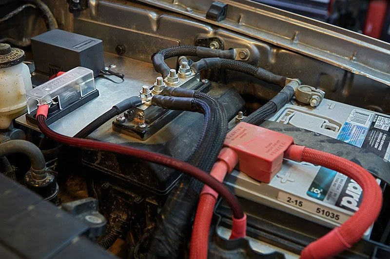

Is there room to move the RTMR over to accommodate mounting two BlueSea 2304 BusBars? This is from the link I posted before.
BlueSea 2304 Common Busbar
@TRAIL TAILOR I'd like to second @shevy77 question/request
Interested in this option as well.

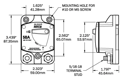

Do you guys want the Bussman breaker option?
J
J
Jason, Not certain what you mean by Bussman Breaker option? Are you asking about a Bussman circuit breaker instead of a Blue Sea circuit breaker? If so then I do not. I would ideally be mounting the Blue Sea 187-series surface mount circuit breaker. Like Blue Sea model 7142
