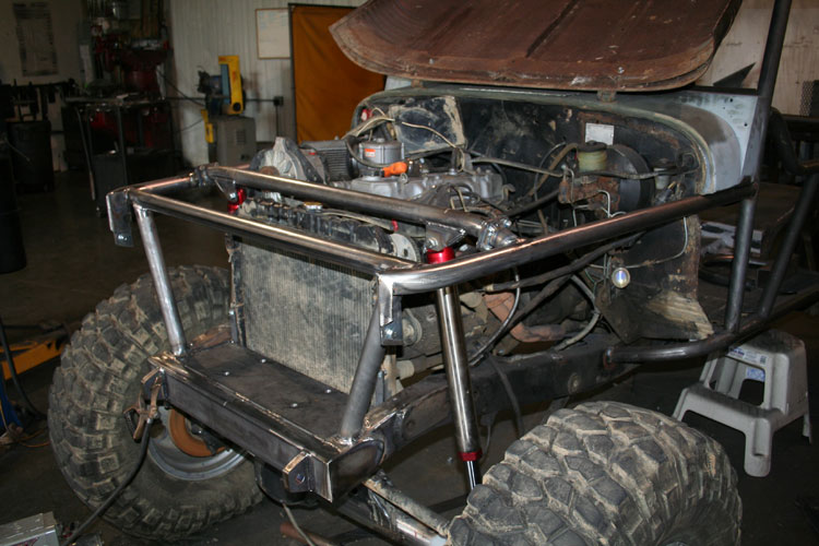

I have been kicking butt on the front end yesterday and today. Here is what I have done so far:
What I really like about FJ40's are their Fender Approns. So I wanted to build some skins that gave the FJ the FJ40 look. I am not ready to make the skins just yet, but here is what I am probably going to end up doing with the front end.

Flextest for suspension fit:
Lower Mounts have plenty of clearance:
Going to have to move these rears in a little:
Bib Hits, going to have to trim it:
Front Flex:
Front shocks hits the frame a little. Going to notch out a little of the frame:
Front Lower mounts have plenty of clearance:

Here is what she looks like since the last update! It now drives, steerings and is probably about 1 more weekend of time from being 100% complete.
I did not like my front fender panels and could not put my finger on it. I finally figured it out last night and marked the fender for a new cut with some tape. It is also at it's final ride height.
