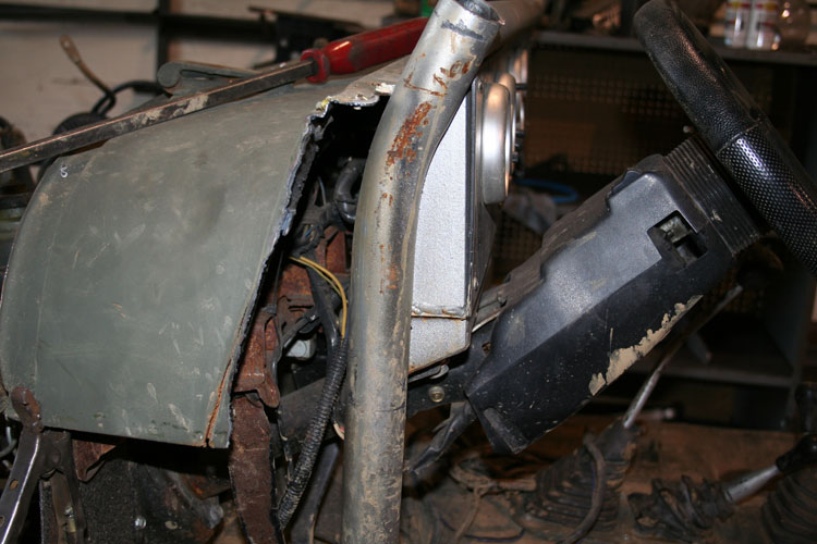

Finished the tub/firewall cut on the passenger side and then started working on removing the Dash and then reworking the cowl. I really did not want to have to remake the dash for a third time, so I am going do some flaring off the new cowl to make it fit. Should look pretty nice when it is completed.
Damaged cowl, both sides pretty much the same.
Cut out the sides, and then removed the dash.
New side and new top. I am going to have to wait for another person to be around to help me bend the outers in and force the top flat. For now it looks kind of wavey and out of square.

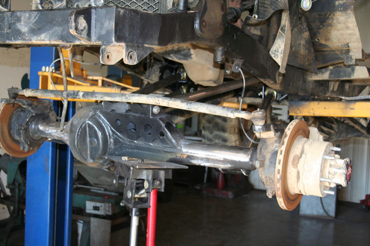

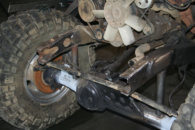

I am using Johnny Joints on one end, but wanted to use poly bushings on the other end to help with some dampening from shock load. The Links I got were premade and taped for LH and RH. So I made up these to allow for them to still be adjusted when installed:
Front Uppers Mount/truss:
Links in place:
Still have to finish the lower axle mounts and make a small truss for the passenger side of the axle. Then I can make the air shock mounts and move on to chopping the frame up!!!
Air Shock Mount:

:smokin: You're workin pretty fast. Looks great so far :cool: Any pics of the frame mount brackets? Did you fab up all the brackets yourself? Only thing I'd look at doing is reinforcing those bushing ends where the threaded rod meets the tube. I'd add 2 angled gussets & run another wider pass around the entire rod - turn up that welder on this. I think you're okay w/ the hydro-assist w/ the sized tires you have. What drivetrain are you runnin?

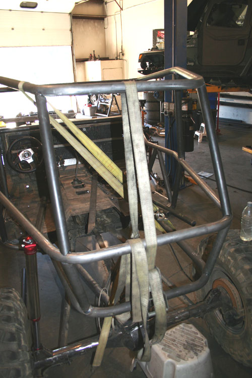

Daryl wanted to chop 2" out of the old height, so we started on that one night last week. We got it chopped down and back on the cruiser, but then we found that the upper halo and the middle halo had some alignment issues. We can to get the upper halo pulled over. We did not notice the problem until we started playing with the back bars. We ended up having to use some ratchet straps to get the halo over.
Back bars, and ratchet straps:
New front Profile:
New side profile:
