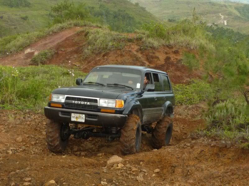

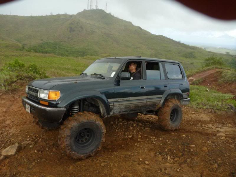

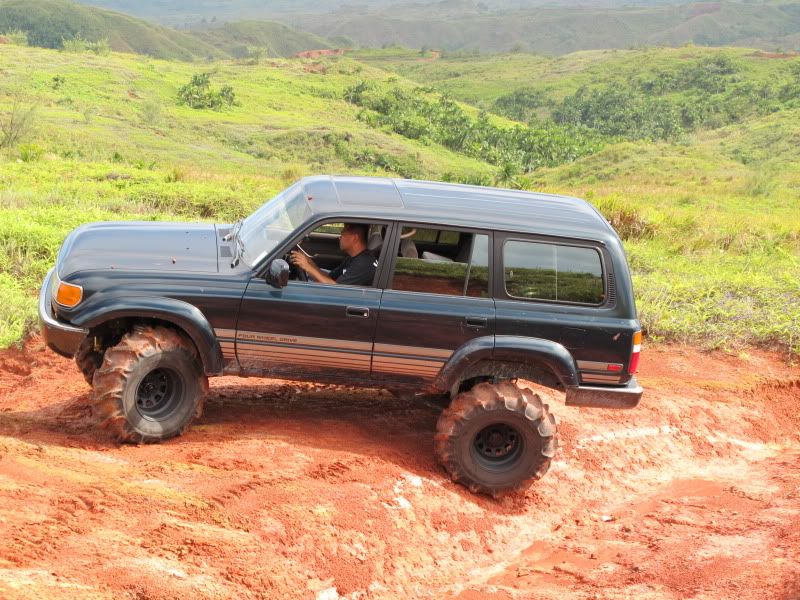

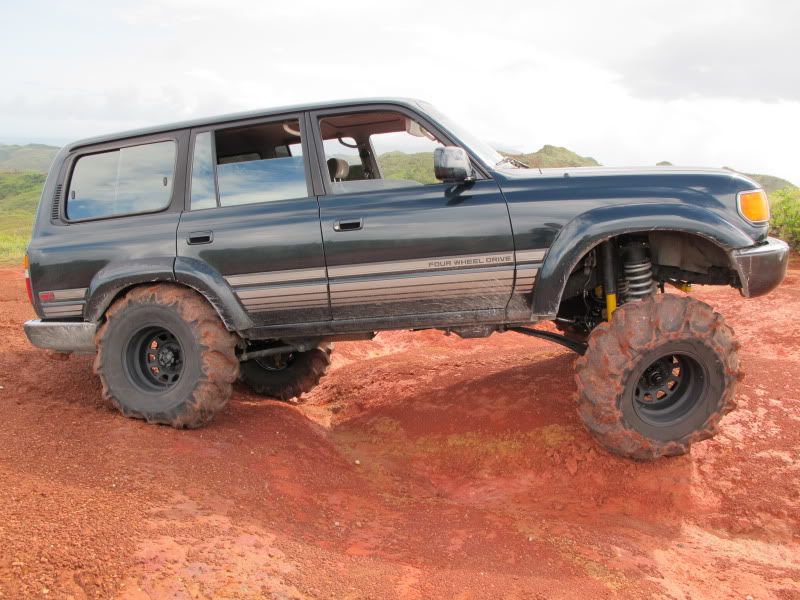

It's been a long six months of trial and error and finally I got it where I want it (for now). 37.6" bridgestone ag tires, 16x10 US wheels 2.5" backspacing, 4" slee suspension kit with 6" rear springs and homemade front spring spacer, 5.29 front and rear gearing, aussie front and detriot rear and center diff lock switch off my 91 fj80.
Thanks to Racers Edge and Slee Offroad.
Just curious why 4" front .? and 6" slee rears .?
My plan was that I would deflare and trim the fender well plus a Slee 4" suspension for a daily driver. That all changed when I got a great deal for a 1997 LX450 ($4500) new daily driver and 1991 FJ80 ($500) long term rig. So, I decided to not deflare and trim but, to go a little higher. I made a 3" front coil spacer and welded it to the bumpstop /coil retainer bolted to the chasis, so when the coil is at max compression my 37" tires have very minor rub. I ordered Slee rear 6" coils to even everything out.
