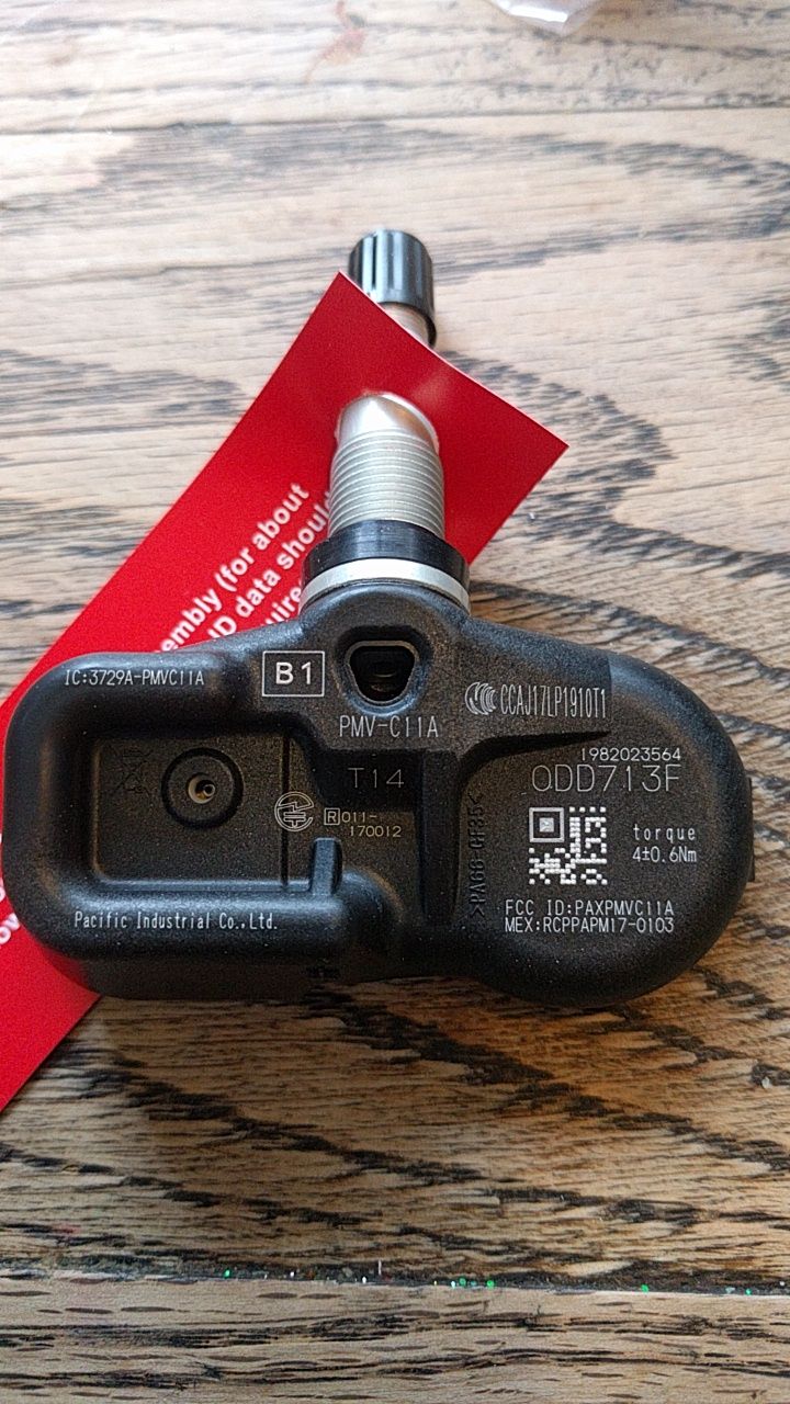

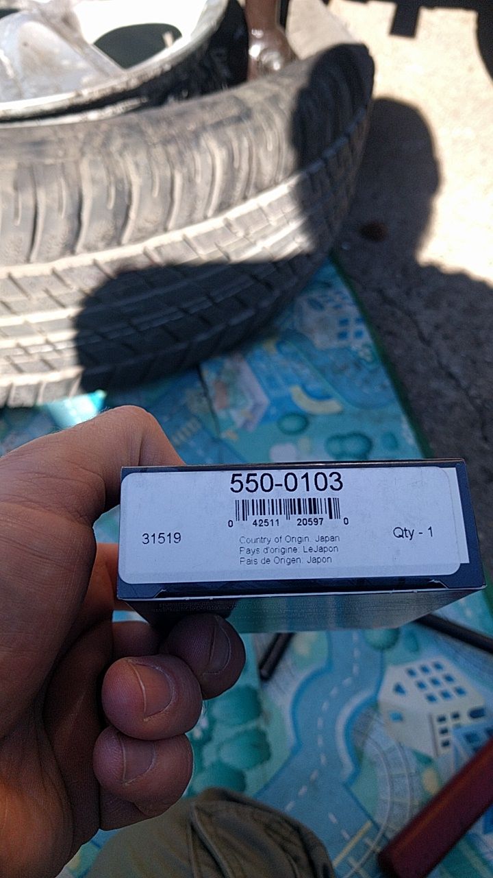

They're estimate to replace all 5 was over $500, so I ordered 5 sensors (probably knock off) for $160. I took pictures on each new sensor and wrote the number down:

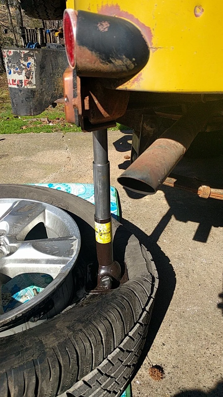

I'm embarrassingly slow, using my fj40 and bottle Jack to break the bead:

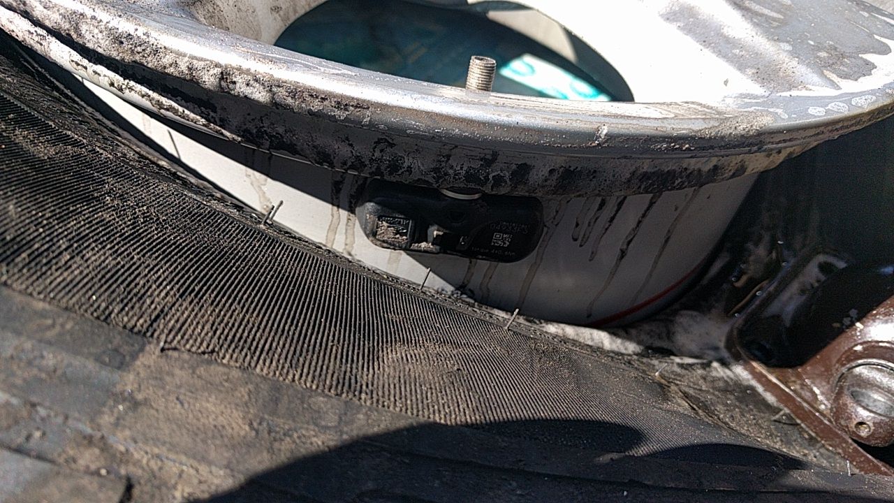

Old original 2008 sensor, on the original 2008 spare tire....
New tpms:

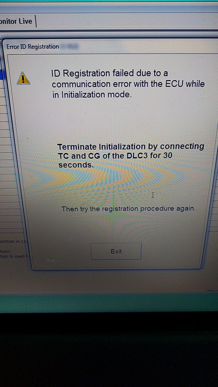

Now I'm off to try starting my old laptop with tech stream and register the right numbers.
Uhh... let us know how that works out, but so far nobody has been able to get Techstream to edit the TPMS registrations. You need a special tool, or Carista.

Alright, tech stream is erroring out when trying to update the ID's following this guys process:
Is that the failure point expected?

Oh, and I busted my extra jack... stuck in the middle and won't go up or down...

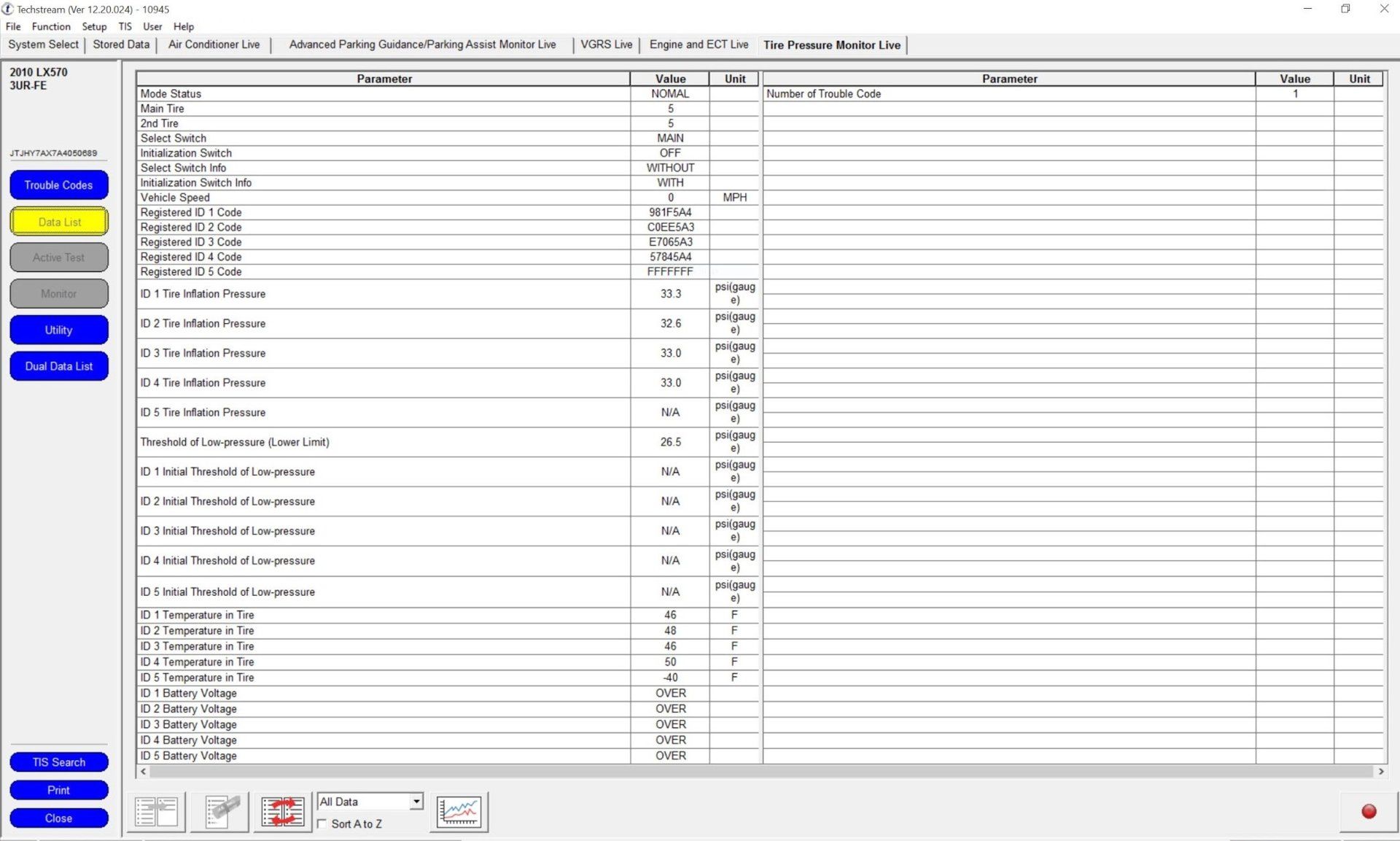

Hold on! I bought "programmable" sensors and cloned the OEM sensor ID's into the new/programmable ones. Techstream shows the sensor ID's correctly and it even shows the pressure and temperature, BUT I'm still seeing the "Tire pressure system Error" light on the dash as well as the (un-cleanable) "Transmitter ID not Received (Main)". Any suggestion?
Haven't seen those issues before, so unfortunately can't give you a concrete solution. I don't even have Techstream - did everything with that tool I linked to above.
Try disconnecting the battery for 30 mins to reset settings?
Your tire in location 5 has a bad ID. Thats why you are still seeing an error. All "F"s is unlikely to be valid. The two codes you are getting is because of this.
