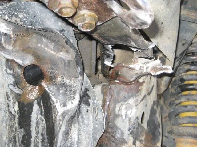

Ditto to what Todd said. Especially if the frame is not so much bent but ripped that is a good thing as far as an SAS.

Here are a couple pics the insurance guy got of the frame.
They gave me their offer and are getting back to me on what the buyback cost would be. I need to make some decisions, their offer would be enough to hypothetically move on. Now I have to weigh the cost of buying somebody's already built rig(I love mini trucks like Tonys old one) vs. the cost of sas. I am going to assume that it would be at least 4k to sas, so I wonder what I could get for comparable $$$'s.
