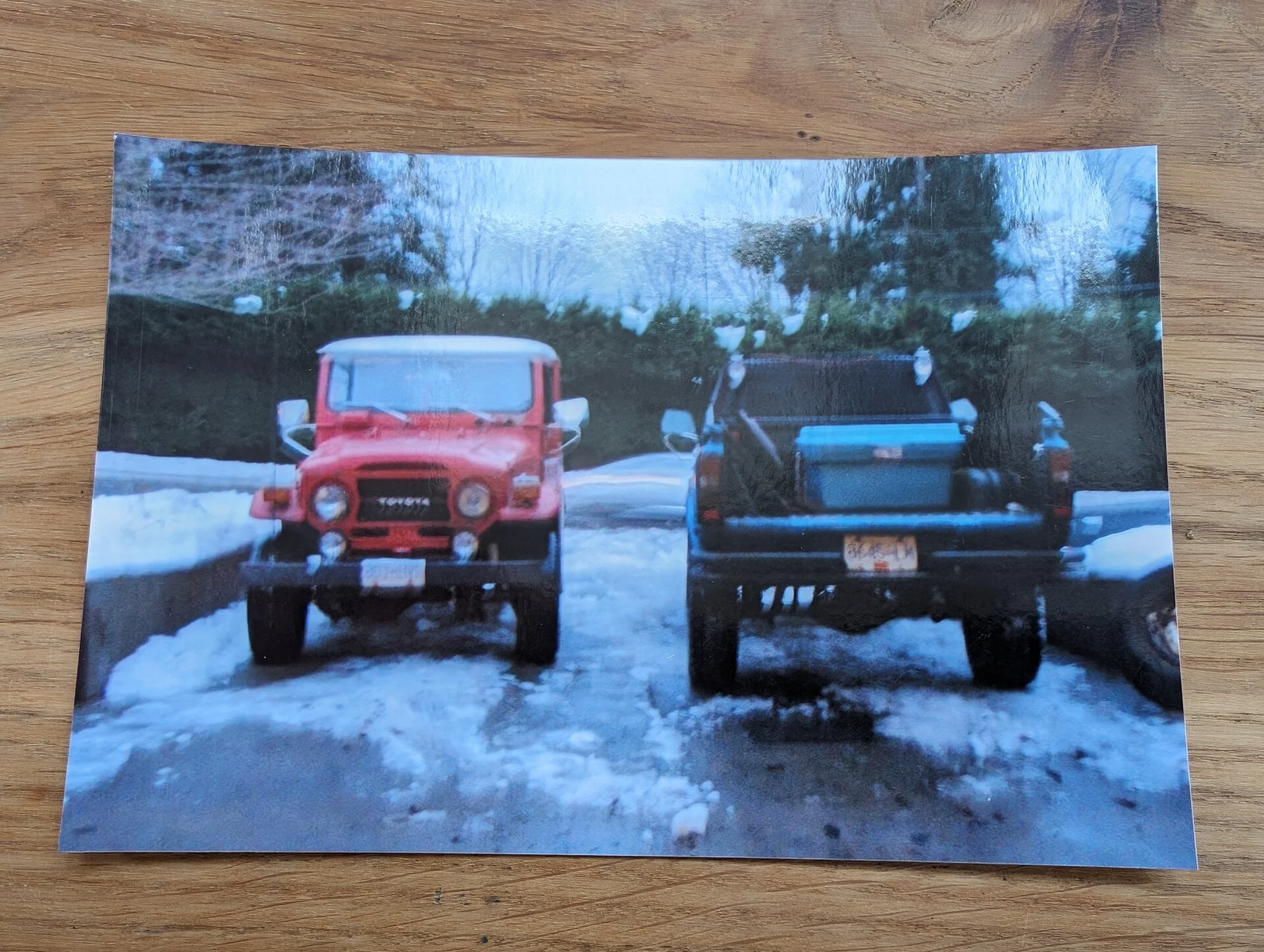

Found an old picture of Andy not long after I bought him, not sure exactly how old, but definitely before the tub swap and spring over.
Think I took the picture in Courtenay

I bet you didn’t think you’d still have him 14 years later… how time flies.

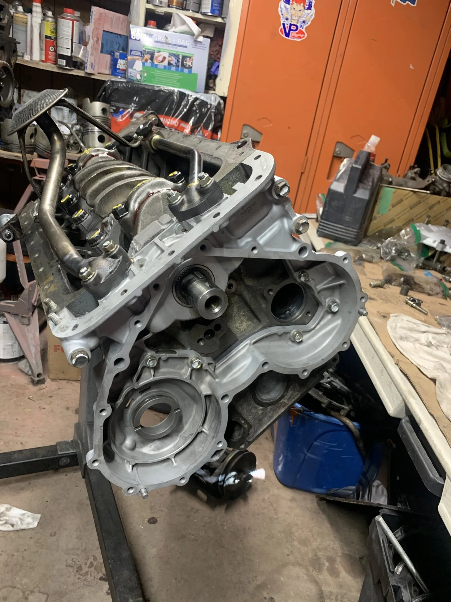

Getting closer. I got the bottom end back from the machine shop after three months. I had them install new wrist pins and bushings with new piston. I put new cylinder liners in and polished the crank. I had the matching shop true up the crank journals and install new bearings and bore and hone the liners. I got them to install the crank and pistons rings. For 2k
I got it home and started checking the work found the centre cam bushing not lined up to the oil port, so I took it back and had them look at it. They said it would e fine. I did not think so so I made a plug with a shoulder and pulled it out and lined it up better to the hole

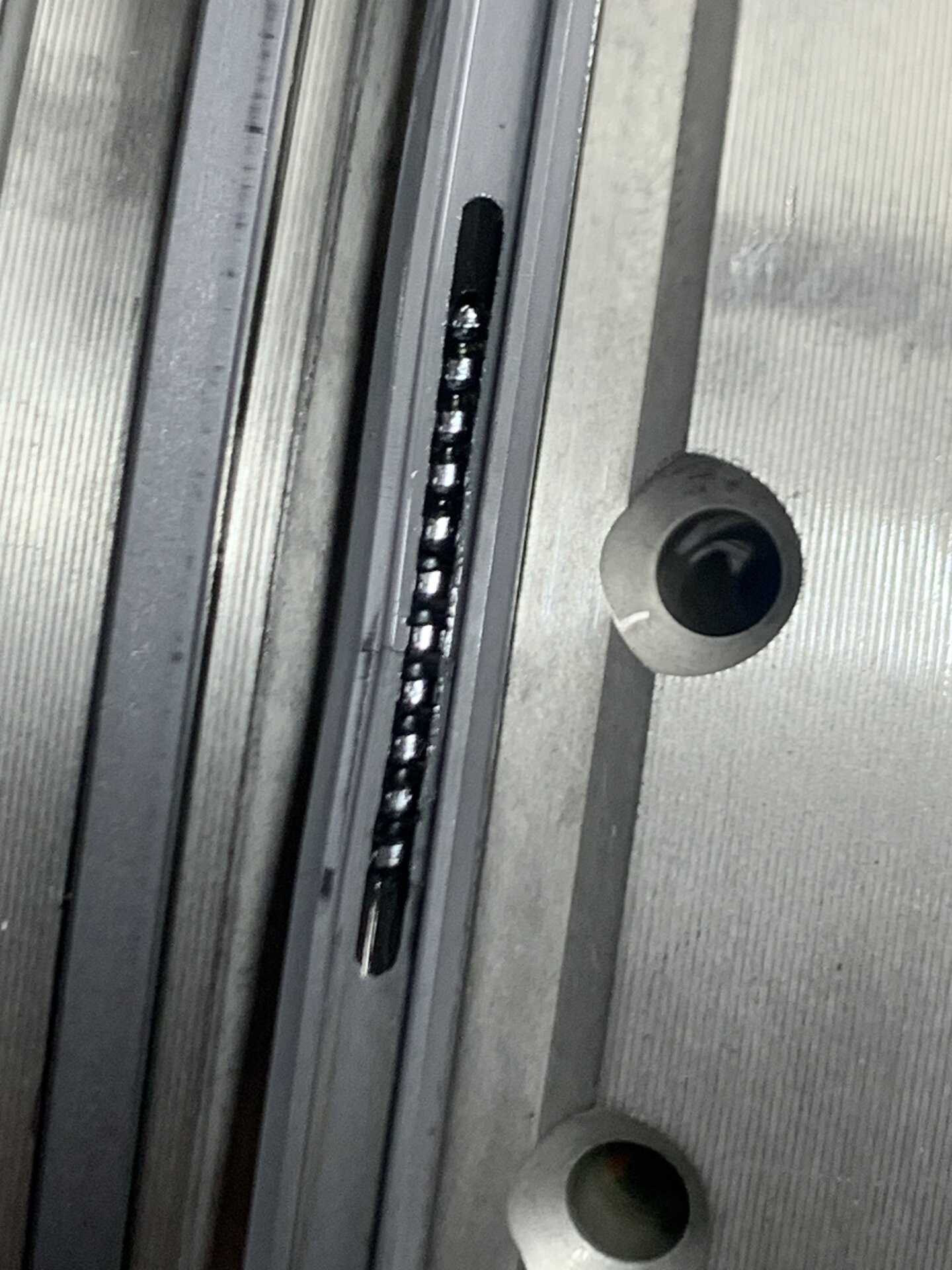

When I was doing the timing I noticed the at after hand cranking it around a bouncy there were scratches on the new bore 1 and 4.

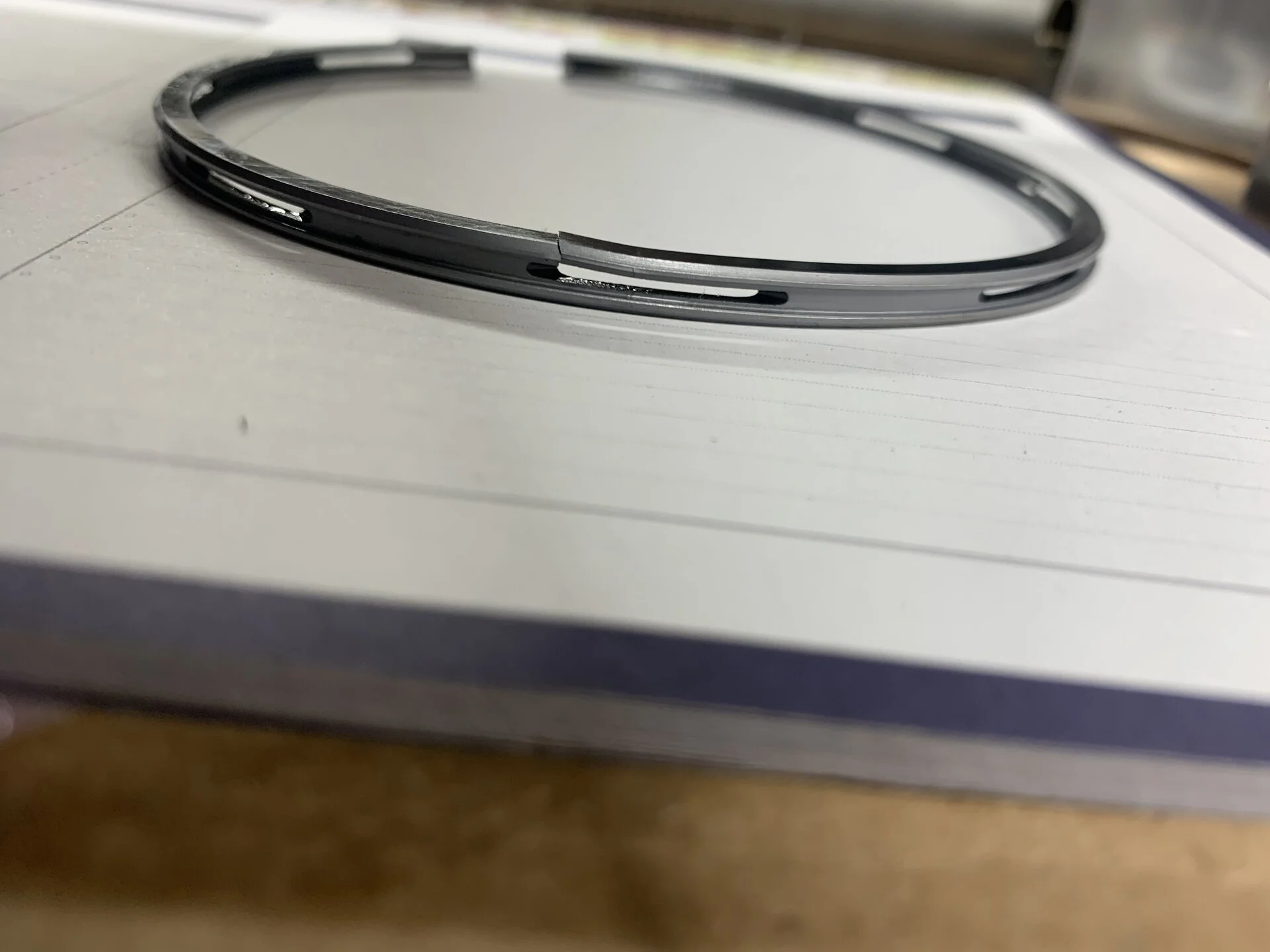

I took the piston out and found a crack oil ring
Well new rings and the new head is on this weekend it’s a bit hard working when it’s -18 even with the heater full blast
I hope to have the 40 on the road soon and ready for my summer trip to the island
Let me get this right, you paid for piston install and that cracked ring was on there?
