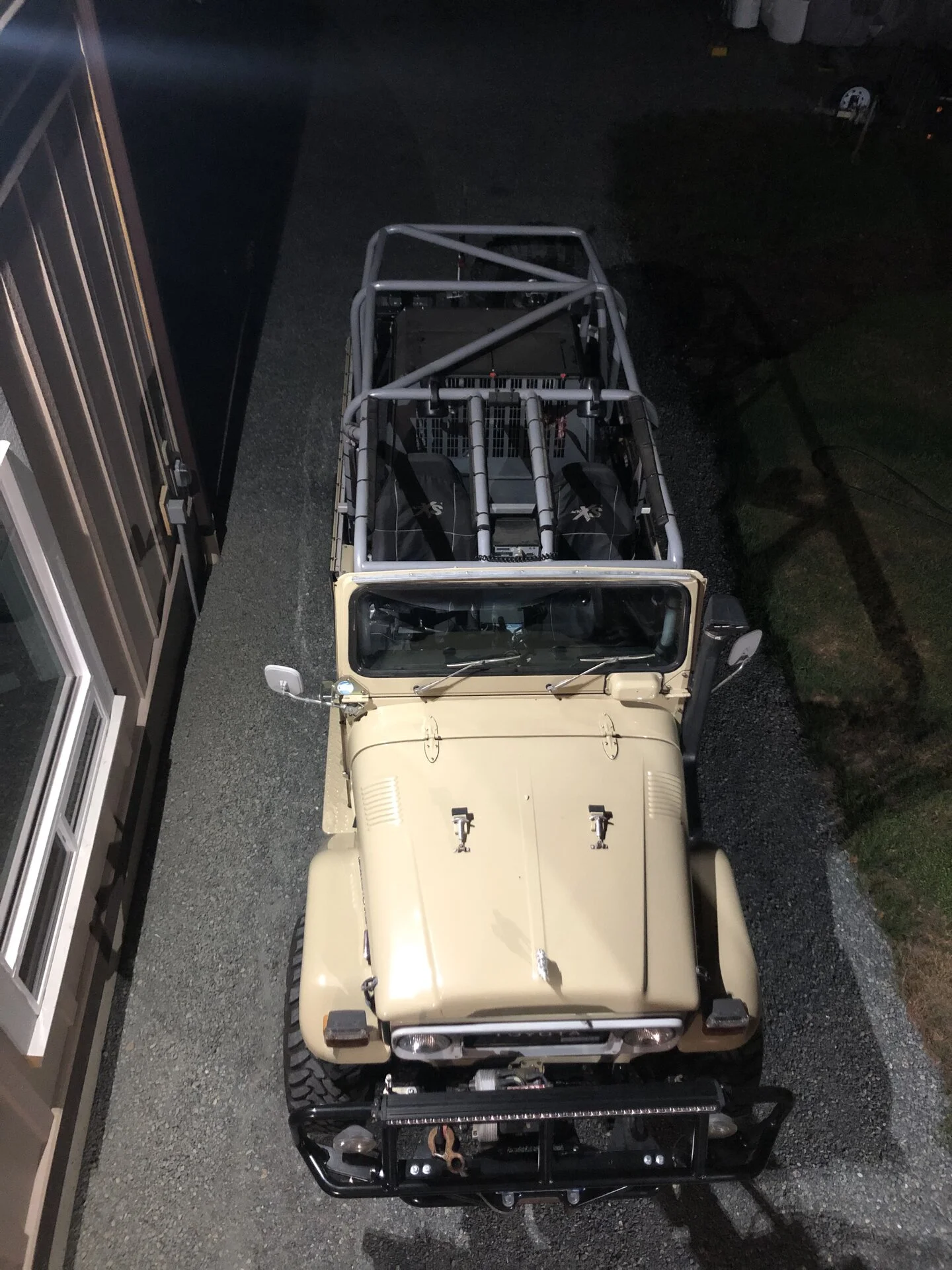

Top off… half doors on. Ready for winter
Wow! ^^^

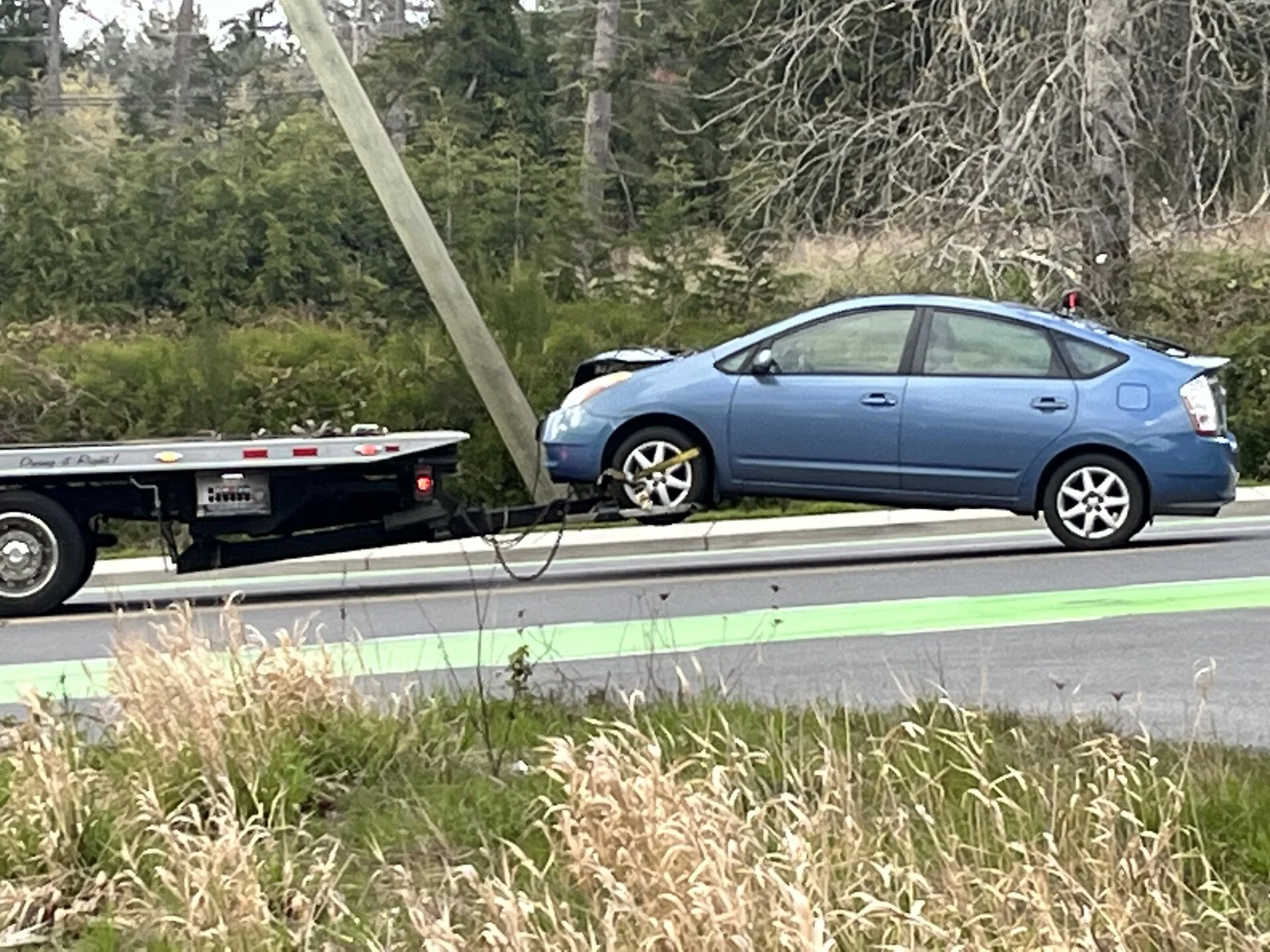

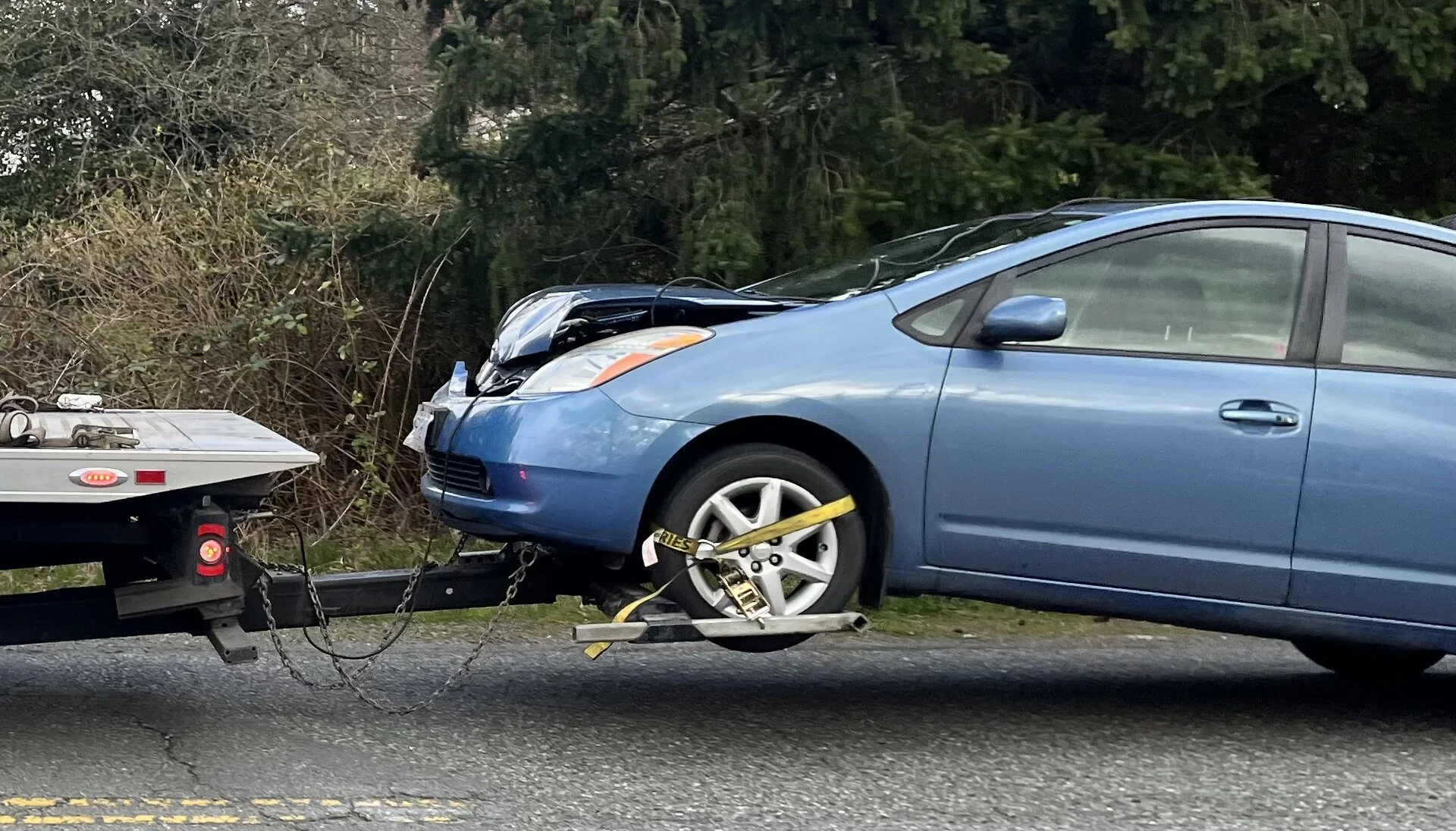

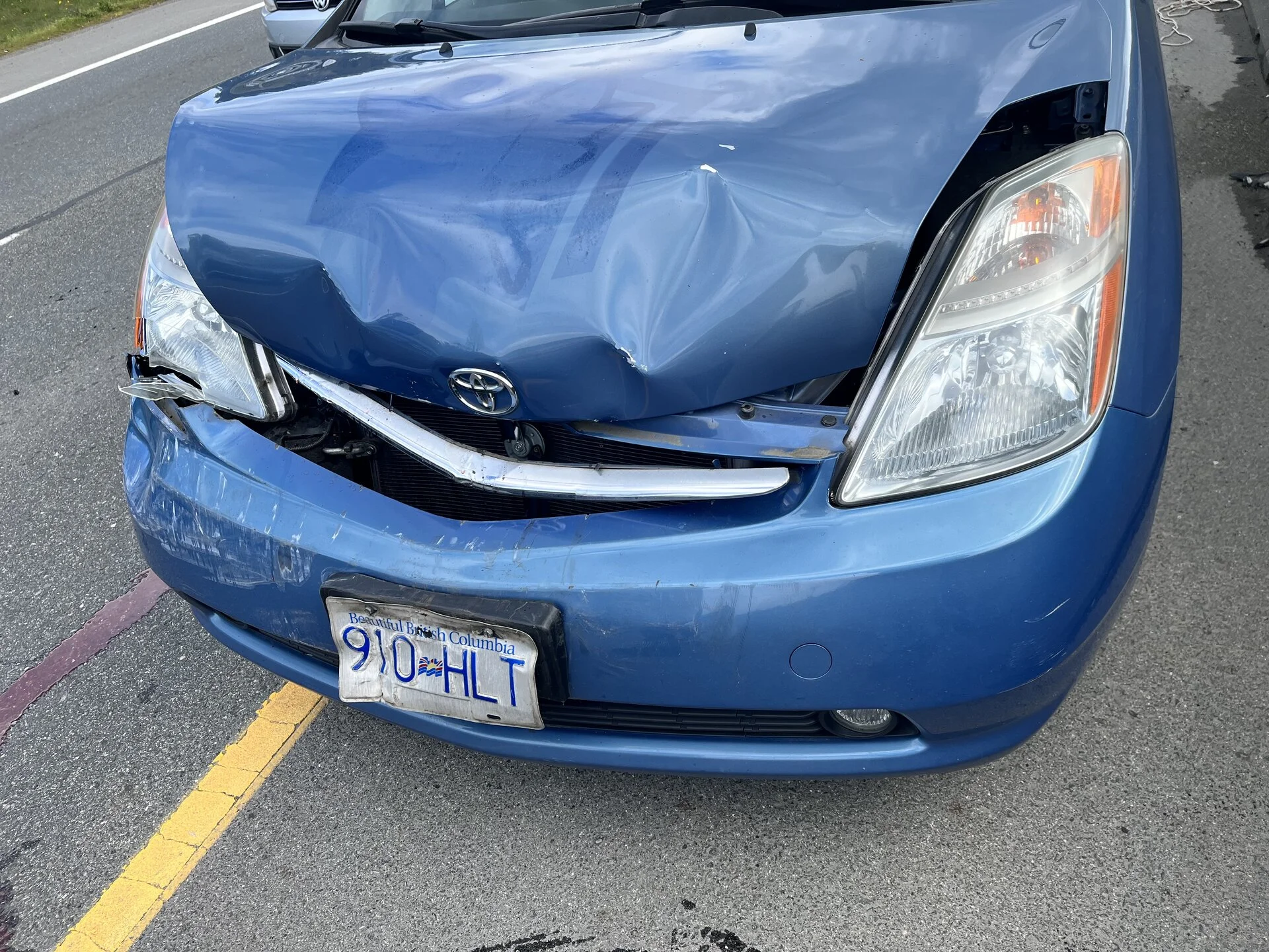

Car ahead of me stopped suddenly on a green light. Unfortunately I didn’t react quickly enough. Their bumper went over mine. Took out the hood, one headlight, and the radiator. I’m hoping ICBC doesn’t try to write it off. Bastards they are.
Well ICBC did write it off. After 3 weeks of arguing for someone to actually look at it they came back with $13k for repairs. So, I bought it back for about $2000, spent about $5300 on repairs. It still needs a mechanical inspection, wheel alignment, and to have the A/C recharged.
The bent hood.
Side view.

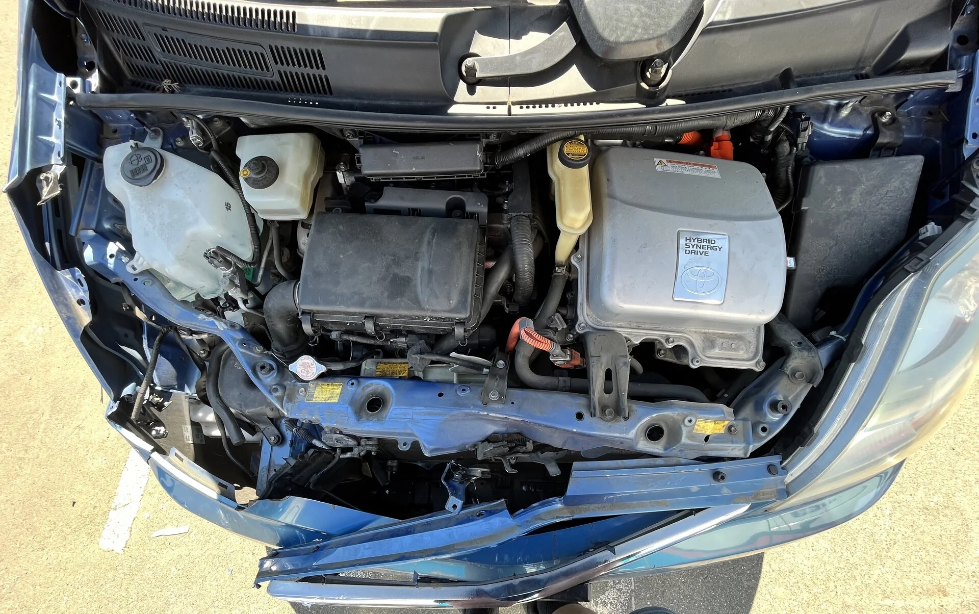

Damage under hood.

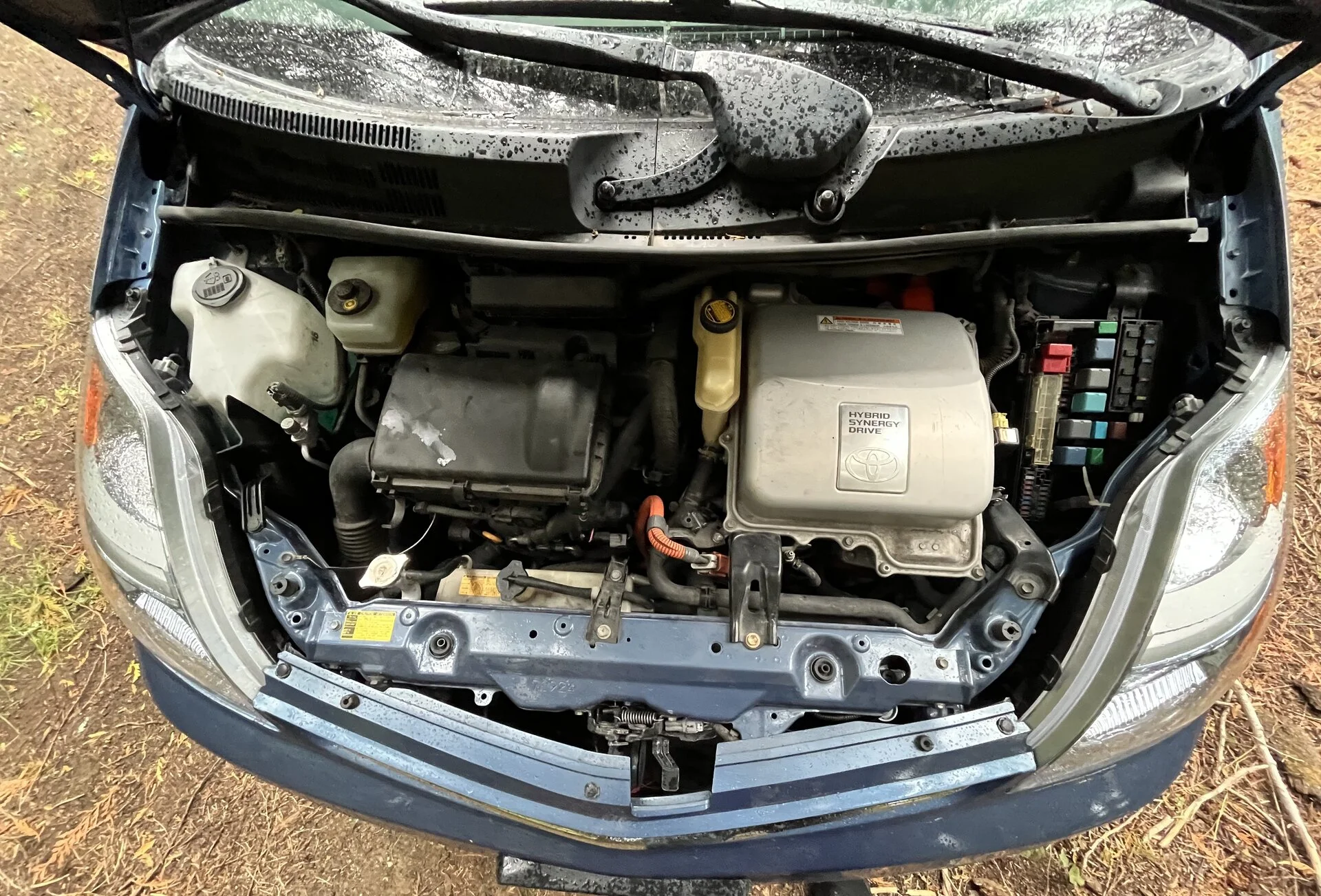

Back together with new parts and paint.
Driving & running… waiting for trip to Dumont tire for Mechanical and alignment. Then trip to Hub insurance to register it as a rebuilt and insure it.

The bent hood.
Side view.
Damage under hood.

Should be... It has new: headlights, bumper cover, grill emblem, radiator, A/C condenser, paint, bumper retention clips, throttle body.
"Recycled": Rad fan & reservoir, rad support & brackets, horn, hood, R fender, dip stick, hybrid coolant reservoir.
The biggest surprise was the Throttle body... $1100 + tax from Toyota and it would have to come from California. I checked Rock Auto... Aisin $389 - Better, Beck/Arnley $270 - but aftermarket right? I looked closely through their photos and could read TOYOTA on one of the pictures. I decided to order it for $330 including taxes and rush shipping. When I opened the Beck/Arnley box it said TOYOTA on 2 sides as well as Aisin on the casting. Works great again and for more than $800 off the Dealership part. Really $800+ more for the exact same part out of the same factory with even the same labels.
