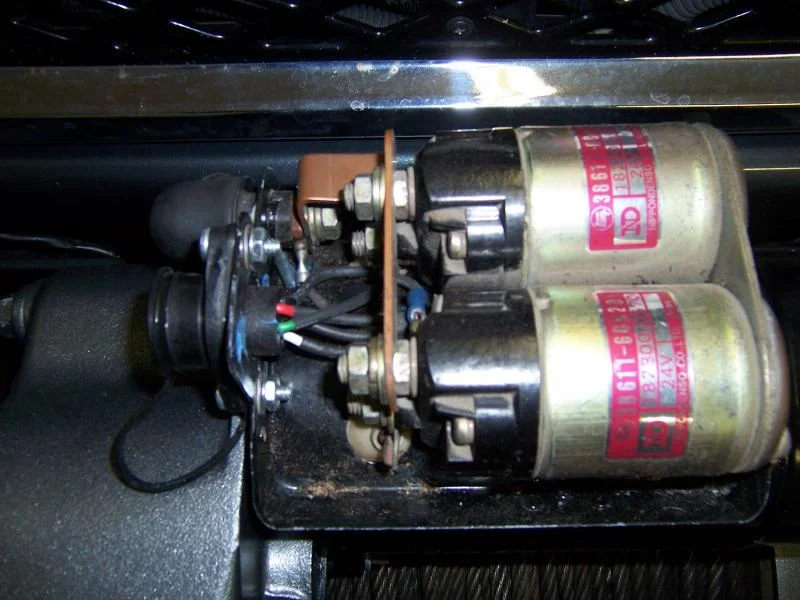

I know this is old material, but anybody could help me out. Im trying to source the part numbers for these 2 solenoids? These are 24v. I looked at the EPC but there are no internals to the winch.
Im trying to convert a 12v winch to 24v, already have the motor, missing these solenoids
Thanks in advance!
100_1815-jpg.328788
Well, thats exactly what Im after. I do not have the 24 volts part number, I want to know the 24v part number as I am missing the solenoids. The electric motor I already have in 24v. Thank you!
Thanks a lot Bjowett,
No, Im not set on Denso, whatever works well, Im good with it. Any ideas where to find Albrights in 24 volts? Your help is much much appreciated!!
