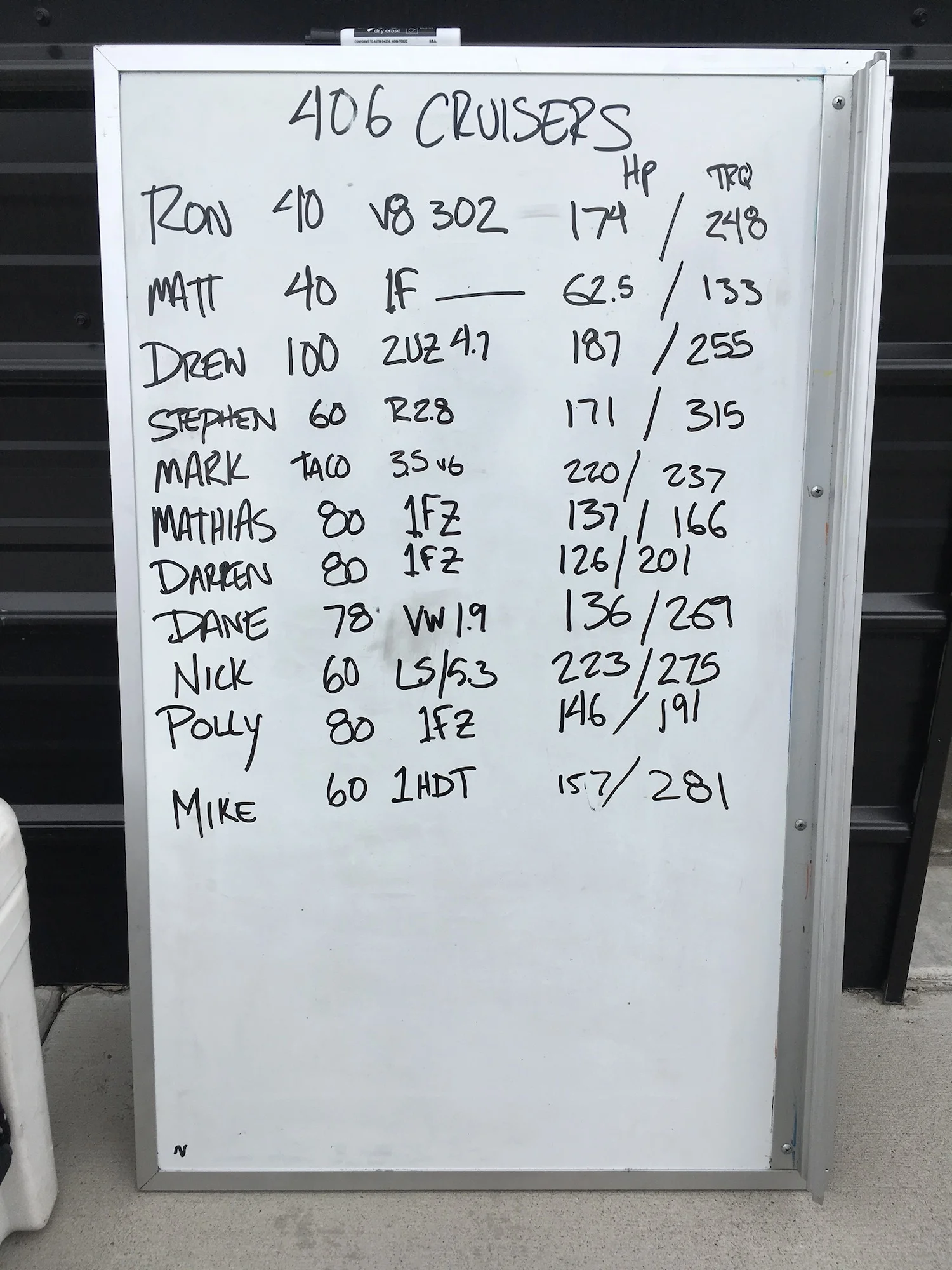

A stock 1HD-T is a fairly good match for a 1FZ, a mildly tuned one is way better IMO. Just for giggles, here are the results from some dyno runs on a bunch of Cruisers. Check out the difference between the three 1FZ's and the 1HD-T. All engines were in stock form.

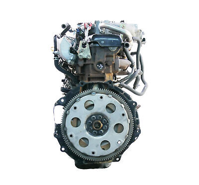

Also, if you're looking for an easy swap I would not recommend the engine in the eBay link you posted. That one is a 1HD-FTE, which means it is an electronically controlled diesel that will require a full engine harness and ECU to run. You'll be much better off finding a 1HD-T or 1HD-FT.
Nice! Looks like way more torque in the diesel. I'm surprised to see some of those low hp numbers for the fz. I wonder what my 3fe has on the Dyno.
