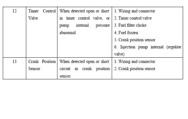

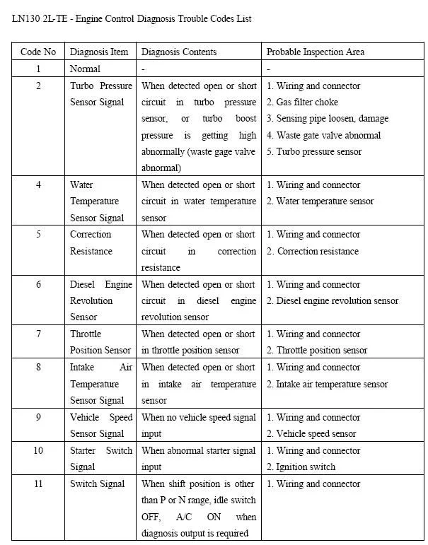

Hi everyone,
I'm new to the forum. I have a 1991 Toyota Prado 2LTE motor imported from Japan. We've been having trouble starting it when it's cold. We got it scanned and it came up with some error codes but I can't find out what those error codes stand for. The error codes are either 8, 12, and 13 or it's 8.12 and 8.13. Help!

Codes and Other Stuff
I have all of the codes, but am attempting to post them... they are in .pdf format which the site does not allow.
I'll see if I can convert the document to something else. Bear with me...
Max
Nov 27, 2007
52
British Columbia, Canada
Hope this helps and is legible...
:cheers:
Max

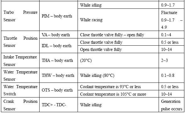

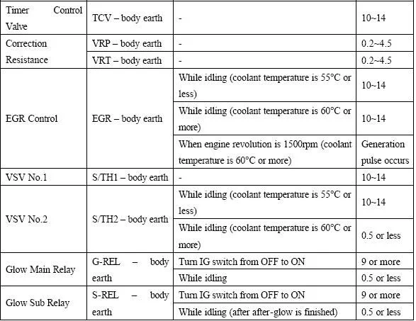

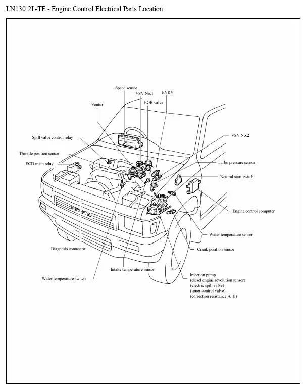

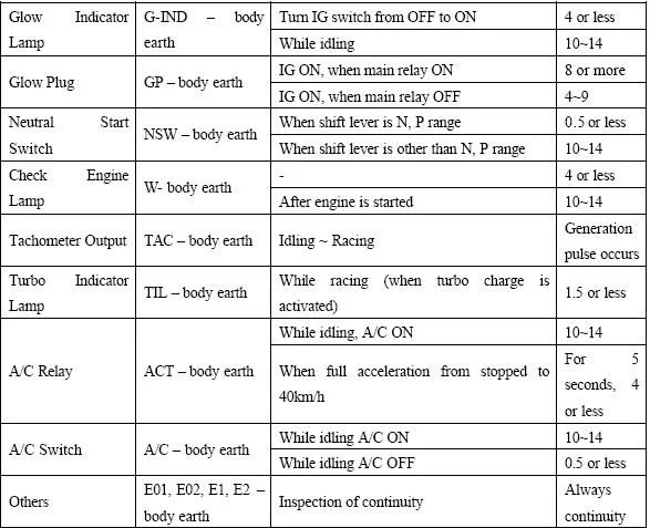

Some more info that may be of use...
Here is some more information that I've accumulated. The pictures aren't great because I've had to scale them down to post them but I can email them to you on request:
Nov 27, 2007
52

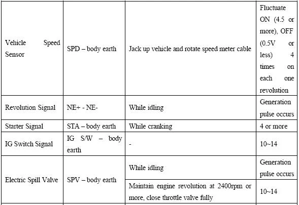

... and the last of the pinout info.
There seems to be a real lack of information on the 2L-TE here in North America, so I'm trying to collect / share what I can.
