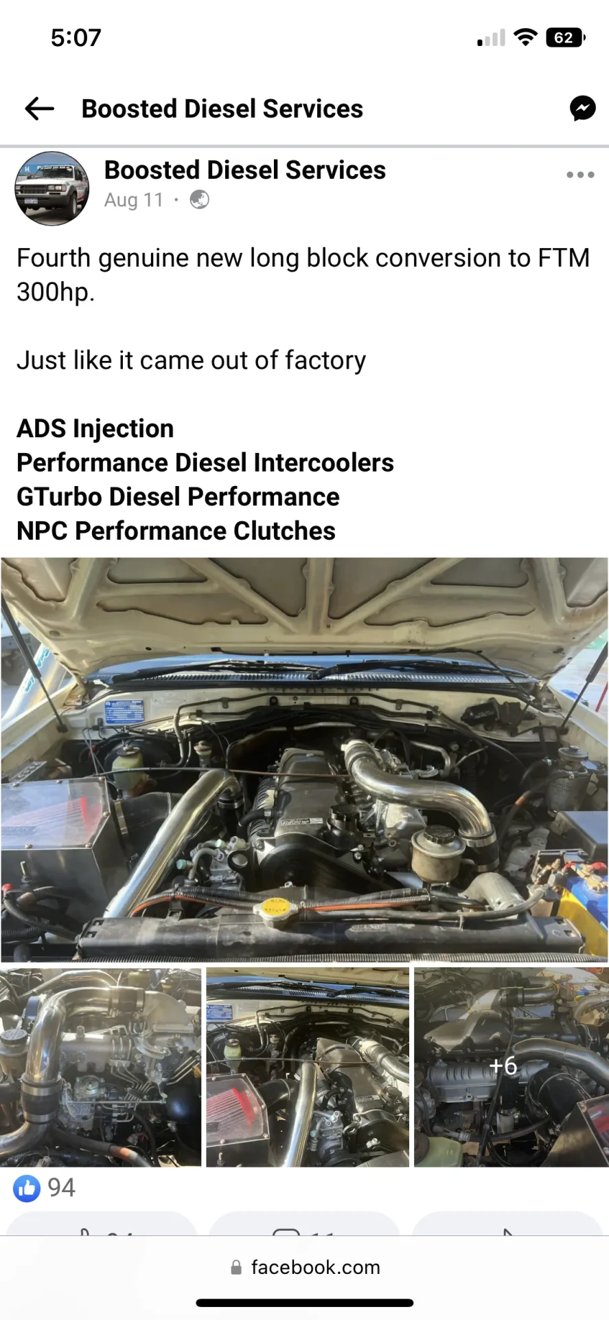

Boosted Diesel Services in Western Australia has done them… (on Facebook).

Pretty sure FTM is for FT Mechanical
