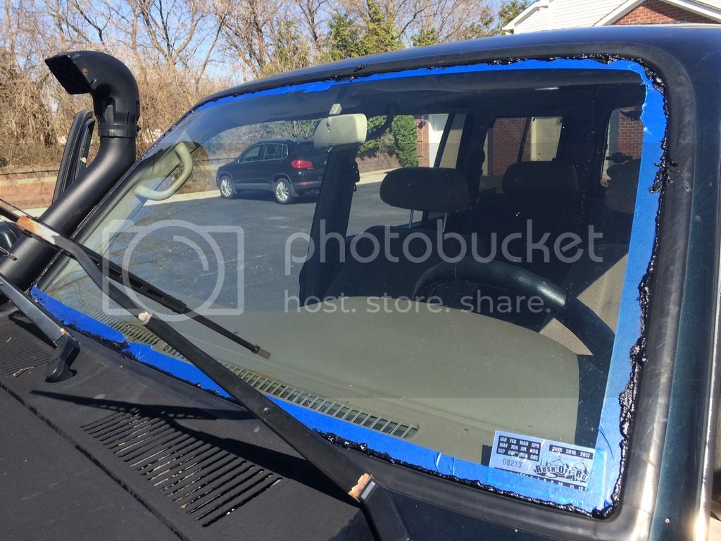

Since today's weather was nice I decided to clean the truck and perform some other maintenance items while I was at it. I repainted the sliders and the bedliner on the side of the truck. I also replaced the torn door speakers and most importantly, sealed my windshield so that it hopefully no longer leaks. Only time will tell.

Sealed up with polyurethane roof sealant
