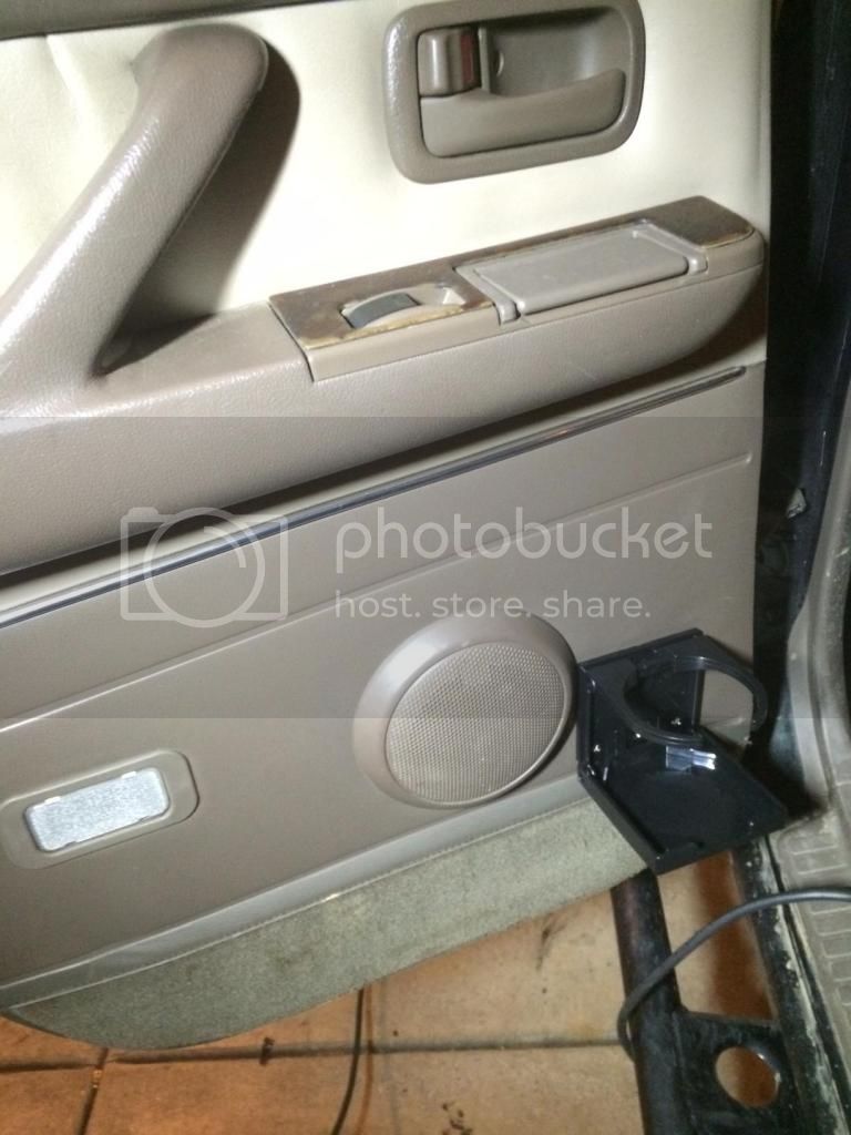

I was bored today so I decided to remedy the lack of cup holders in the back of the truck. I went and got some marine fold up cup holders at Bass Pro.

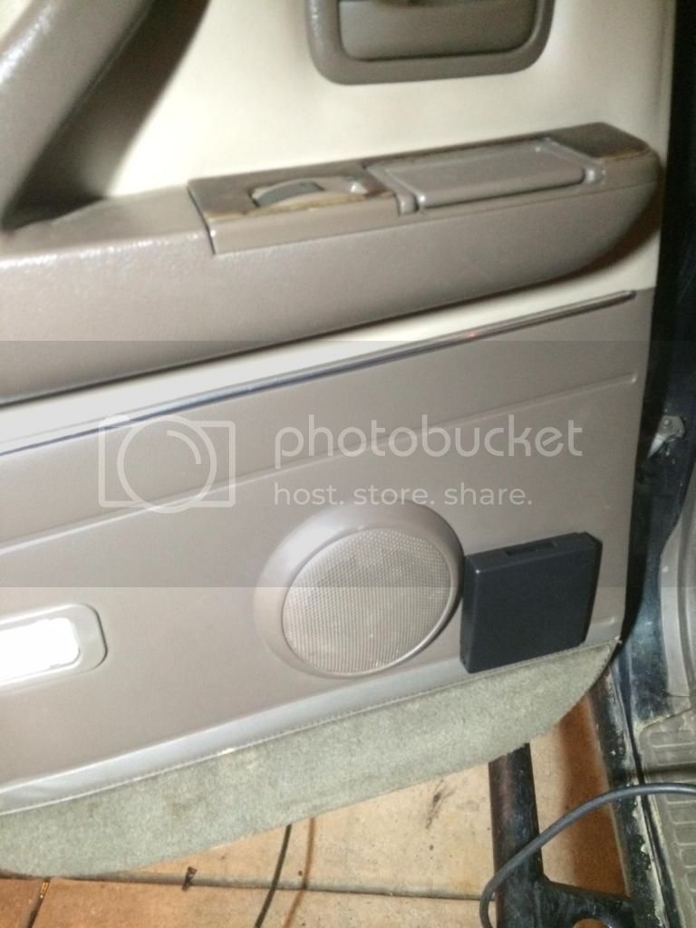

Today I went to the local junkyard with a friend of mine to help him find a new mirror for his carolla when I stumbled upon a wrecked diamond in the rough, an 80! I went up to the poor thing (missing it's engine and front frame looked like it had been in a bad crash) and saw that the interior was immaculate, so I decided to update my interior. haha. Someone had already taken the front seats so I just took the door panels. I think they look much better than my original ones that were rough and torn up from years of abuse. Also go a new tail light to replace one that a tree damaged. Was a good day at the junkyard.
my old panel is on the right

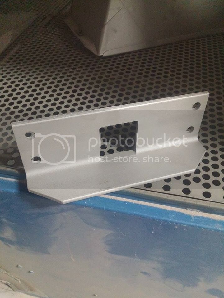

I've also started work on my integrated hitch. I bought some 2.5" box steel and 4"x3" angle and handed them off to a friend who is a professional welder and has access to a shop. He's currently fabing it up and sent me some pics. The next hurdle for me it to figure out how to get bolts all the way through the rear crossmember. I'm not sure if I should sleeve them either. I'll cross that bridge when I get there.
All the hitch needs now are the chain holes, the pin hole, and some paint. Almost done!

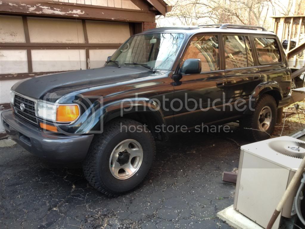

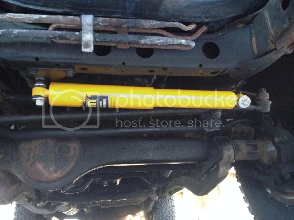

so here's a quick update. My favorite tires were on sale so I got myself a set of 33" BFG AT/S! :bounce: They look good and should perform well. I got the black walls because their side walls are 2 plies thicker than the white letter version. I also threw my new steering damper on to help with the larger tires :steer: . It put up a bit of a fight getting the old damper off, but a tie rod fork did the trick. I've got my TJM 2" lift springs and am just waiting on the shocks and bushings so I can install the lift. Hopefully they get to me before May. On a different note, does anyone know of someplace to get the CDL switch for less than $100? thanks
