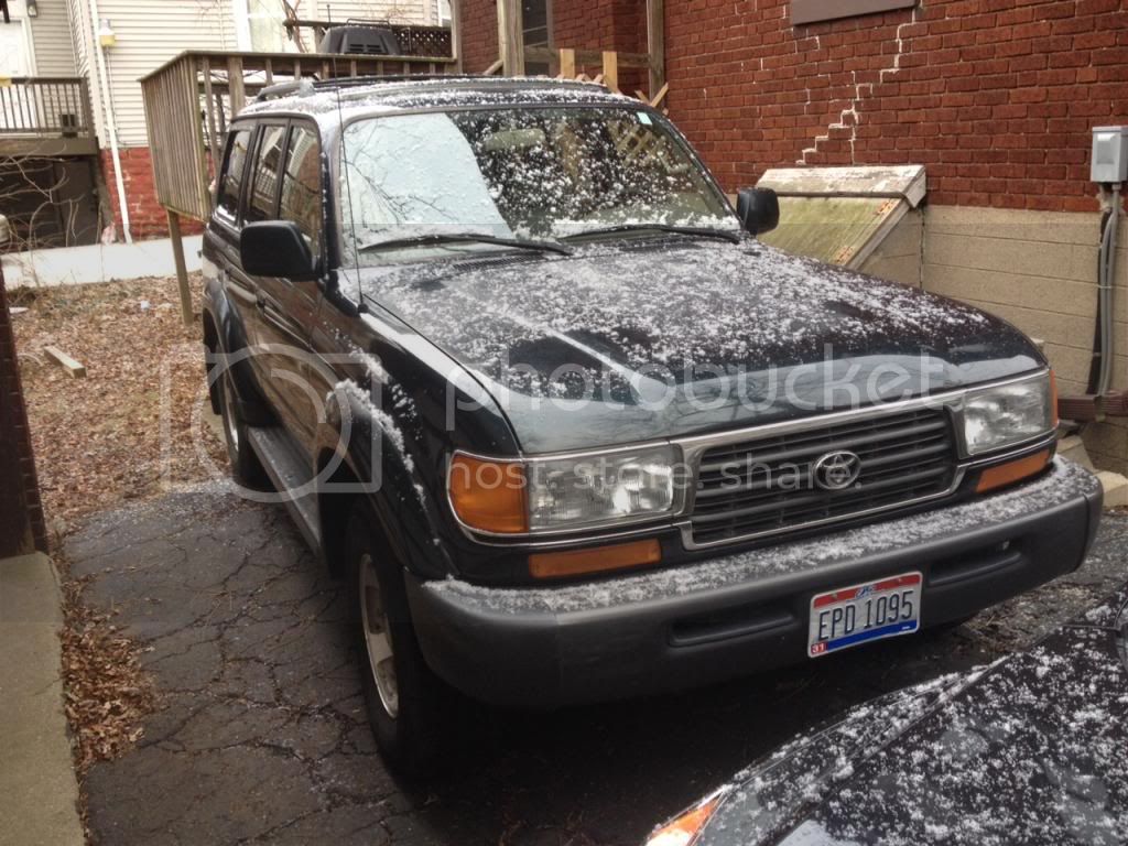

So I'm new to this site and the Land Cruiser community and I thought I'd go ahead and start a build thread. I have a 97 FZJ-80 with the factory locking differentials. It has a few minor bugs but nothing big. I'm planning on making it into my daily driver / mild exploration and trail rig.

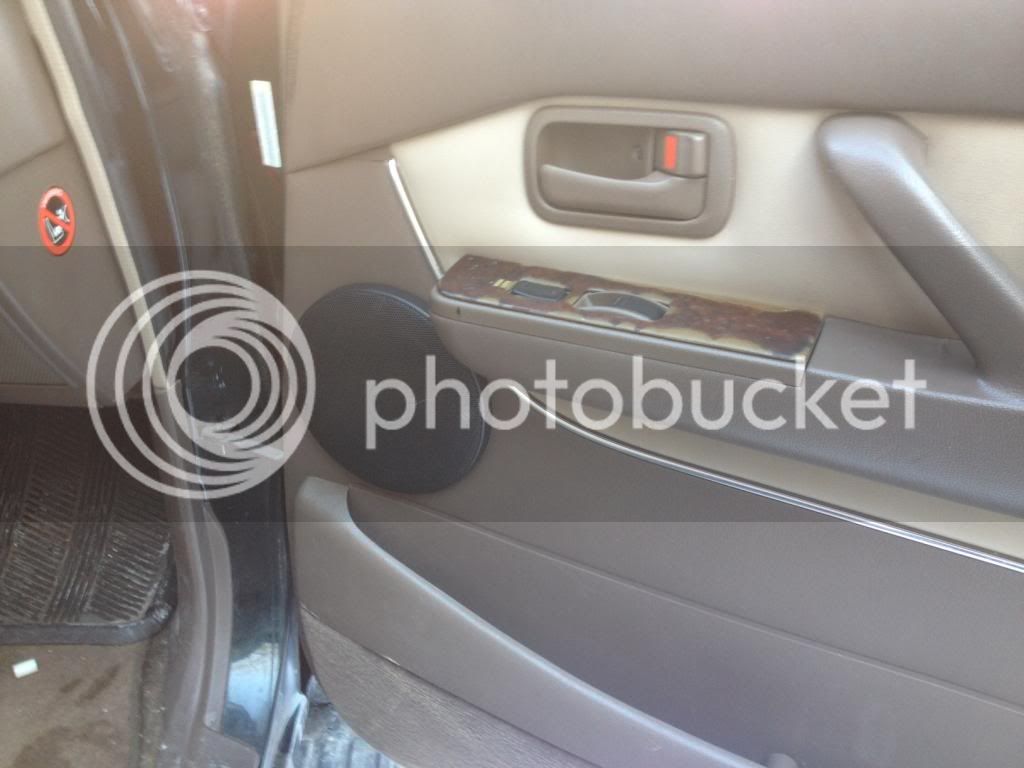

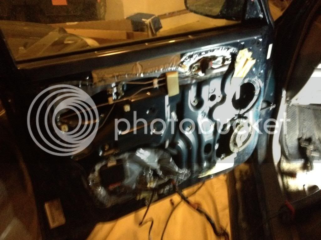

Once my tax refund comes in, I'll get wrenching.:bounce: I've already replaced the door speakers with 5.25" RetroSound shallow mount speakers. they sound great and there was little modifications needed for the door panel. Next will probably be a head unit for the stereo (it's a DD after all). Anyway, this should be a fun build and I can't wait to get going on it. :steer:

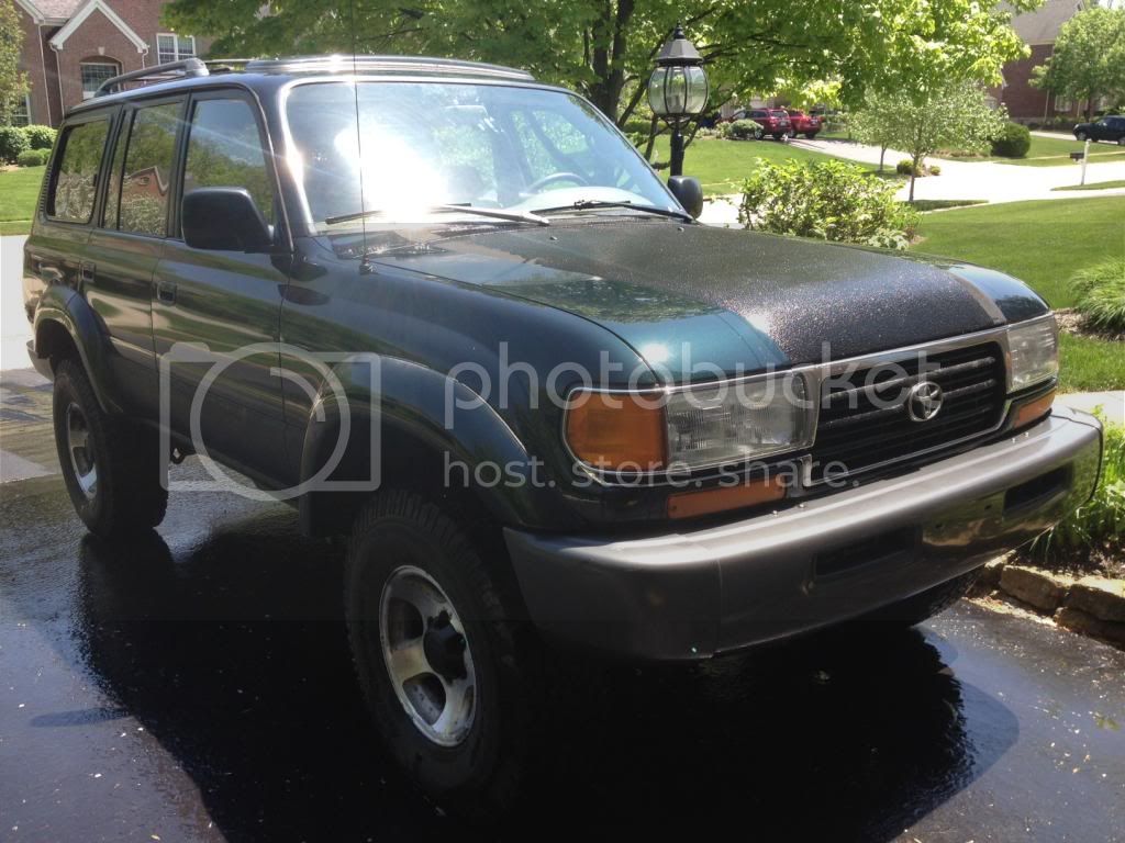

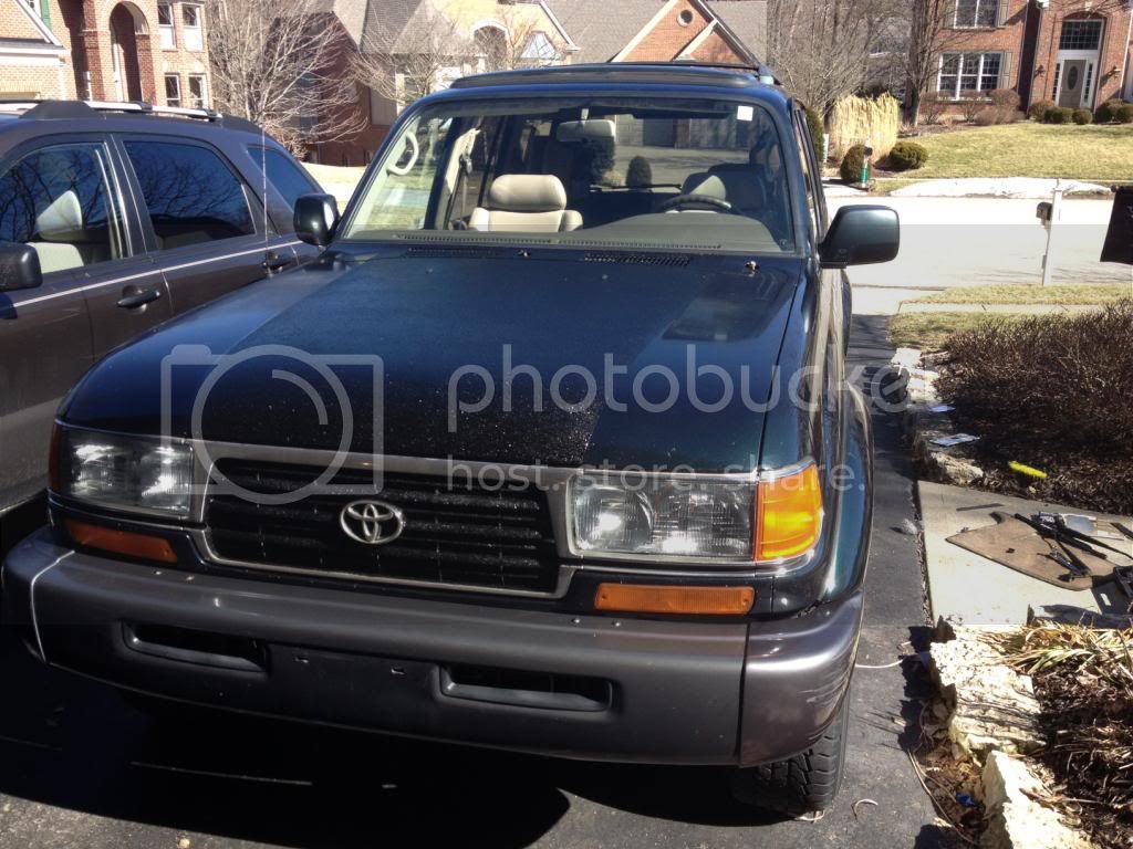

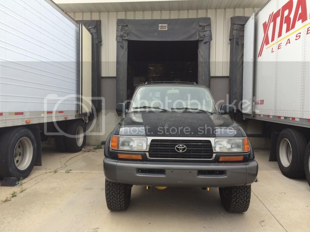

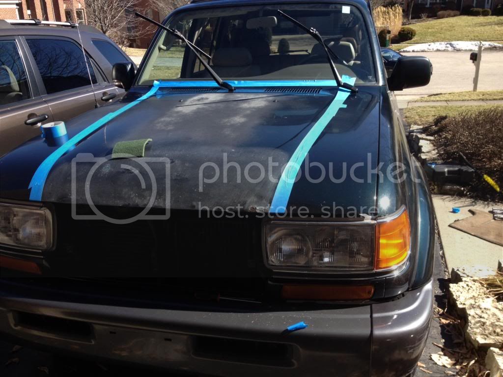

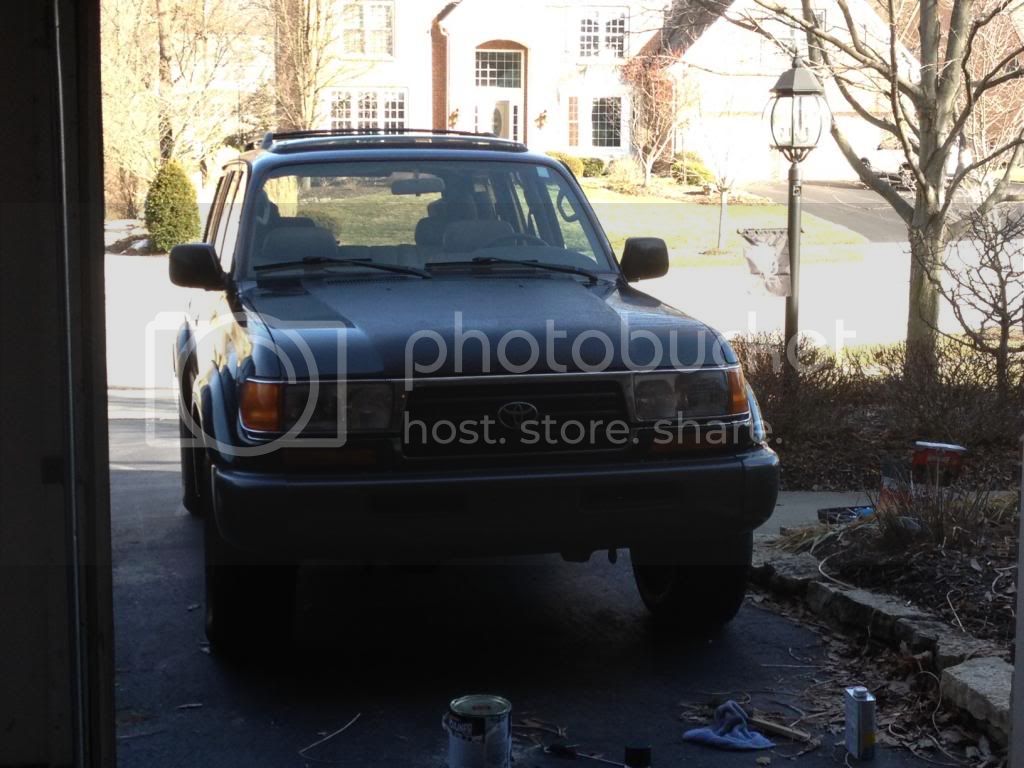

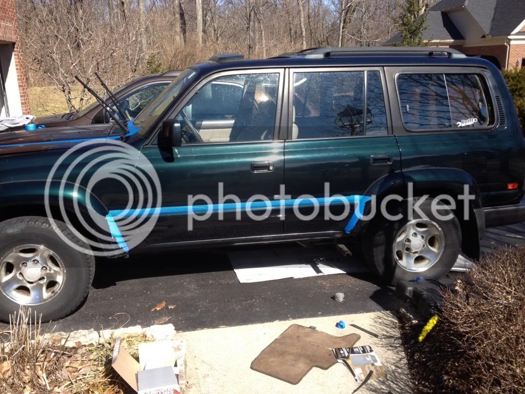

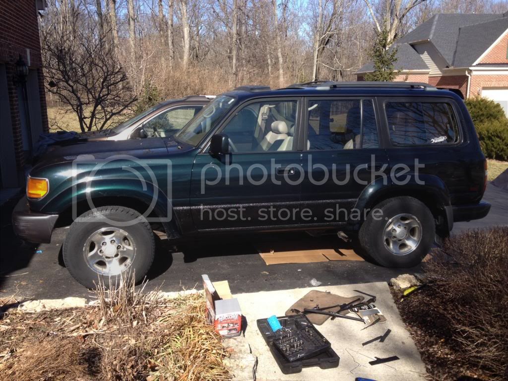

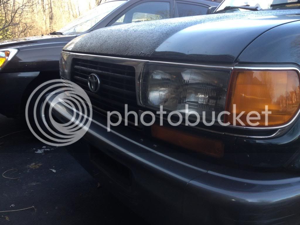

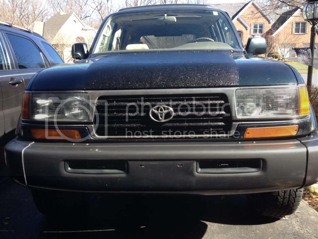

The weather today was fantastic so I took full advantage of it. I removed the God awful running boards and mud flaps. Then the big project, I put roll on bed liner on the rockers and the hood. Partially for durability, partially to cover up a lack of clear coat on the hood. I painted the grille to match the hood. I also replaced the windshield washer valve and fixed the hood latch while I was at it. All in all, it was a good day and I think it all turned out nice. On to the pics!

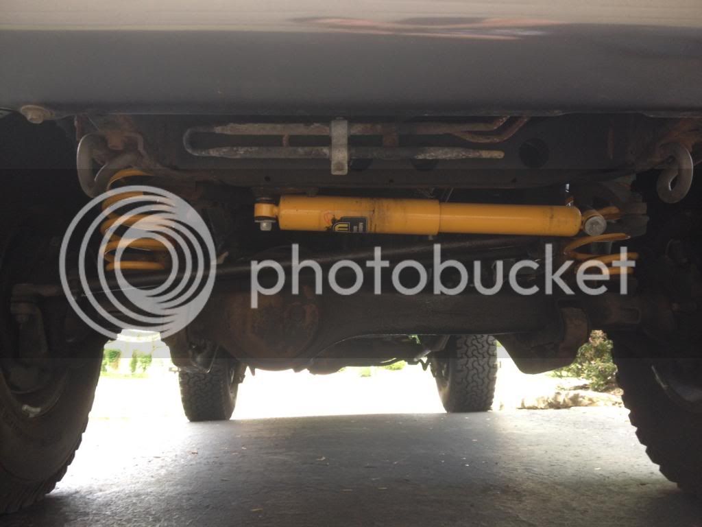

so here's a quick update. My favorite tires were on sale so I got myself a set of 33" BFG AT/S! :bounce: They look good and should perform well. I got the black walls because their side walls are 2 plies thicker than the white letter version. I also threw my new steering damper on to help with the larger tires :steer: . It put up a bit of a fight getting the old damper off, but a tie rod fork did the trick. I've got my TJM 2" lift springs and am just waiting on the shocks and bushings so I can install the lift. Hopefully they get to me before May. On a different note, does anyone know of someplace to get the CDL switch for less than $100? thanks

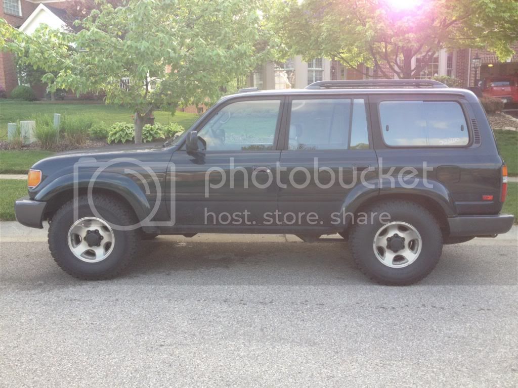

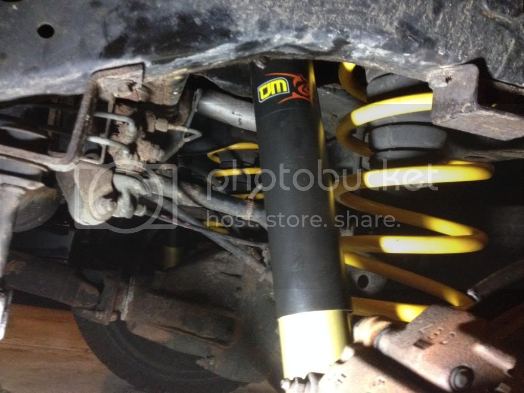

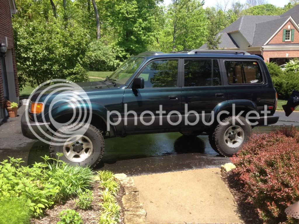

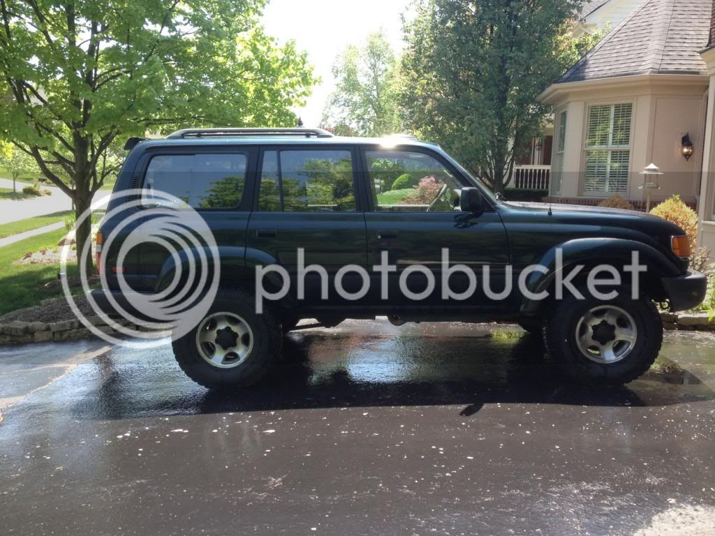

Hey all. My shocks finally came in this weekend so I threw on the lift! It took me about 9 hours to do and went off without a hitch. nothing broke, no bolts were too stubborn (torches are my friend), and the truck didn't fall on my so it was a good install. I put the 2" TJM kit with their Tiger 9 way adjustable shocks. From the first rides today, it feels much better. Much less body roll and squishiness, and it looks good too.
Next on the list are some sliders and then a roof rack with spots for my hi-lift jack and spare tire.
Before:
rear end:
Front:
After:

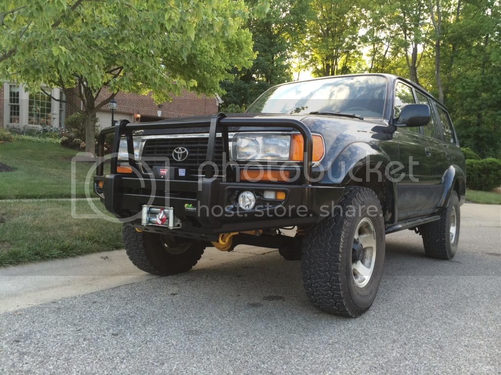

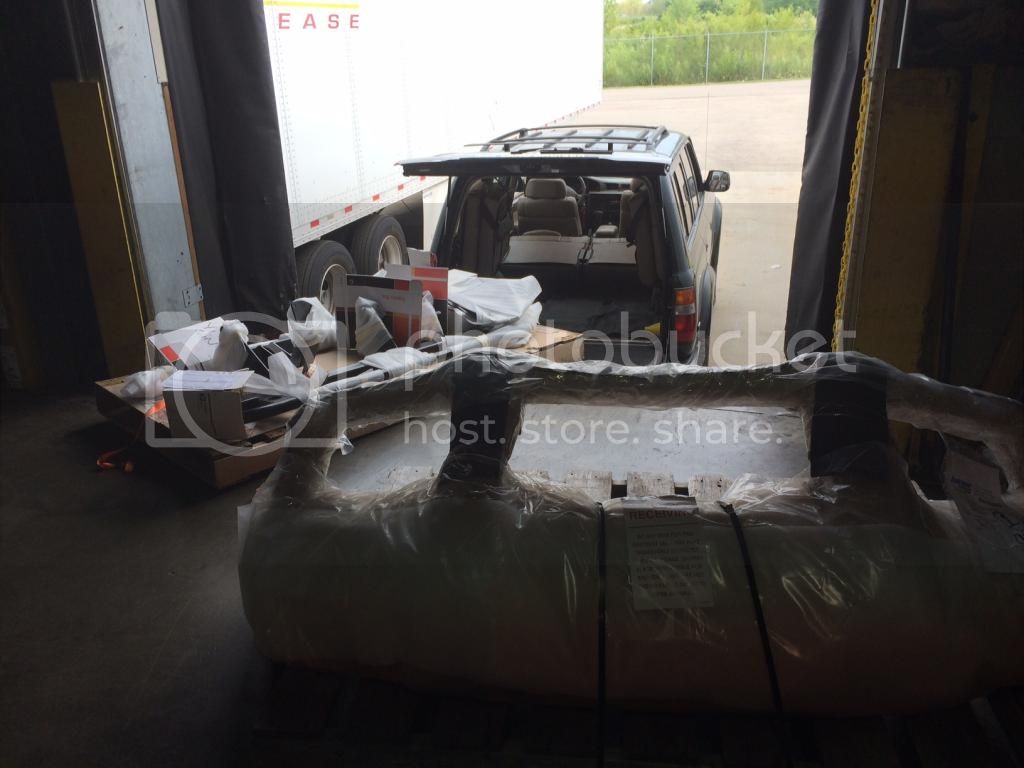

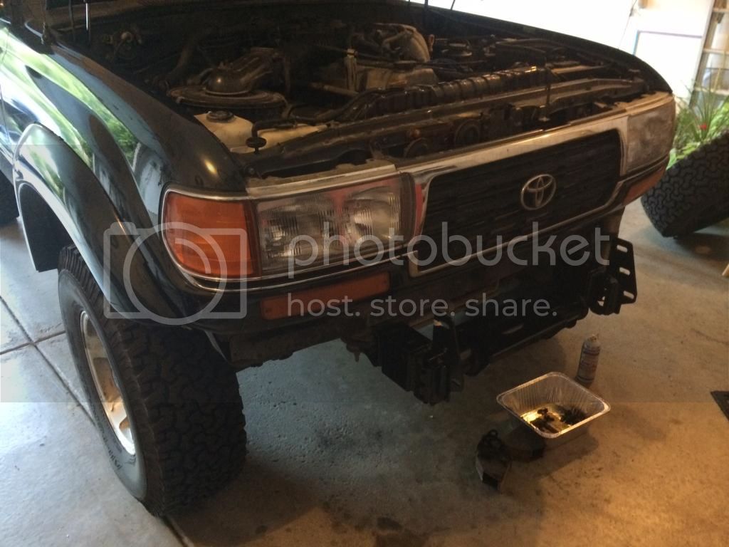

Hey all. Today the toyota got that much closer to being a tank! I threw on my new front bumper (Ironman 4x4) and 10,000lb winch as well as some sliders. I also installed stainless steel brake hoses. The truck thoroughly kicked my butt. Moving that much metal takes it out of you. I'm happy with the end result. I hope to take it out to a local off road park in the next two weeks.

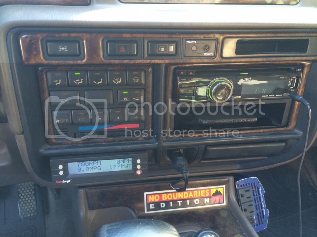

So a little update, I threw some man-a-fre spacers on the springs to add an extra 30mm because I figured why not. I also have stainless brake hoses with the frame to axle hoses being 3" longer than stock for extra clearance. I also did the heater bypass, replaced the PHH, and installed a scan gauge to better monitor engine temps.

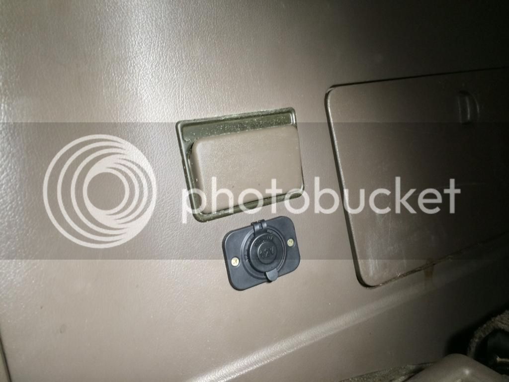

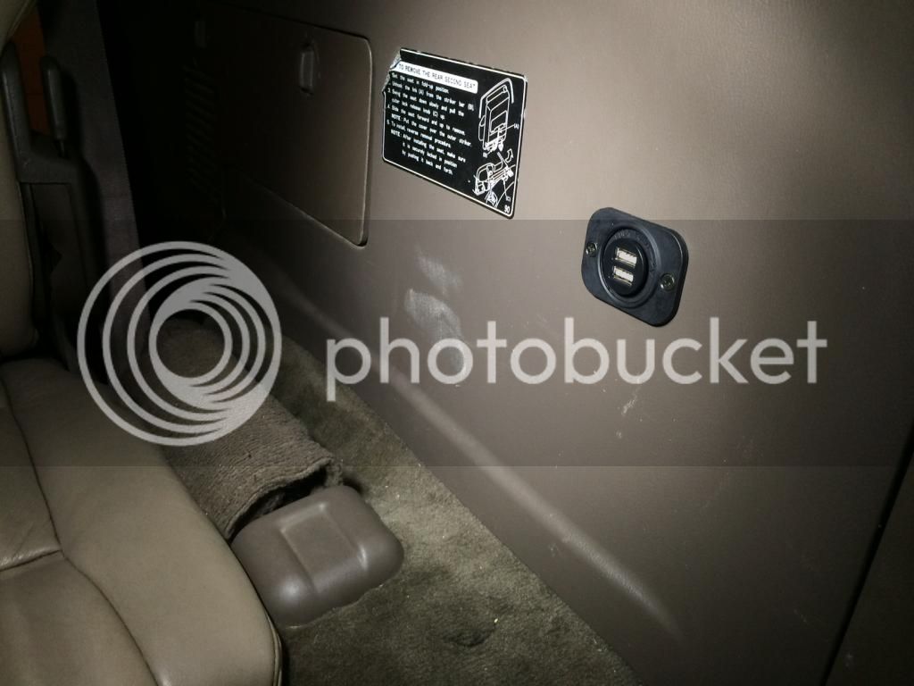

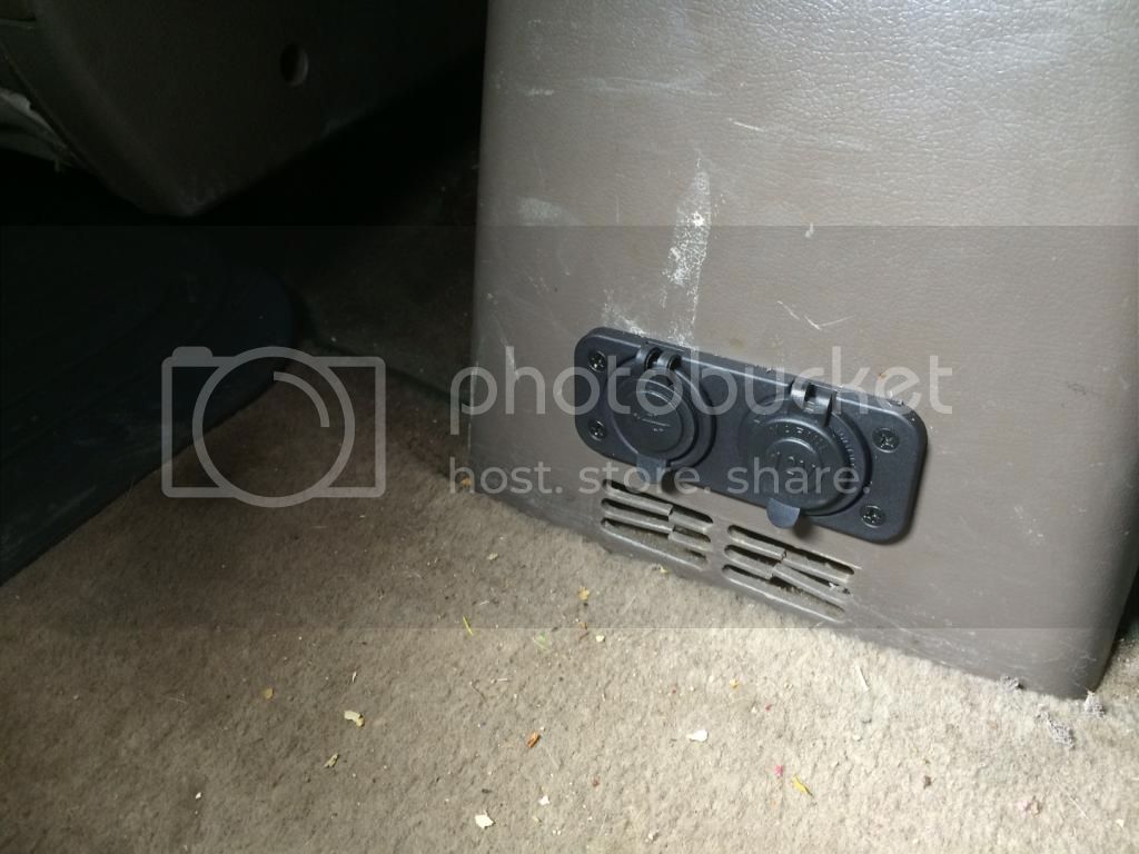

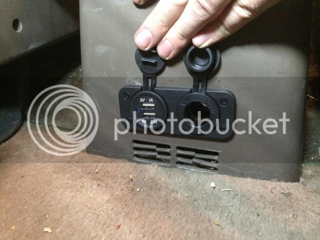

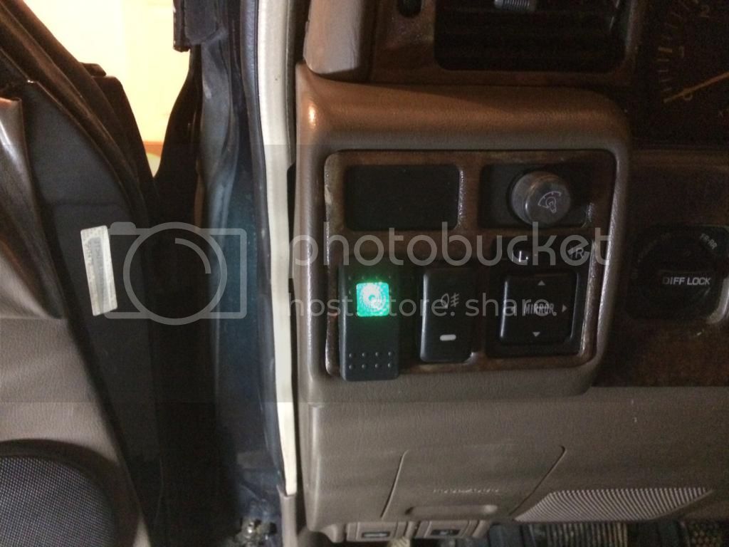

So I'm going out to Colorado soon with a bunch of people for a road trip and we're taking the beast. I decided to solve the problem of no 12v outlets in the back. I have them controlled from a switch in the front on the dash.
I think they look like they should've been there all along.
DixieDog,
Yeah It's a toyota part. I got it from cruiserparts.net. I called them and they were really helpful. It was a piece of cake to install since all I had to do was feed it through the dash and attach it to the gas pedal.

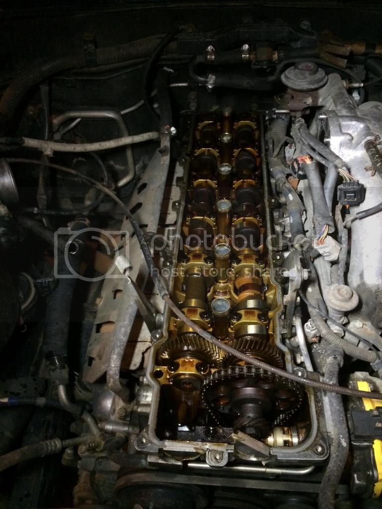

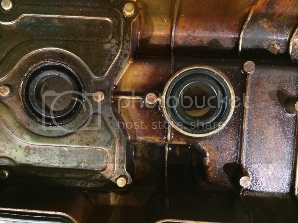

So today I had the time to finally replace the valve cover seal on the engine. It was leaking quite a bit from the back. There was enough oil that the back of the engine and a lot of the transmission was covered in oil. When I unbolted the valve cover, I was surprised that the bolts in the back weren't even hand tight anymore. Once the cover was off, one of the tube seals shattered so I had to replace that as well. The valve cover seal was also very brittle. I had to chisel it out of the cover and it broke apart in spall pieces. I was glad to see that the engine looked pretty good for its age. There was a little build up, but no sludge and it was very mild. The worst was the throttle body. It was so bad that after I cleaned it up and reinstalled it, the engine was running at 1500rpm! I unplugged the ECU and EFI fuses and relays and reset the computer and that fixed it. Luckily, everything went went with the seal replacement.
