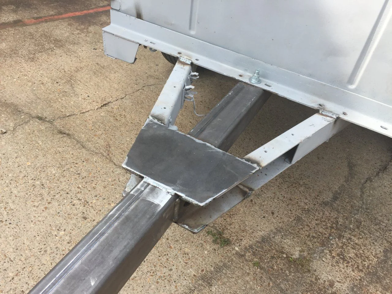

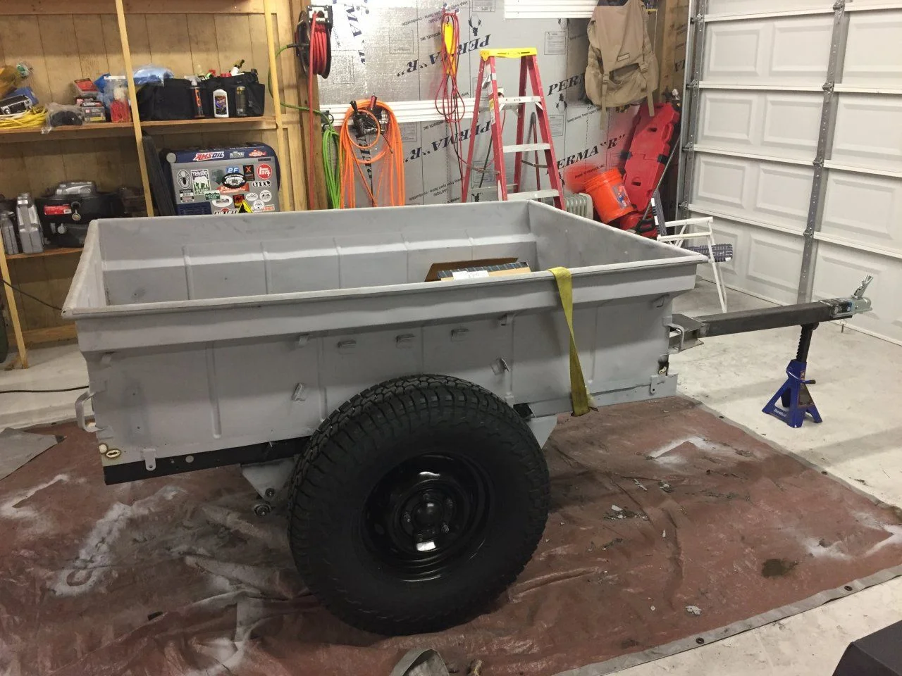

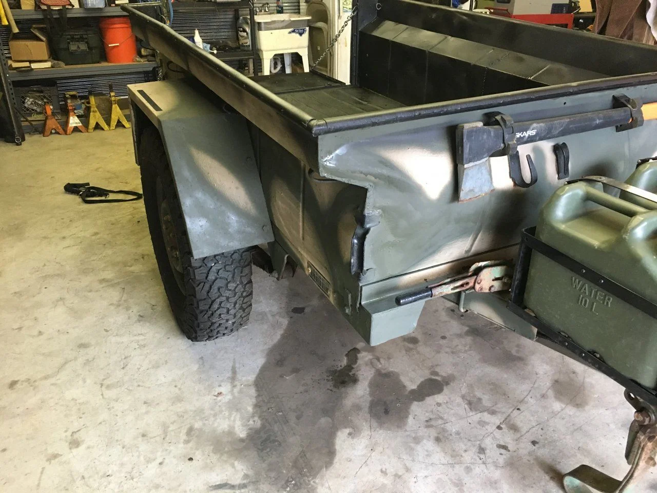

More progress today. Floor and some bracing is in. New tires are on.
Looks awesome.

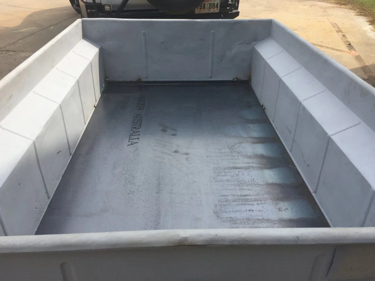

You said something in a text today about it rattling with the new floor. What's the story with that? I am sure it had some type of rubber body pad in there OEM huh? I can look at mine.
Yeah. The new floor is heavier and slaps loud on the frame over a bump. No shocks on it right now but still won't like to hear that. I'm thinking I'm gonna bolt it to the frame in two places. Will take care of any play.
My poor M416 has been sitting outside most of the summer and it's looking like poo.

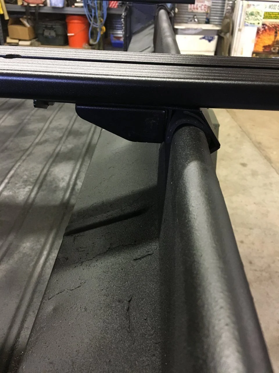

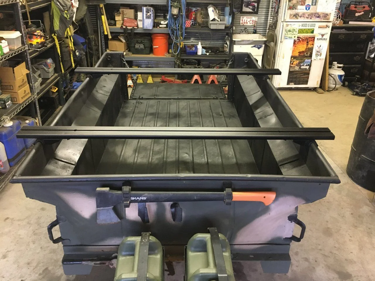

I also got longer FrontRunner crossbars that I needed to install.

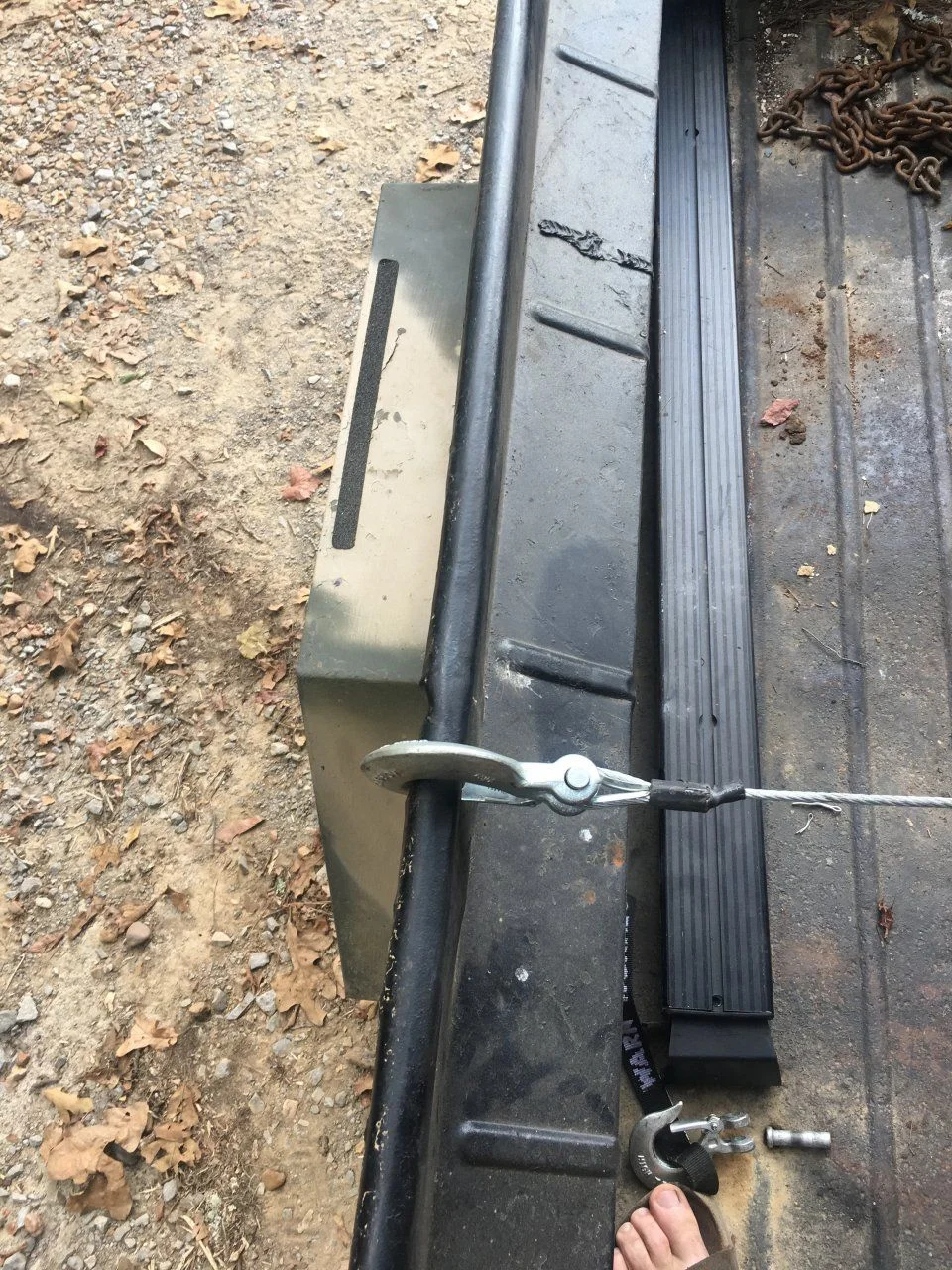

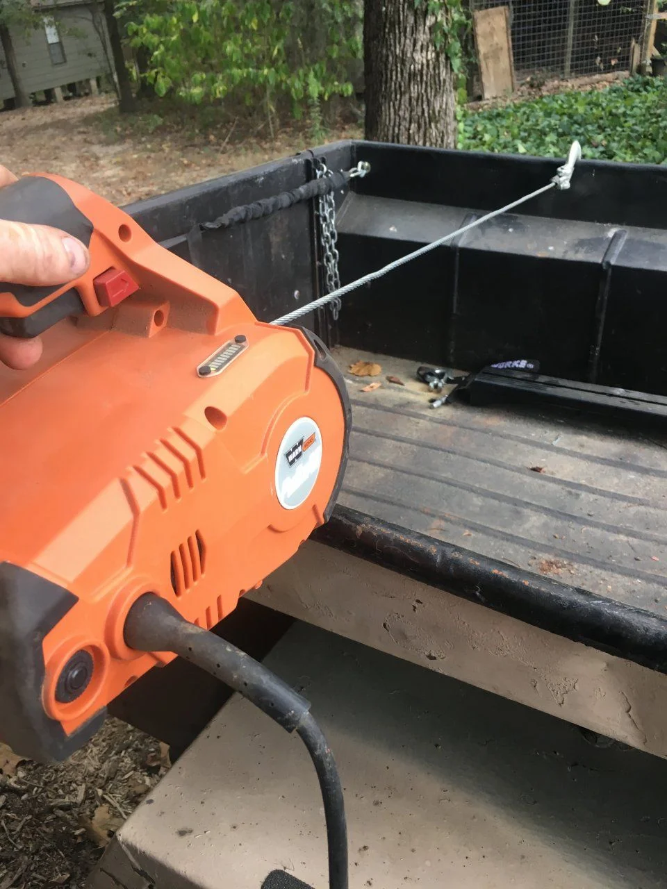

My siderails are rough and bent but today I decided to fix them. The little Warn took care. I had to sammich it against a tree.

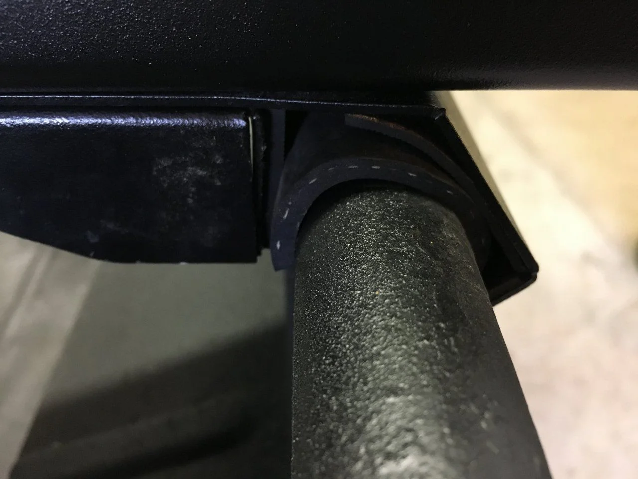

The first FrontRunner load bars were too short. I will use them on my 4Runner when I use the Thule box

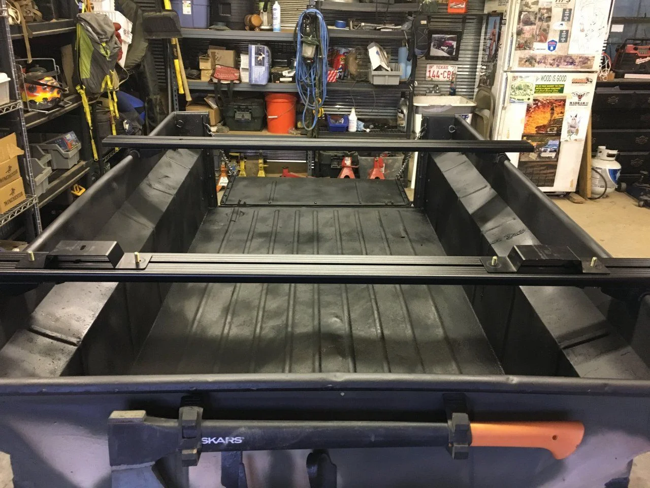

These clamps are designed for factory racks that are thicker than the M416 tube. The last time I installed I decided I needed more tube there.
The answer was 3/4" rubber hose split and placed under the grip. It really firmed it up
